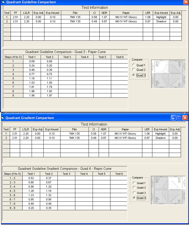

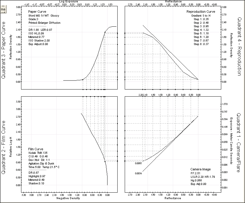

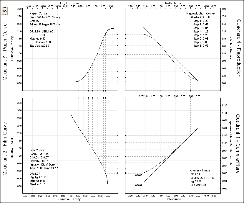

I've done a quick comparison between a negative with a CI of 0.58 matching the paper LER and a negative with a CI of 0.49 and matched to the paper LER. This only illustrates how the values will fall and does not address aesthetics. There are two tone reproduction diagrams showing the tests and two tables showing the resulting print densities in Quad 3 and the resulting gradients in the tone reproduction curve in Quad 4. In the tables, Test 1 is the Normal CI 0.58 test and Test 2 is the reduced CI and higher grade test. Comparing the gradients in the second table as seen in Quadrant 4 will illustrate the changes in local contrast between the two tests. It appears that test two has increased contrast in the midtones at the expense of contrast in the highlights.
Interesting Stephen, thanks!
My personal experience bears out what Stephen's tests show. I often designate a negative for less development and printing on a higher grade paper to expand local and mid-tone contrast.
Now that we have more than opinion on the subject (thanks to Stephen taking the time for us all), it seems to me that the argument has been put to rest.

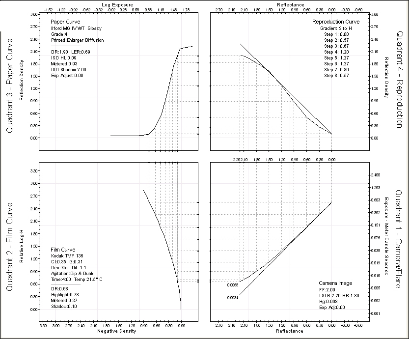

Here's an example with the same materials. Film CI 0.35 for a NDR of 0.68, Paper LER 0.69. Looks like increased contrast into the upper part of the shadow area. For a print to look correct the reproduction curve needs to fall below the reference curve. The closer it is to the reference curve, the darker the tones appear compared to the original subject.
Thanks Stephen,
I was beginning to think, most of the curve is from Paper because film has more-or-less a straight line (unless you take advantage of the long toe of some films).
