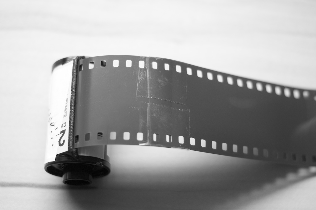

I'm a slow shooter and usually repackage a roll in multiple shorter rolls. Of course, by doing so, I'm wasting a lot of film for leader.
How could I attach an (expired) piece of film to use it as a reusable leader to reduce the waste?

Probably hard to do, you need a camera that doesnt use the sprockets or would not mind the film jumping the sprockets from tape covering them or misalignment with two pieces of film. There are a few cameras such as the canon elan that can use film without perforations.

Maybe you could do something like what's done to splice movie film. The film pieces are held in place in a device makng sure the perforations are spaced properly and film cement is used to glue the pieces together. Prior to that the emulsion is scraped off one piece of film (as the lap join is one emulsion surface to one film base surface). Do a search for splicing movie film. The film cement works as a solvent as well as a glue, and I think I'm right in saying that it would work only on acetate films which are soluble in whatever solvent is used.
You might even pick up a 35mm movie splicer.
I'm not sure I'd bother, but I'm lazy.
Edit: since the 35mm film has identical sprocket holes on both sides (unlike most movie film) you wouldn't have to scrape emulsion, just join base to base.

I use EOS, so sprocket holes are no problem. Maybe the counter could get confused, but that's it.
I could make the connection by overlapping sprocket holes of the leader and the roll. Leader is just leader, so the quality of joint is not critical - it just needs to be reliable. I'd use a sellotape, but not sure it'll hold. I guess I need to try.

Anyway, the solution is simple and it works:
