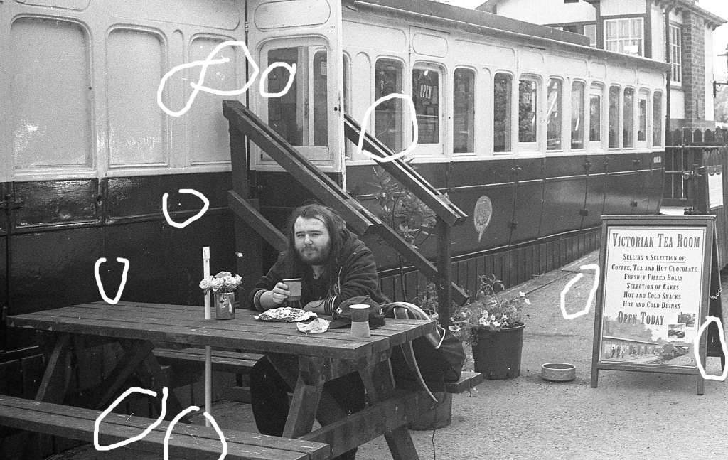

I think I am contaminating the film before developing,, or is it me

I know this is a bit of a radical idea, but you could always try just following the manufacturers' instructions and see how your film turns out.
Thanks
dust and scratches won't be eliminated by a prewash, and if the spots are not dust then the chances are you have crap in your developer, fix or wash water. or all three. or you have dust and hair on your scanner.
if you start with "I've got unwanted marks on my film" rather than "is a prewash necessary?" you'll get better answers!
Your question will almost certainly be answered that It's you
And you are very close to being right with "film to digital step", but I'd bet on "the drying stage" too, (anyway prewash is out of the question then)

The picture you posted is too small to show enough detail to identify the marks clearly. However, to avoid chemical debris and drying marks in general...
a) always filter solutions before use when they were mixed from powder or when they have been re-used. This can be achieved by placing some cotton-wool in a funnel spout and allowing a funnel-full of water through it to get rid of any loose fibres, before filtering the chemical. Wash the funnel and renew the cotton-wool for each chemical.
b) After processing and washing, allow a final few minutes soak in distilled water with a tiny amount of photographic wetting-agent in it. Dry the film without any further wash/rinse and avoid using a squeegee on it. Drying can be done conveniently in a shower stall or bathroom. Run some hot water first, to create steam in the air which then helps reduce the amount of dust particles floating in the room.
