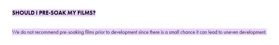

Infact what Ilford states on ilford.com is as below, consistent to the fact that the wetting agent is there for a reason, to aid evenness of development.
