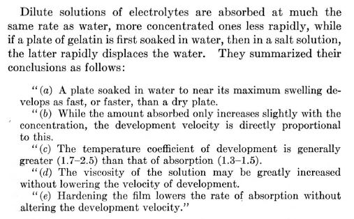

EDIT: perhaps a review of the photographic journals would yield such a study. The keywords might be "kinetics of development" as absorption rate of developer was discussed quite a while ago - 1890's by Hurter and Driffield and others. Their interchange in the journals probably rivaled the discussions of today's forums! Here's an extracted summary of one such study, by Shepard and Mees, about that same time, addressing the issue for thick emulsions on glass plates. The difference, though, was basically deemed negligable.
