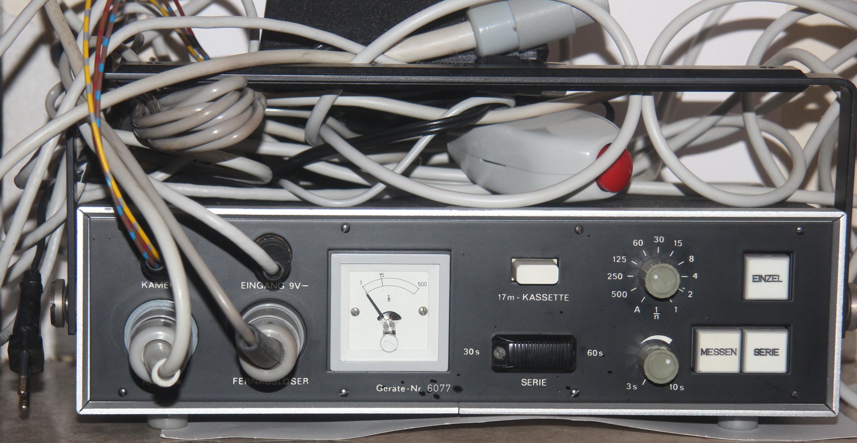

Before we reveal the camera one last part, the control unit. With lots of cables. I actually managed to plug all of these in the right sockets and the whole thing seems to be working, only I don't know how yet. Have to read the manual first.
attachment.php
That exposure time indicator is great.
That 17m switch would be to indicate the alternate use of plain back and longfilm back I guess.
I assume that 3-10sec control sets the intervall between exposures in series mode.

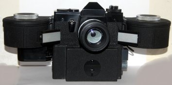

And finally the camera. You guessed it right AGX, it is the infamous SR899 GSK (Geräuscharme Kamera). The "low-noise" camera used by the STASI, the former East-German Secret Service.
Technical details : http://www.praktica-collector.de/197X_Praktica_SR899.htm
It was on my collector's list, then I found this rather complete one (the databack is missing) for a not unreasonable price so I bought it as my own Christmas gift. It's the only present I got. :sad:
It uses a 17m film magazine (450 pictures) but it should work with a normal 36 exposures film too.
attachment.php
As I got it right I guess the next time I'm around in your part of the woods I can come along to play with it...
I did not know about the data back. But in the photo of the film chamber one can see a patch inserted into the body, covering part of the image area.
I assume the data exposing was done via transparencies (dials etc.) and not by LED matrix. Have you got any information on this?
EDIT: I was right, data exposing was via flash, thus no matrix.
But still I do not know whether by readymade dials etc, or by handwritten inserts.
So, you know what to look for next.
(Luckily I'm not a collector...)
Only a few weeks ago I read about that winder, but thought it too rare to get hold of, thus I did not consider it here for quite some time.
While the camera was a good deal, for the databack the seller asked 120 Euro extra. Which was really too much for a camera that will never be really used. Or I have to put it beside the road on a tripod and watch every car passing by brake like hell when the driver notices the "device".
I I think that camera should be used, for some bonafide project. But I got some command thingies for more modern type 135 SLRs myself and have not used them yet.
But that longfilm back yields more possibilities than mine.
Aside of that the camera is as far as I know the only system surveillance-camera (SLR based) with all its special accessories.
Have you tried the winder? Is it really more quiet than commercial ones of that period?
(The mirror is static, but the shutter seemingly not noise-damped.)
No, I switched it on but didn't try anything else. First I have to get through the manual. I do not expect to find a 17m film roll (at least not at an affordable price) so I'll have to find out how it works with 36 exposures. According to the manual it doesn't work with 12 or 24 exposures film.
With a veiled or remote camera 12-or 24-exp cassettes do not make much sense.
A technical reason for not working with these could be that the winder shuts off by being triggered so by an exposure counter, which is set at 36.
Maybe the longfilm switch at the command station sets that counter at 450.

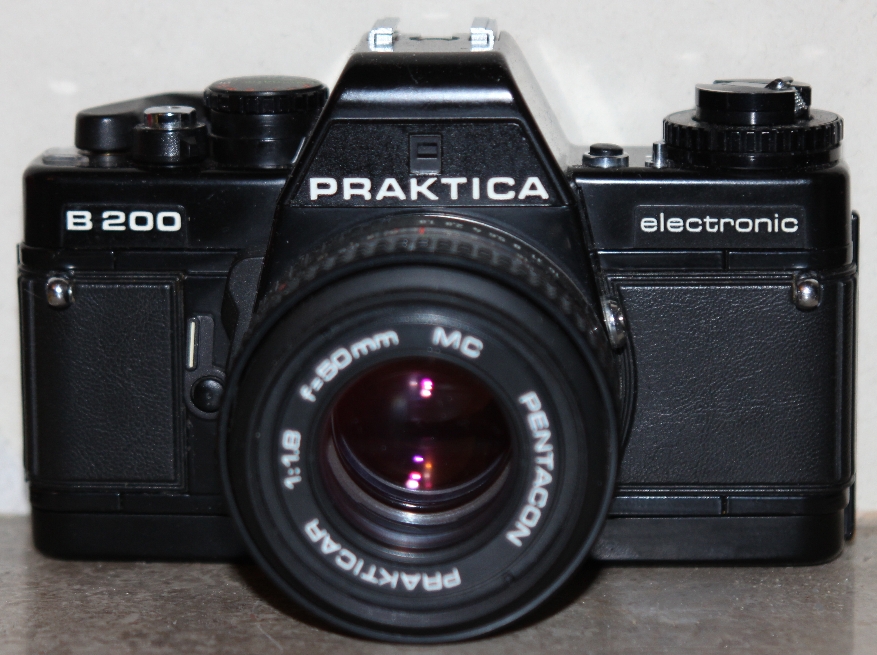

Slowly the Praktica collection is growing ... This is a late 1983 B200 with smooth instead of waffled leather.
attachment.php
darthj,
You'll like using that, I've the B200 with hand grenade style covering :smile:
