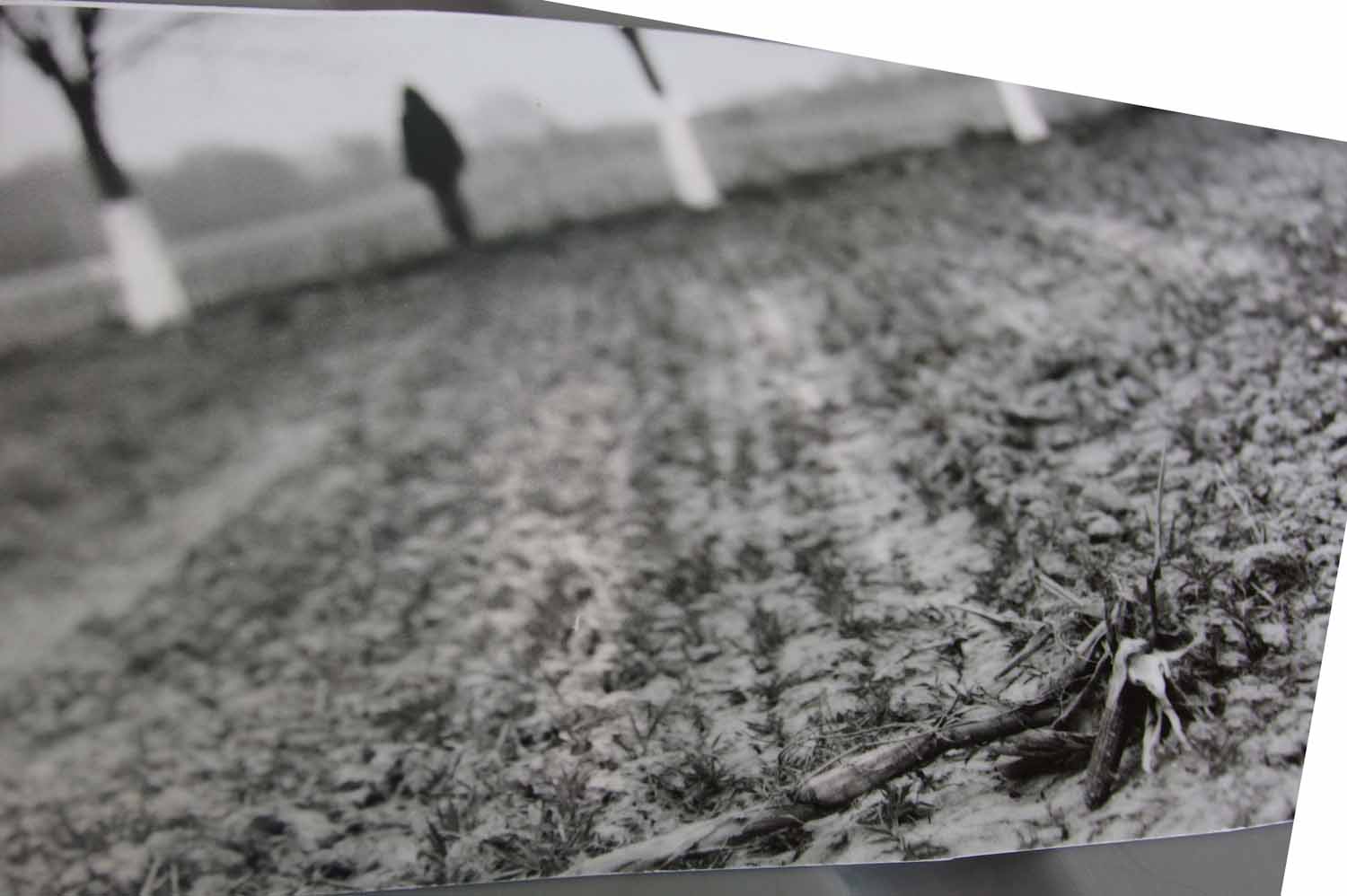

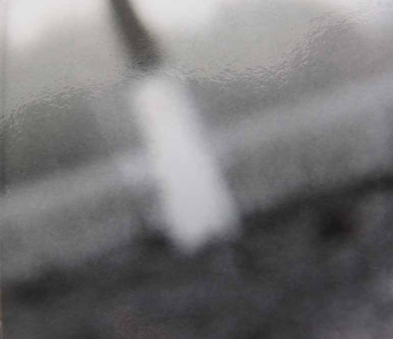

It is not working for me :sad:.
Here are examples where is possible (I hope) to see purple color on photos. In this case I tried with added a little fixer to Potassium Ferricyanide/water solution and I have recived in the end the same results. The purple color is more visible on grey/shadow's area.
I watched this video and he is doing this so gentle without any color shift.

I still try to find an answer for my problem. I used several p.ferricyanide from different stores. The last one was totally clean (for laboratories testing). And I always had some red/purple/yellow stain on the area where I used it. Is it possible that some of my base materials do that? I used Fomabrom paper, stop bath (water+acetic acid), Efke standard fixer. Thanks

I tried to selective bleaching with a solution of 0,5 gram of Potassium Ferricyanide + 100ml of water on fomabrom 111 paper. Results is purple/yellow color of spots/places on paper where I used solution. When I put a paper in the fixer, the purple color is disappeared, spots turn in whiter than was before fixed. The yellow color is still there. Where is a mistake? Thanks
You didn't mention Potassium Bromide, which is an essential ingredient. Without it it is difficult to say what the oxidation product will be and the fixer may not be able to remove it.
