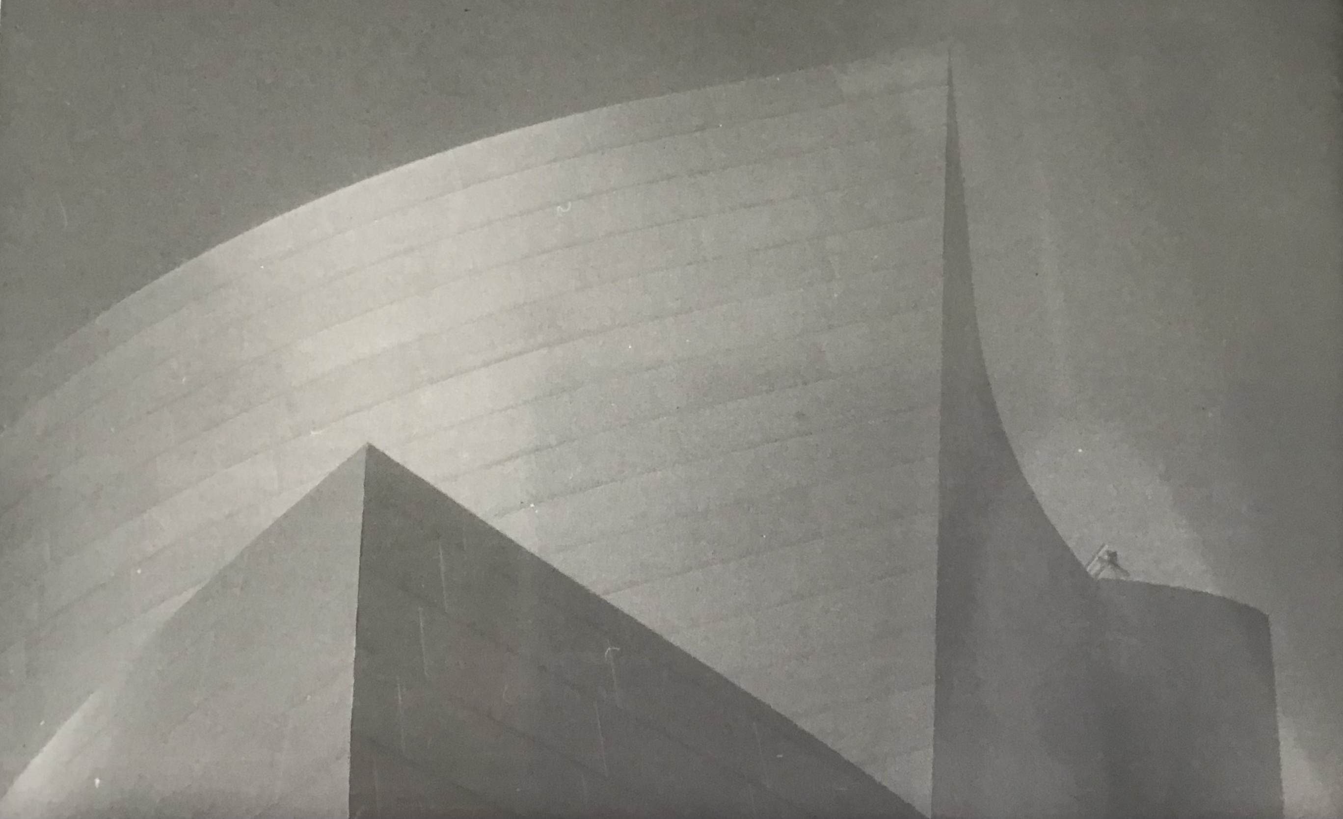

"Frank Gehry Grey" from Rrrgcy is a wonderful example that not all photographs need a "full tonal range" to be good. I like how you kept contrast and shape in the high values. Question: Where did you find Kodak XX film? How fogged was the film?

I’ve had to send out several images/pictures. ā€œFrank Gehry Greyā€œ was Kodak Double-X 5222 and a seller here and various on eBay sell 100’ fresh bulk rolls cut from new ordered 400’ and 1kā€˜. Perhaps I miswrote it and led you to surmise it’s discontinued film (Super-xx?), I’m sorry. Also much too new to understand how to get to various tonal balances in my imagery. With the old Kodak Retina iiic std lens and probably slightly slow shutter, I shot on sidewalk full bright daylight 250/developed@250 Xtol replenished, and using a straight old Beseler 23 and a Rodenstock printed various exposures and selected what I felt gave me the ā€œpictorialist-ishā€ mood. The silver building and hot clear white blue sky must’ve blended the tonality. I imagined It might come out a wash of grey blend.
I’d looked up a lot of the images of that building before and after shooting and hadn’t seen anything similar. A Swiss photographer Johannes Marburg has imaged something from another part of the building only marginally close in appearance, a lot more texture and ā€œcolor/tonal/sharper/digital-likeā€ (but still 270 degrees from and not my look). Also a ā€œMaxPixelā€ image captures another angle but much broader view enveloping more of the building and but a part of my picture and with more normal tone. I was aiming for something unique and not done, something with heavy density to make the building appear very dense and solid. I haven’t seen an image of this section of this building from this sidewalk perspective yet.
I don’t believe I’ve fogged the paper; the series just came out that way. I happen to think the Supra bright day, building and film impacted the output. Still a lot to learn and practice very much experimenting. Recently tried this film at 1600 and I like it. Thank you for the thoughts and contemplation about the image!

Corral Gables White Hot from Rrrgcy...nice shot of that building, is it just going up or is it mirrors?
