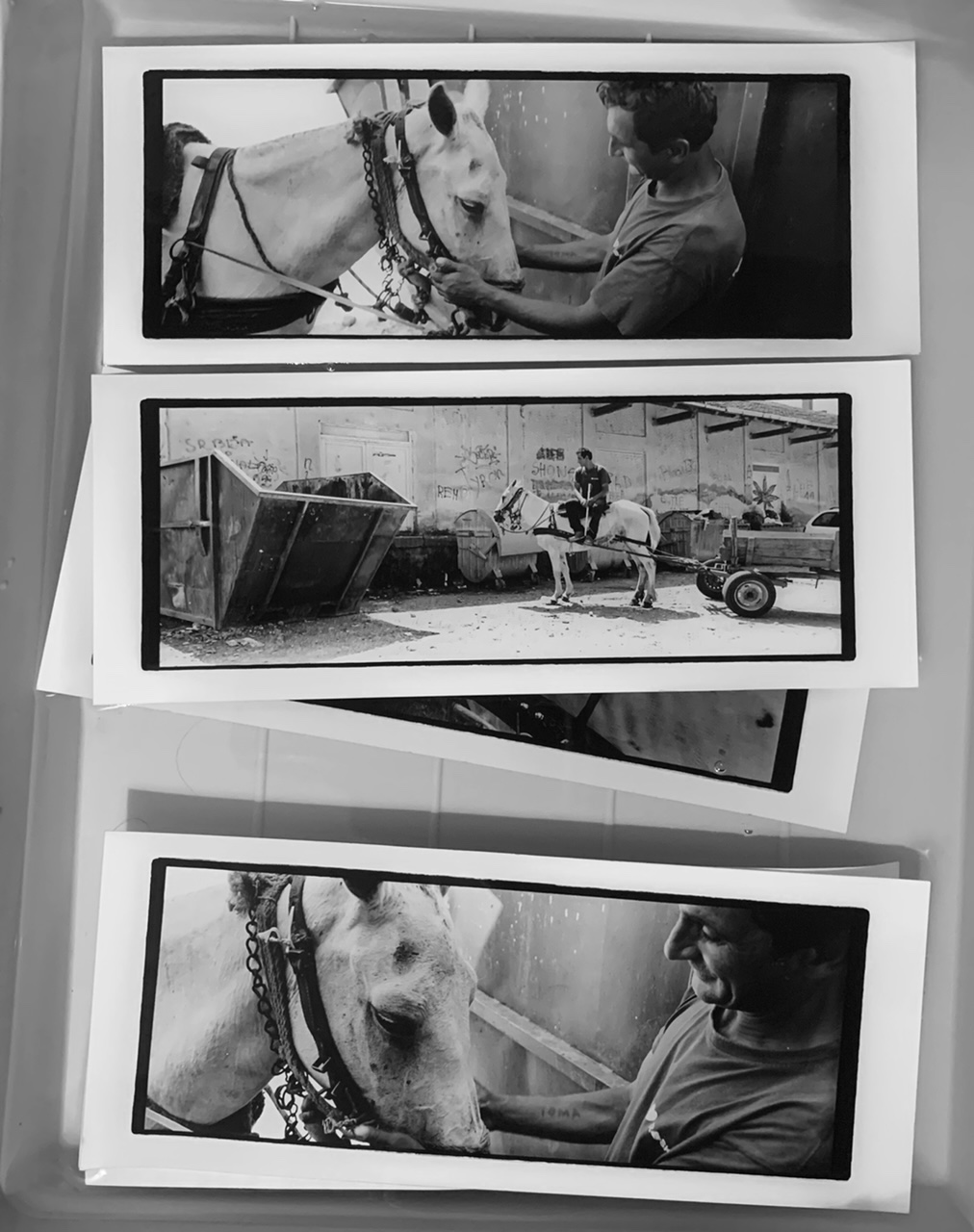

Three prints, well actually five, soaking in bath.
4x10 polywarmtone fb.
