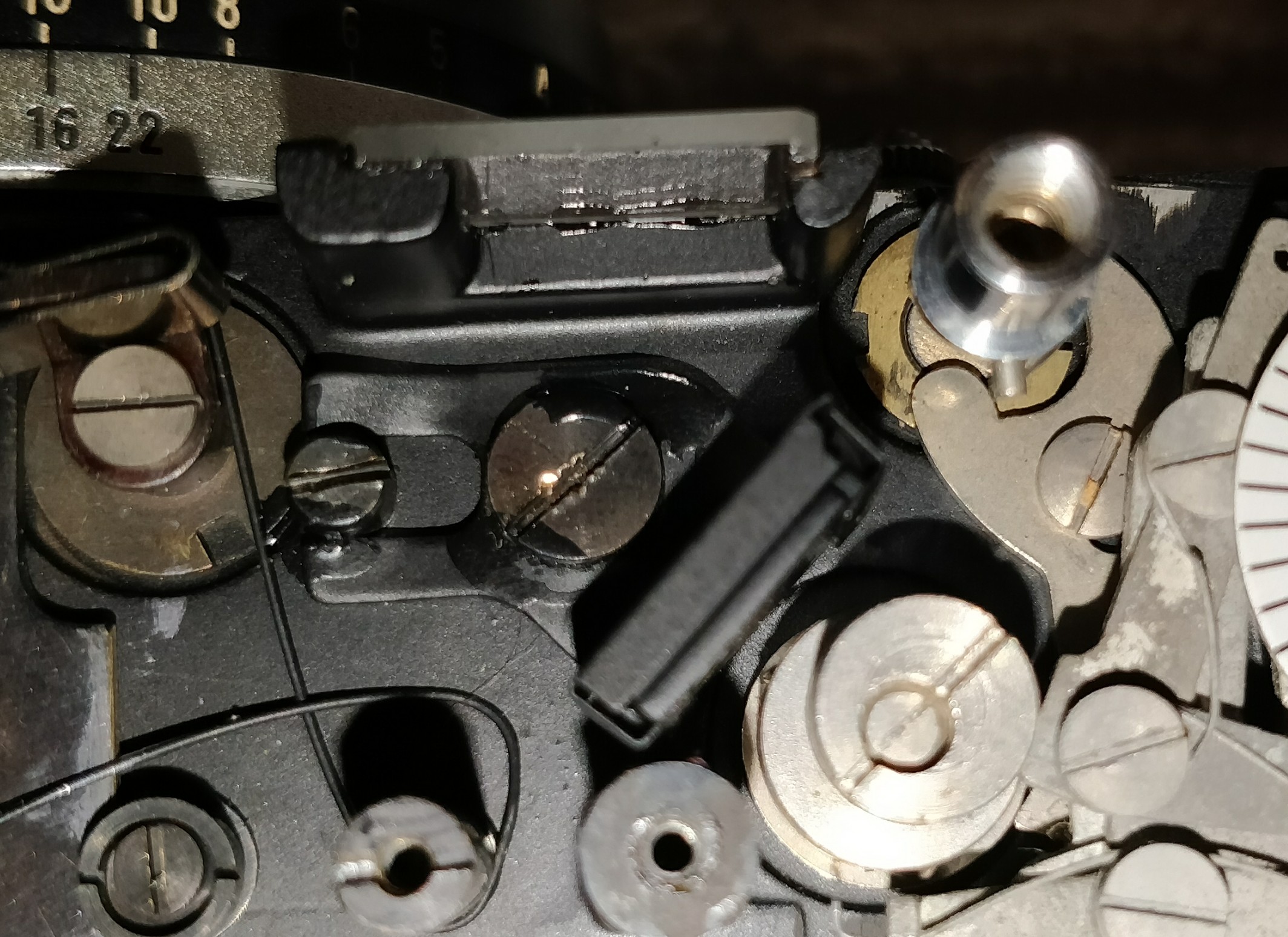

In the event anyone was wondering how to adjust the rangefinder, vertical and horizontal.
  1. Remove the counter nut (small spanner)
  2. Remove the rewind knob (open door, put screwdriver into the spool slot, turn the rewind knob counterclockwise)
  3. Under the rewind knob are 2 screws, remove them.
  4. Remove the top screw on the shoe, under the cover, there are 2 screws, remove them.
  5. Lift the cover off carefully, watch for the shutter release button, it merely rests within the cover.
The photo shows the screws needed, they both have black lacquer on them, the one in front of the mirror, is the vertical adjustment, the one to its left, is the horizontal.
I adjusted to infinity while also checking scotch tape on the film plane ... spot on.
I hope this helps and it is also a great time to clean the glass/mirror while the cover is off. I used the Zeiss lens spray, cotton buds and a rocket blower.

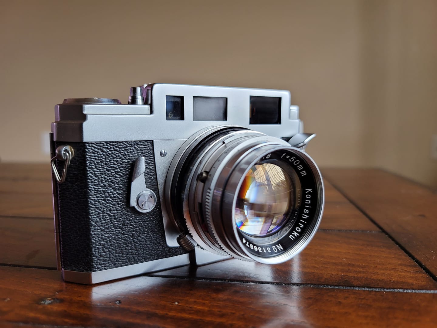

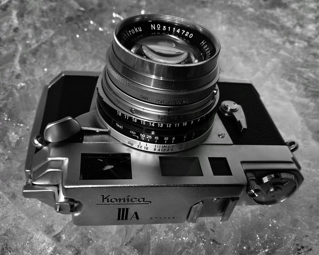

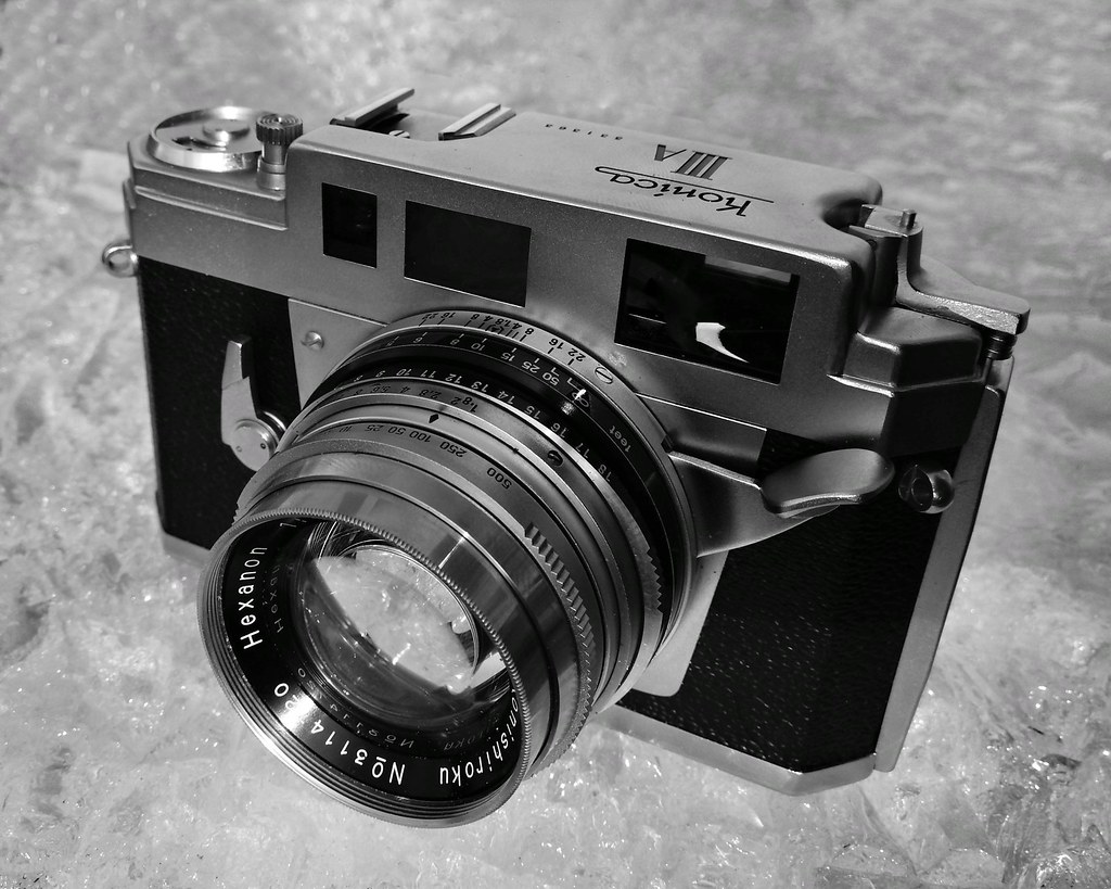

I just picked up an immaculate Konica IIIA. I've been looking for one for some time. Either they were pretty beat up, or price plus shipping was too high. I finally found one in excellent condition and it arrived Saturday.
It looks GREAT, but there was a problem. Shutter speeds were all over the place. Yesterday I took the lens assembly and shutter apart for a thorough cleaning. What surprised me when I took it apart, was that I found an extra leaf in the shutter. There were six shutter leaves with only room for five. Two shutter leaves must have been stuck together when this one was built at the factory.
After a good few hours of soaking in naptha, the shutter assembly was as clean as new. After putting everything back together, now all the shutter speeds are accurate.
For a camera this old, it is in like new condition. I wonder if that extra shutter leaf made this camera not work correctly so it was relegated to a shelf some where. It certainly looks like it didn't get much use.
And yes, the rangefinder is HUGE, BRIGHT and a pleasure to look through.
I've loaded it up with some film and will be shooting a roll or two today. I'll post back once I get some shots with it.
Oh, and this one has the nice 50mm 1.8 Hexanon lens.
What a beauty. Probably one of the nicest looking rangefinders I've seen.
Konica IIIA by Andrew Marjama, on Flickr
Konica IIIA 2 by Andrew Marjama, on Flickr
Konica IIIA 3 by Andrew Marjama, on Flickr
Damn, that looks good! Now I want one too...
