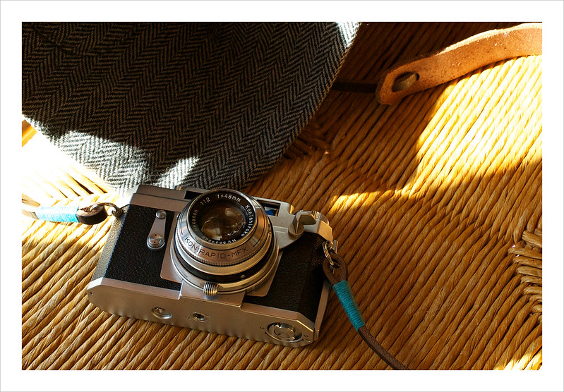

I recently picked up a Konica III and am surprised to find that the front winder works really well. There's no need to shift your grip between shots.

The IIIa's ergonomics are surpassed by those of the Voigtlander Vitessa L. With the Vitessa the right thumb focuses with a wheel on the back panel and the right index finger - or another finger of your choice! - actuates the shutter with a button in the usual place. Film advance is via a plunger on the left of the top plate. Very convenient! But I gather that repairs on the plunger mechanism are a horror show. As is rangefinder work.... And why does it have a fully removable back? One more thing to juggle! While the Vitessa L does have a parallax compensating viewfinder, the IIIa's surpasses it, as it does virtually any other RF camera. I own both, and would part with neither. :happy:
Yup, I have both the Vitessa L and this new IIIa.
I'm not sure which I like better yet. Both are jewel-like in their quality and design. Both have EXCELLENT lenses (I have the Ultron 50mm F2 on the Vitessa L).
I won't be parting with either.
