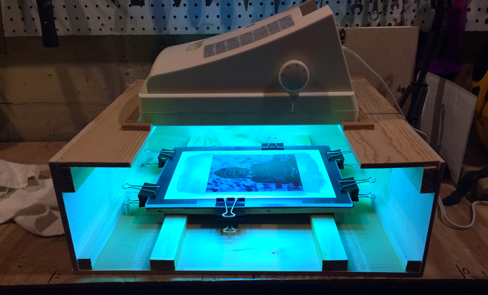

I'm looking at trying out cyanotypes and considering my UV-source options. I want to keep the costs down as much as possible and I have very little electronics experience. Will these bulbs work if I can figure out how to wire up an array? I'm thinking a grid of 4x3 or 5x3 to use with 8x10inch paper.
https://www.lowes.com/pd/60-W-Equivalent-Black-Spiral-Blacklight-Cfl-Decorative-Light-Bulb/50038868
60 W Equivalent Black Spiral Blacklight Cfl Decorative Light Bulb
Thanks,
Adam

The facial tanning unit arrived, cosmetically challenged but working just fine. I did a couple of tests using a cardboard box and built the unit below out of a couple of wine boxes a colleague rescued from the sidewalk and some scraps from the garage. Some sawing, drilling, nailing, screwing, and gluing, and voila!
I did a few prints this morning. I'm getting times of 5:30 to 7 minutes at a distance of about six inches--very nice!. Coverage is pretty uniform so far.
Now I gotta nail down the negatives. I only have a low-end 4-color inkjet and it doesn't put down a very dense coat of ink on transparencies. I've made some nice prints by printing two copies of the negative and taping them together for more density. The printer does pretty well on paper, so I may experiment with waxed paper negatives. I'd love any advice or guidance.
