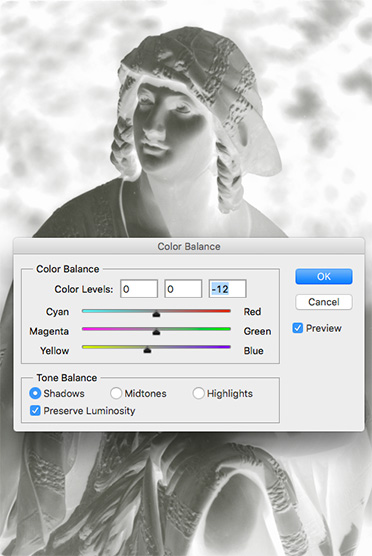

I've read somewhere that yellow ink is a strong UV blocker. You could increase contrast by adding yellow to the shadows (after inverting). To be clear, I'm suggesting a) start with a B/W image, b) change mode to RGB, c) invert the image to a negative, and d) add yellow to the SHADOWS (which are inverted highlights). This makes the denser parts of the negative even less permeable to UV light, increasing contrast. One easy way to do this in Photoshop is with Image > Adjustments > Color Balance:

Thanks, Tom. So far, using two negatives taped together is working well enough. The solution is to address the problem of negs without enough ink overall, not just in the shadows.
