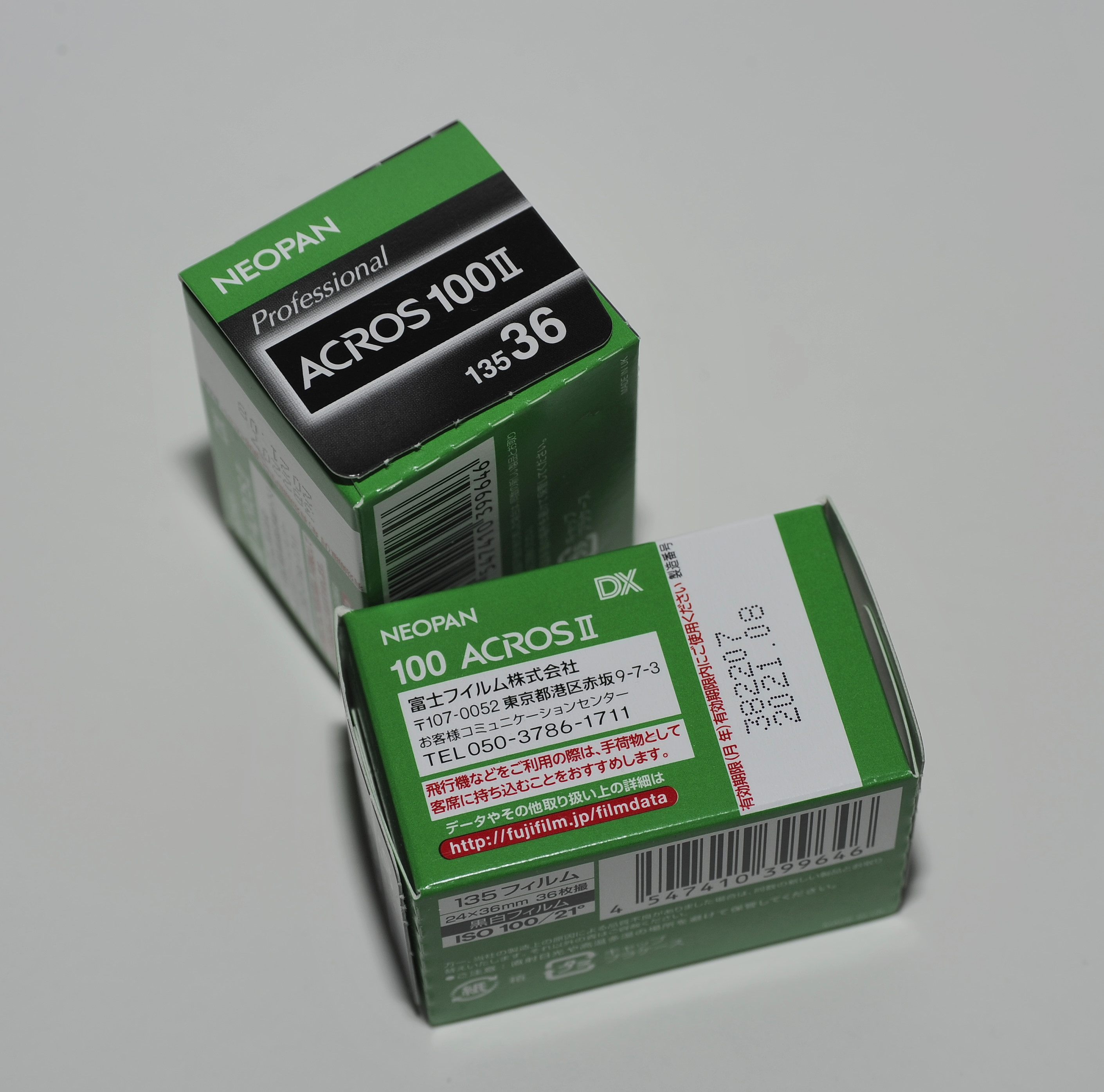

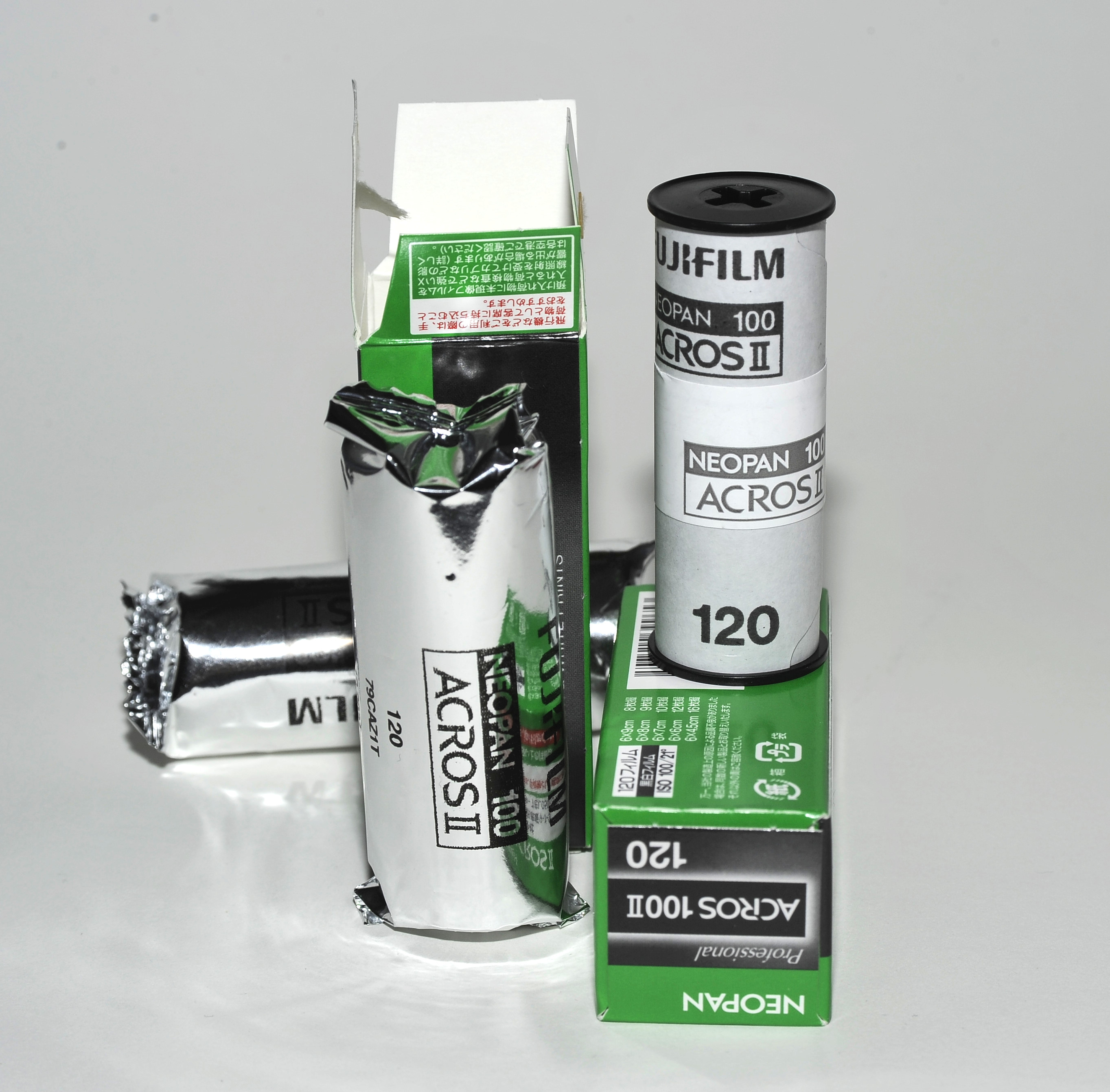

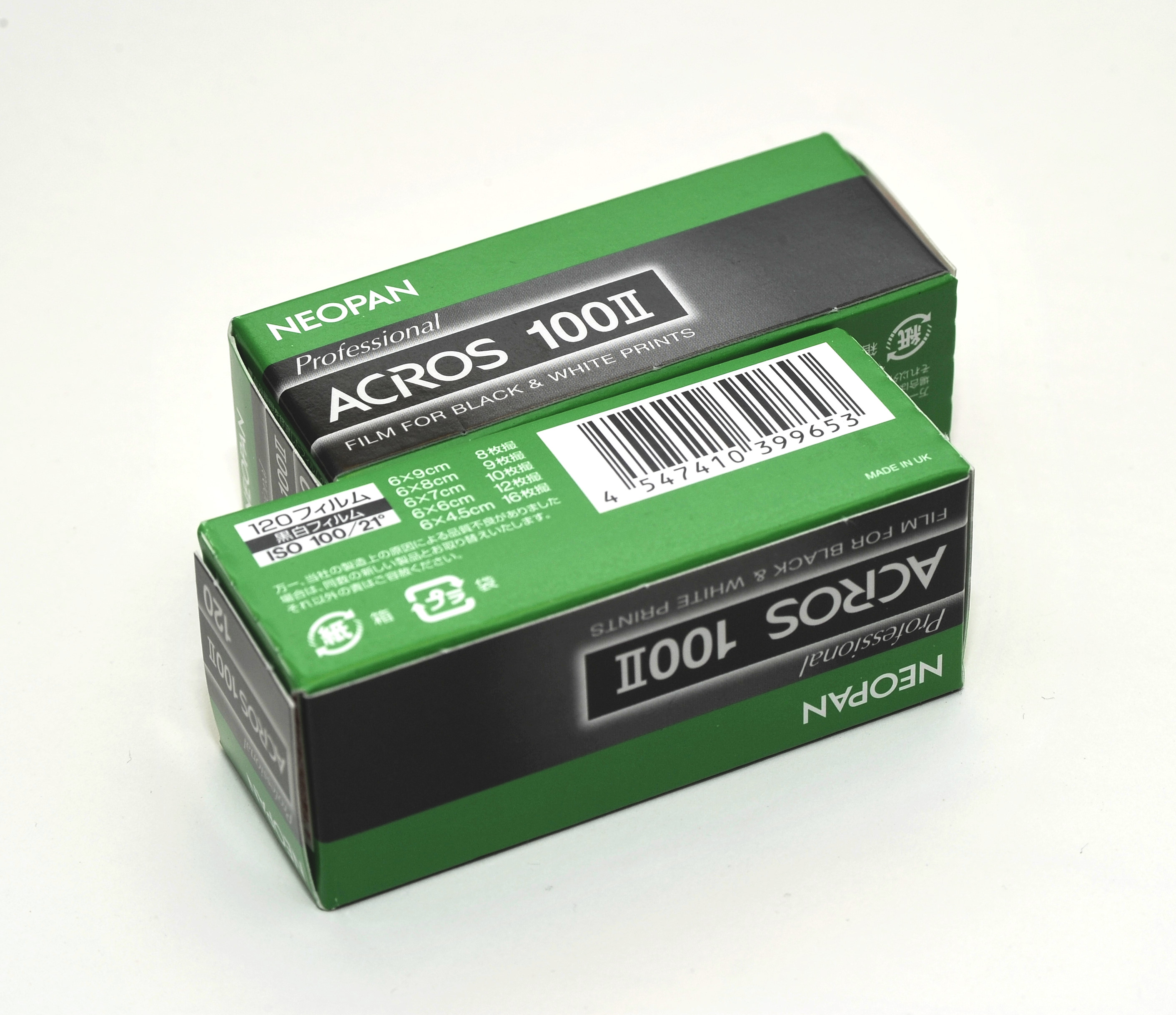

Hello friends,
positive news from Fujifilm:
After the initial release in Japan last November (in Japanese only boxes), Fujifilm Neopan Acros 100 II will be officially introduced in Europe (and most probably also worldwide) this spring (planned is March / April).
I've got this info directly from Fujifilm.
When Acros II was introduced in Japan last November, I immediately ordered lots of it in 135 and 120 in Japan.
After the shipment arrived I started intensive testing, including Acros I vs. Acros II comparisons.
I did my scientific standard film tests in my photography test lab. And I did several shootings of different subjects, too.
The test results are very positive:
a) Acros II has absolutely nothing to do with any Kentmere / Ilford film! All these stupid conspiracy theories about Acros II being just another repackaged Harman technology / Ilford Photo film (because of the "Made in UK" on the boxes) are complete BS and have absolutely nothing to do with reality.
b) Acros II has exactly the same outstanding reciprocity characteristic as Acros I. I have tested it. It is also documented in the data sheet of Acros II, and the data sheet is absolutely right.
That is extremely important because no other BW film has this unique and outstanding characteristic.
And in colour only Fujichrome Provia 100F has that wonderful feature.
c) The excellent detail rendition of Acros I is also given by Acros II: Resolution, sharpness and fineness of grain are identical. Both films have identical MTF curves and identical RMS value. I checked it with my sophisticated resolution, sharpness and grain tests in my test lab, and both films are again identical. Data sheet is correct. Great news again.
d) There are some very small and negligible differences in spectral sensivity, and a small difference concerning the characteristic curve in the highlights (with some developers). I will not go into detail here. In the next days I will post a complete test report in the BW film subforum. Stay tuned.
So, from now on it is up to all who have loudly complained about the discontinuation of Acros: You have your film back!!
Buy it. Make this reintroduction a success! When this becomes a success, then it is much, much more likey that further film reintroductions could follow by Fujifilm in the future.
A film manufacturer has to look on his sales. That is the decisive factor!
Best regards,
Henning

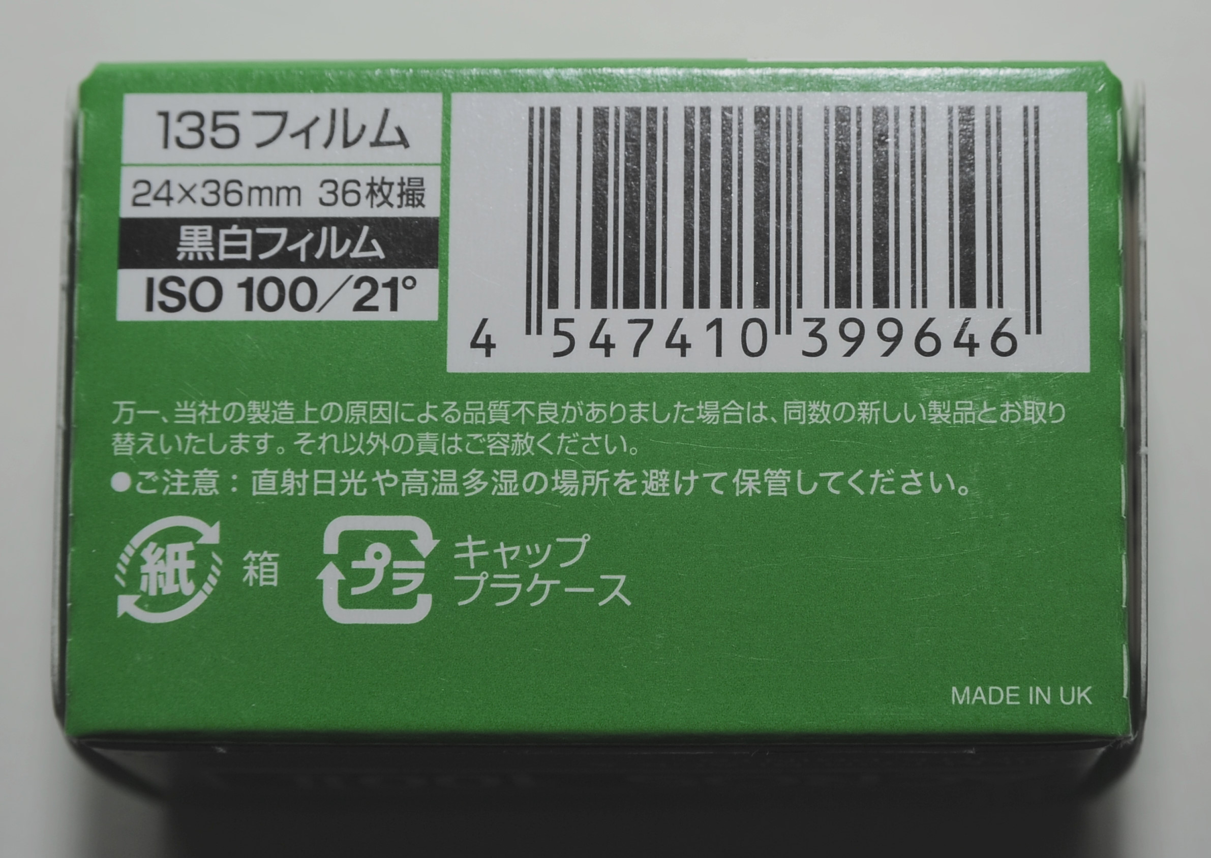

Can you indulge me, Henning, by saying what you know about the reasons why Made in U.K. is on the boxes. You may have covered this and I may have missed what these were, in which case I apologise. The reason I ask is that the Acros II thread or was that threads was full of many statements, many of which had to be reasoned or unreasonable speculation based on what was generally known.
You would appear to know from information give to you by Fuji possibly today or very recently what the real reasons are for the Made in U.K. printed on the box. A statement from you on this would help.
Thanks
pentaxuser
Thanks, Henning. I had no doubt in my mind that it would be good old Acros and nothing else! I'll be buying a whack of it when I'm in Japan next month.
Yes I have had explained the possible reasons here, see post 54:
https://www.photrio.com/forum/threads/acros-ii-released.171175/page-3
Thanks
pentaxuser
So far there is no official statement from Fujifilm.
I have discussed that topic several times with my Fujifilm contacts. They have listened very attentively. And I have highly recommended to them that Fujifilm should publish an official statement. Because that would strenghten the faith / trust in the brand. The BW film photography market is an enthusiast market. The customers love their photographic medium, they are highly dedicated and involved. They want - and appreciate - information and communication by their manufacturer(s).
Companies like e.g. Ilford Photo, Kodak (EK and Alaris), ADOX, Film Ferrania have realized that and are communicating with their customers. And often give background information for a better understanding of certain steps the company has to made. Because of economical or technological reasons. So that the customers can better understand the necessities and challenges in the industry.
Fujifilm is unfortunately still far behind the competition in their PR / communication policy. A lot can and should be improved in that regard.
But I am only one single person, a "drop in the ocean". My recommendation:
Please stop wasting your time with these discussions in forums. Get in direct contact with Fujifilm!
With your national / local Fujifilm subsidiary.
And / or your local Fujifilm Wonder Photo Shop (there are lots of them worldwide): http://wonderphotoshop.fujifilm.com/
Or via social media: https://www.instagram.com/fujifilm_profilm/?hl=de

Thanks for the reply. Yes #54 on the other thread to which you link does clarify that currently all you can state is possibilities and that remains the position. I simply wondered if Fuji had supplied the information about the full explanation of what Made in the U.K. means. Clearly not and now I know this I will not waste any more time on Photrio asking for information that Fuji has chosen not to release.
It may be that only me or at best only a few of us on Photrio would like to know what it means. I suspect that this may be of no concern to the film newcomers who anyway may or may not be able to persuade Fuji to make a statement.
I have serious doubts whether a few "voices" on this site can change anything about Fuji's thinking on what its film users need to know about its products

Regarding the films origins the suggestion in the comments in the kosmo article below, is that the new Acros II film is coated by Fuji at the kanagawa factory, Ashigara in Japan and and converted/packaged by Harman, or at least the 120 format is. The instagram user referenced is the same one, from memory, who has previously had informed news about Fuji.
This seems a likely scenario as it avoids Fuji handing over the films technology and the challenges of coating it in a different location. The reason given is to 'guarantee long-term stable production' . Presumably the volumes are relatively small and given reported high demand for film products this is a way of bringing it to market without impacting on production of other products. Fuji has a long standing co-operation arrangement with Harman so an obvious partner. As Harman only package single rolls of 120 this also explains the lack of 5-packs.
https://kosmofoto.com/2019/11/fujifilms-new-acros-100-ii-appears-to-be-made-in-the-uk/
The conversion by Harman is pretty confirmed by looking at the packaging. Especially the wrapper. I don't like them, btw, because they don't work well with my JCH film case. It also means no EasySeal.
While it is all speculation until confirmed by Fuji, I have felt comfortable assuming for myself that it is as you say. In recent discussion we've seen it claimed that conversion is enough to put a Made in XXX label on the film. And it does make sense. Anyone reading here for a while is probably aware that all packaging material such as backing paper, 135 canisters, etc are quite expensive.
It can be assumed that conversion costs more than the film being converted. Hence the larger part of the monetary value added happens on the conversion line and that means it is Made in England. Even if the master rolls come from Japan.
A good while ago I remember reading one of Hennings posts about Instax. What I remember is that the Instax conversion lines are running 24h in shifts. I believe he didn't say the same about the coater. Instax keeps the coater alive because I'd like to believe that the Instax business alone makes it viable. But there is still capacity left for our normal films and then probably some.
That is why I 'decided' for me that the film is coated in Japan, but converted in England. The latter because Henning let us know that Fujis conversion lines are completely oversubscribed. They would have Acros II master rolls, but no way to make them into finished film rolls.
This train of thought keeps me happy until Fuji confirms or tells us something else. And then I'll be happy too, because I'll know for sure. Whatever it will be, actually.

That is the current box for the Japanese market (see attached pictures):

Thanks yes 'Made in UK' not 'England' well at least for now...Also confirms this is both 135 and 120.
Yes, it is both on the 135 and 120 boxes. And if you look at the boxes, and see the way of converting for the films, you immediately see the Ilford converting.
Best regards,
Henning
Thanks for the pictures Henning. So what part of my statement in #17 was wrong? It looks as if what you are confirming is what I wrote in #17 and covered again in #19
pentaxuser
