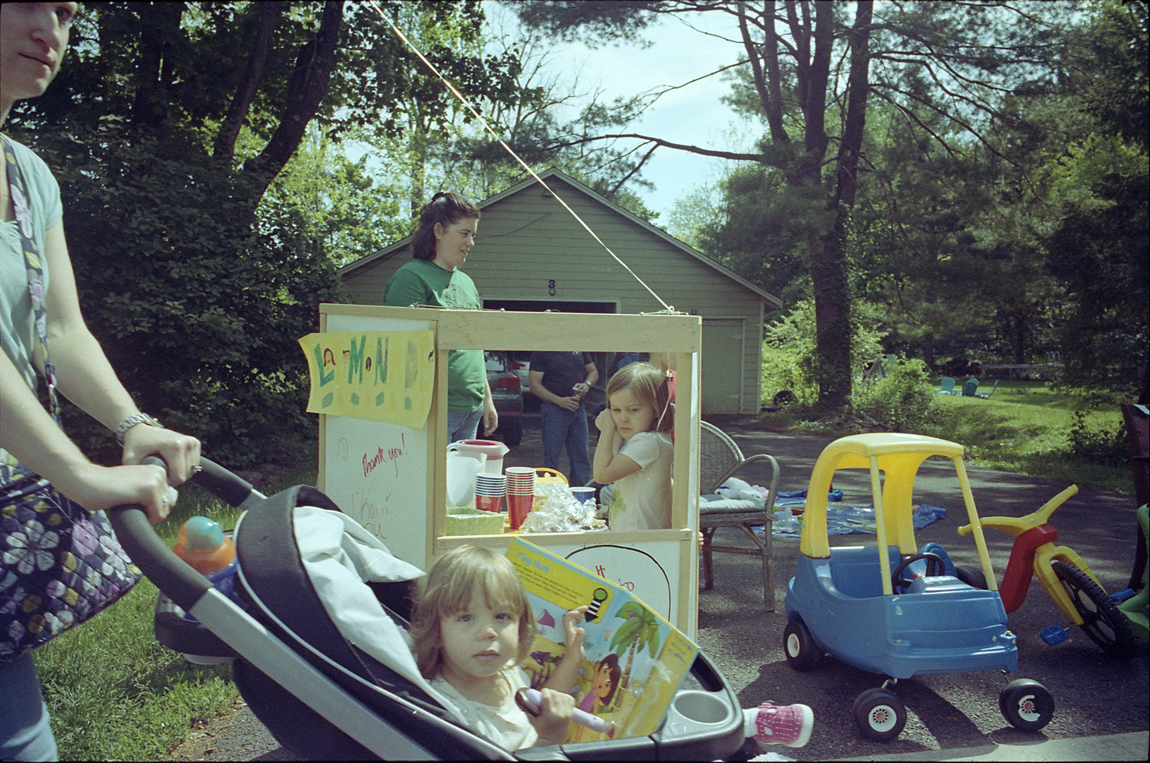

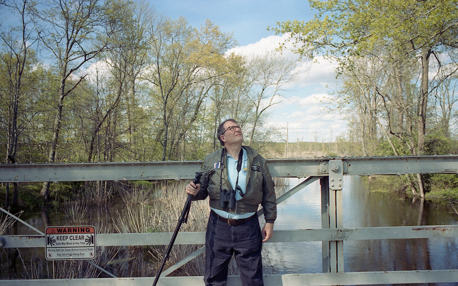

This is what I shot yesterday @400, developed at 38 C for the recommended time. I've developed maybe 10 rolls in the 1L so far, so the development time is slightly extended. The negatives look healthy, but I'm not used to looking at color negs. It's possible they are slightly underexposed, but not by more than a stop because there's good shadow detail for the most part.
I don't know how to interpret these results. I feel like the photos should look a little bit smoother. Definitely smaller grain than pushed to 800--but not imperceptible like on some other examples I've seen like from Huss.

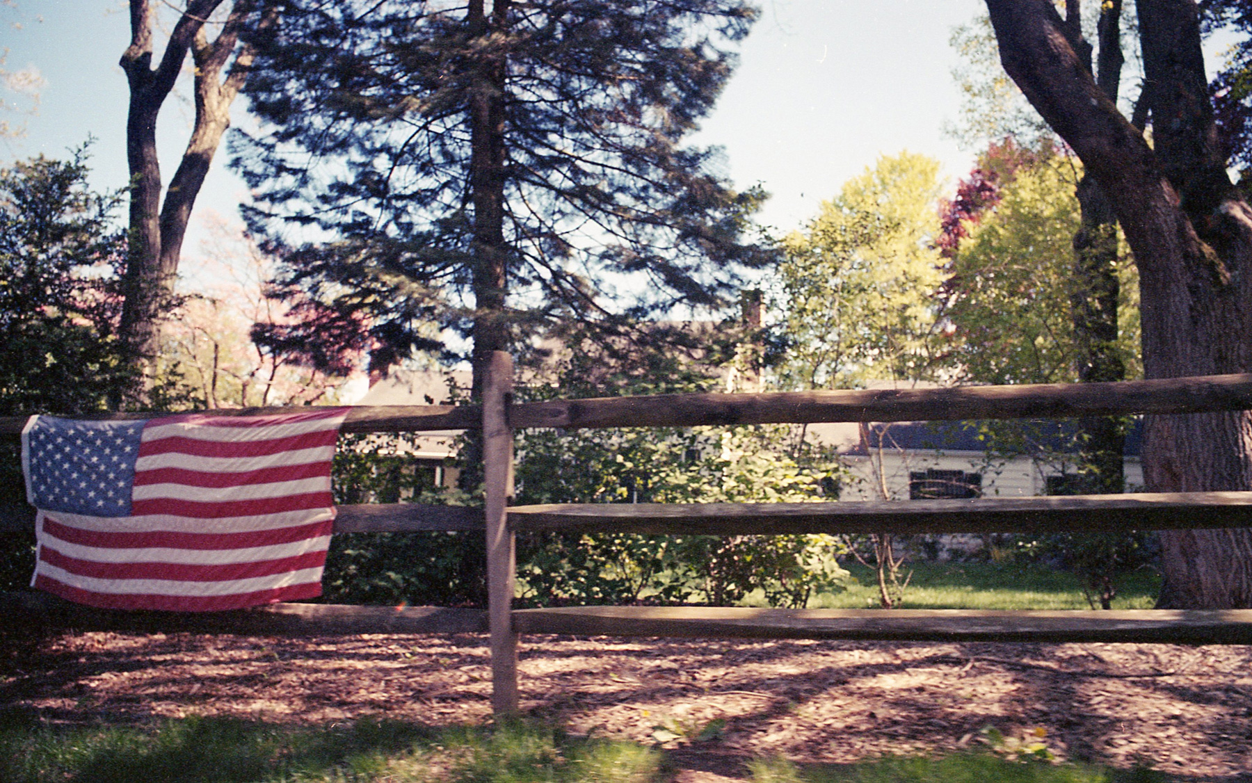

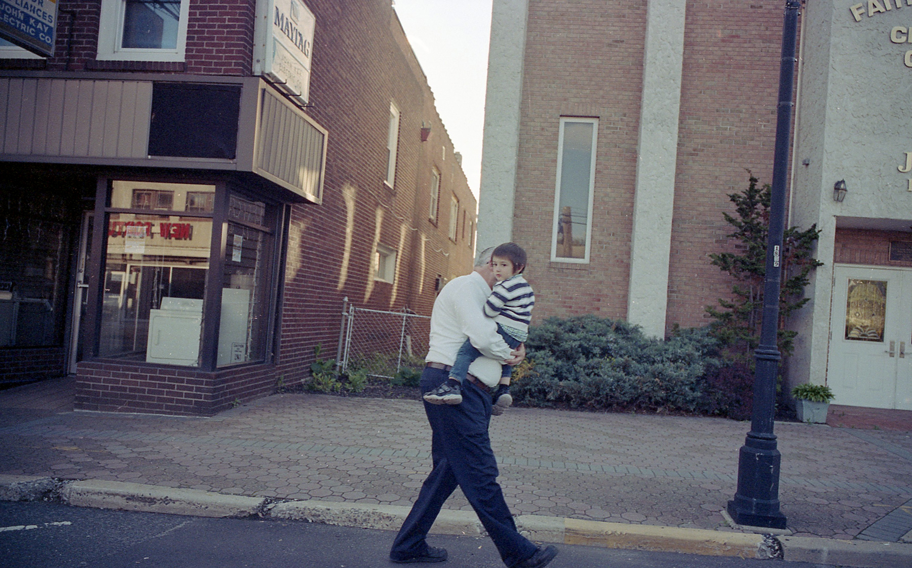

Those do look better, but you're also looking at what looks like to me a scanner to lens height issue which you'll have to go to http://DPUG.org to handle.
So you may be dealing with the scans not giving the best and sharpest scan which is compounding the issue, as they do look "out of focus" so to speak, however there does still seem to be a grain issue also.
It sort of looks like in the shadows you have "blown pixels" (where you see black and then a random green dot) is what I call them, which Portra400 in 4x5 was giving me. I was told that was a common issue again with scanning using some flatbeds and that there were better scanners out there that give better shadow/grain results. This is different than the out of focus issue raised above.
Again, you'll have to go to DPUG for further inquiry down that path.
You should post a snapshot of some of the begatives from your phone so we can see their density.

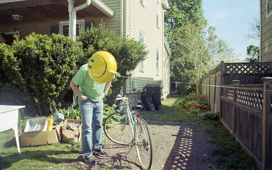

took these today. I'm getting acceptable results, to me at least, exposing at 400 and developing at recommended times. I guess I'll stick with that for now, shoot color when it's nice and sunny and continue pushing b&w film when it's overcast. I still need to get better at color correction... but that's another matter
thank you stone for the information regarding scanners. I'll definitely check out dpug. Looking forward to buying a dedicated film scanner someday.
