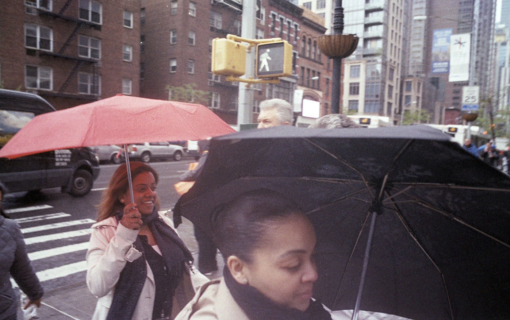

Hi folks, I just purchased a Rollei C41 processing kit from freestyle and have developed about 8 rolls of film--all pushed one stop. To be honest, I was expecting better, smoother results. Everything I shot looks a little soft, and when you factor in the large grain, the sharpness is barely acceptable to me for what I want to do.
I exposed all of the rolls of 400 at 800.
I'm not looking for an image critique, mainly I want to know if I the images look like they were correctly processed. I've only done a rough job spotting the dust, haven't altered the appearance of the grain in any way. I attribute some of the softness of the images to the shutter speed I was using, all 250th of a second, and I was probably moving at the time of exposure.
The Rollei developer I bought has a few working temperatures. I chose 25 degrees for 15 minutes (added 2 additional from the recommended 13 minutes to push the film), and did a pretty good job maintaining the appropriate temperatures for the chemicals.
Anyway, I thought portra was supposed to be a finer grain film. This looks like my tri x pushed to 1600.
Thoughts? Is anybody else shooting portra able to achieve finer grain results? I might take a roll to the lab to be processed to compare their results with my own.

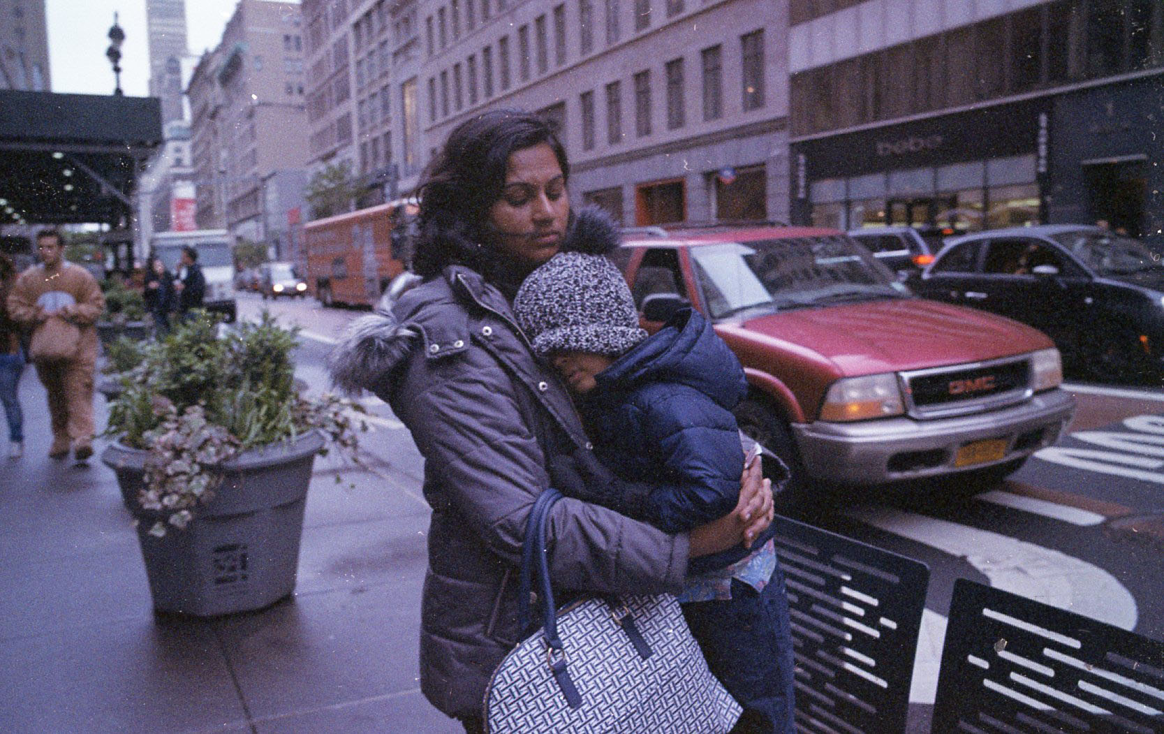

I was agitating too much. I just developed a roll of 400 exposed at 1600 with only one inversion every minute. The grain is much finer than the rolls at 800. will post results in a minute

I would be most suspicious of the development temperature - 25C when the film is designed for a 38C process.
Combine that with moderate under-exposure (metered at 800 EI rather than 400 EI).
Combine that with increased development.
Combine that with a flatbed scanning workflow (with all the additional variables added as a result).
All of the above factors make it unlikely that it is the film that is at fault.
It certainly is possible that the negatives might print with much less grain than appears in the scans.
Shoot the film at box speed and normal development at 38 degrees C. We are only talking about one stop which is well within the latitude of the film. If you really need the one stop use Kodak Portra 800 instead. [No punctuation was over used in the making of this post.]

The prints look like the prints from underexposed negatives. What do the negatives look like?
i dont shoot much color but this film you upload looks under exposed and under processed,
if you are going to process the film 13 degrees colder you will have to increase your
time/maybe your agitation scheme. to compensate for developer inactivity.
good luck
I would guess it's the development temperature. 102F/38C is the normal developing temp, I would start there first. Portra seems to have a pretty wide latitude, and in my experience the grain is quite good on it. Possibly your negs are under developed and the scanner is compensating for that giving you more grain and noise.

There's a few reasons for that related to scanning, V600 (and all the other epsons) have very poor resolving power from film. It's possible for that to be caused by oversharpening. And also possible to be caused by aliasing by your choice of dpi to scan it. If you know someone with a good scanner (not a flatbed) you can check it if you can get one frame scanned through them.
The more you can rule out from that side, the more you can narrow it done to exposure (Doubtful 1 stop would make it significantly worse than at box speed though), chemistry, or other problems etc.
I shoot Portra 400 all the time and get results like this. Very imperceptible grain.
It looks like something went south for you as the images look very underexposed and/or underdeveloped.
That does look strange… Are you absolutely sure your exposure was correct? I feel like it could be either underexposure (which, if your settings were as you say they were, that should be enough exposure) or it could be your scanning method. I have a v600 as well and the presets/auto exposure/settings I find are terrible. Did you use auto settings? Did you shoot any other film stocks from the same developed batch? If so, how did they turn out? Have you ever scanned other Portra rolls with better success? I can tell you, I pushed Portra two stops once, processed at home with the exact same developer (only at 102F), and way at the end of a 15 roll stint on just 1L… It was an experiment with extremely vigorous agitation, I was curious to see how this film stood up to more 'abuse'. The photos came out really, really good. I've only scanned, but grain is much less than your examples and contrast is also a lot healthier.

I'm going to guess its the temp. This looks like the kind of negative I get when I've developed too many rolls and the chemistry is beginning to exhaust. So I'm guessing such a low temp caused the chemistry to effectively not really develop the film fully/properly, that combined with all the extra agitation over 15 minutes. That's insane for color.
Most important thing I've learned with color is stick to the proper and normal higher temps, 100-105 degrees F depending on your chemical developer, some 3 bath developers have different recommended temps, follow those.
