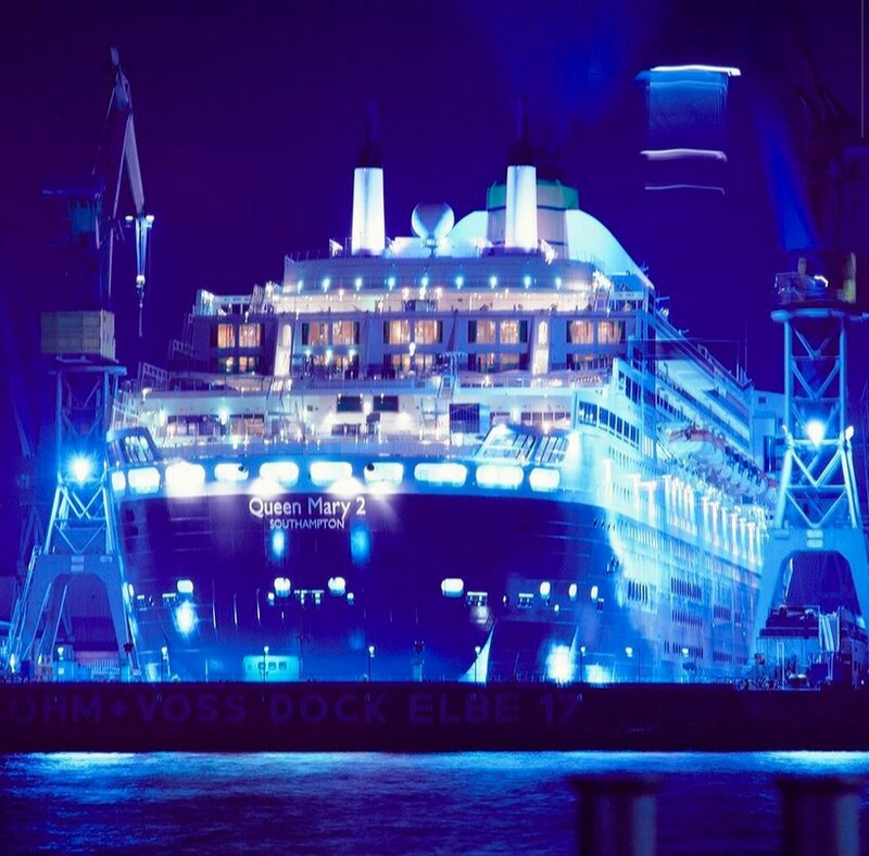

One day long time ago I was throwing some rules over board and soon I came to better results.
Like this here :
:whistling: 1) wrong dynamic range 2) bad dmax 3) overexposed highlights 4) wrong film (expired EPY) 5) wrong color temperature.....a.s.o.
So we may learn - no Seconic is able to tell you what is a picture of own intention.
