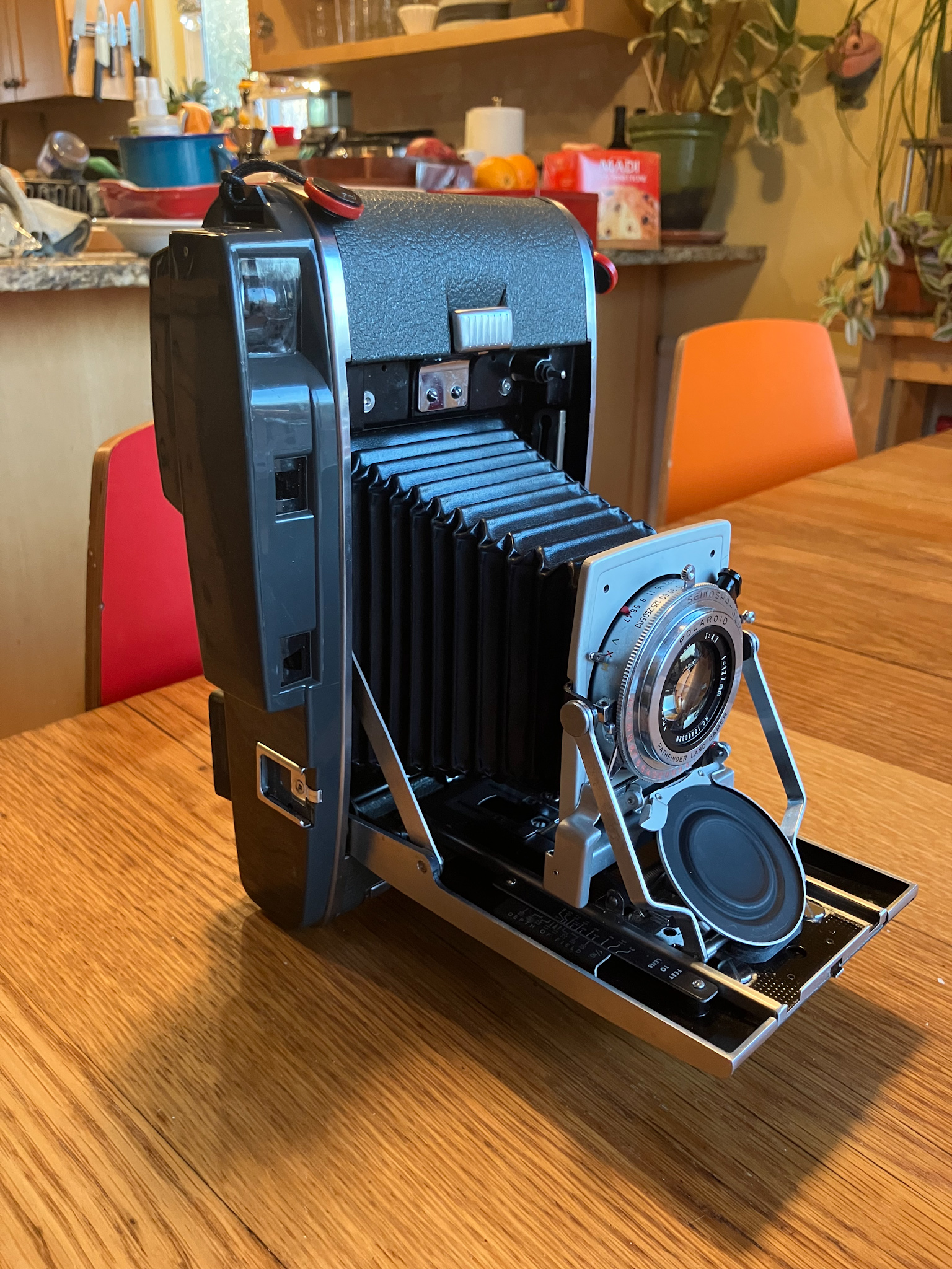

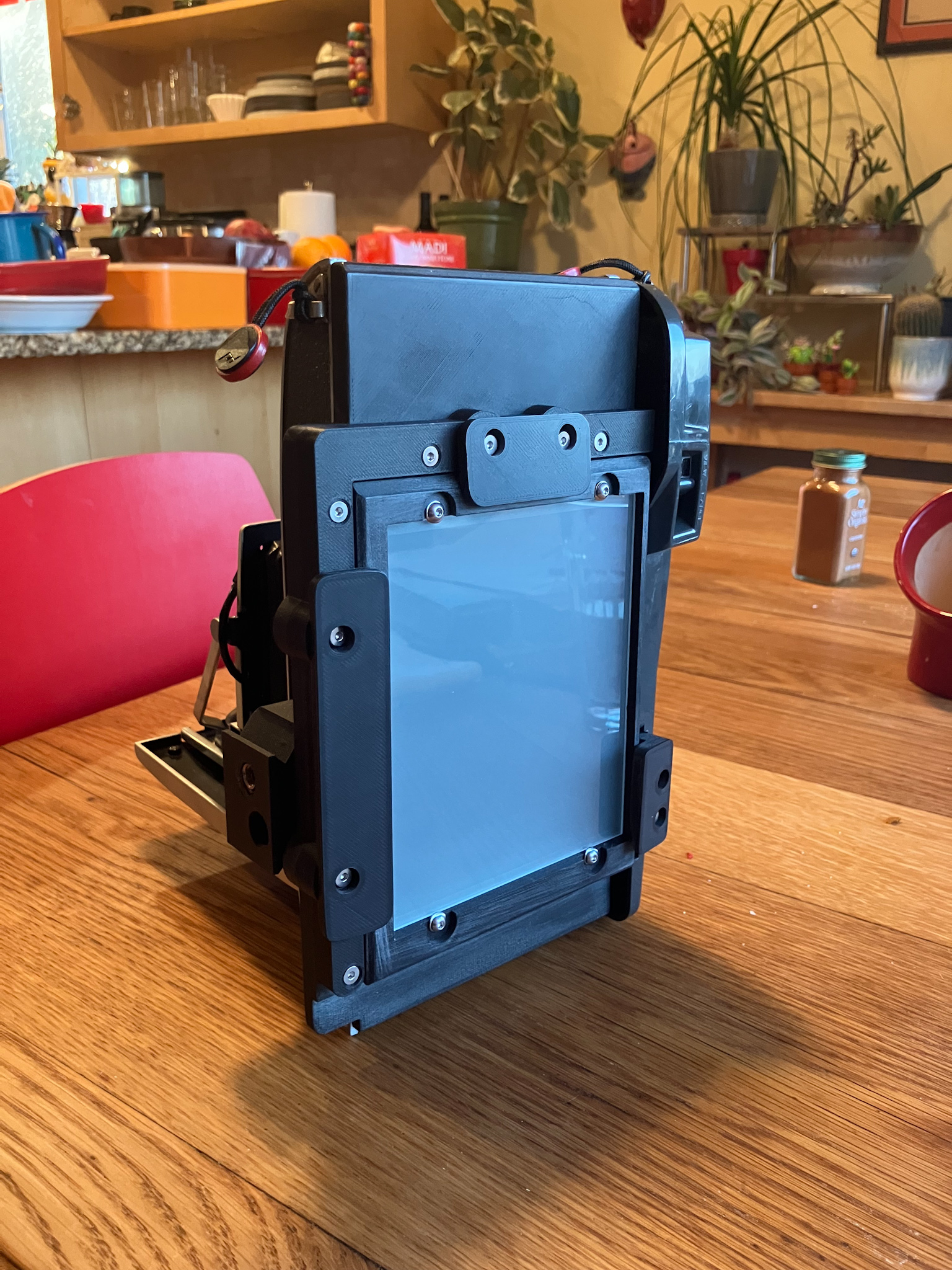

I recently modded a Polaroid 120 Land Camera to shoot 4x5. Exclusively to use it as a hand held take around town camera. Replacing the machinery for polaroid roll film with an 3D printed back to hold 4x5 holders.
https://film.kolve.org/darkroomdiy/polaroid-110-convert-to-4x5/ (works with 110a, 110b, and 120 models)
I bought the camera used locally for about $50 and paid another $20 for parts needed to do the mod.
It still isn’t a light camera, clocks in at a couple pounds. But it packs up nicely, has a nice lens, accurate rangefinder focus, is a lot smaller than a speed/crown graphic, and I’ve found folks are a lot more comfortable around it than a standard view camera.
