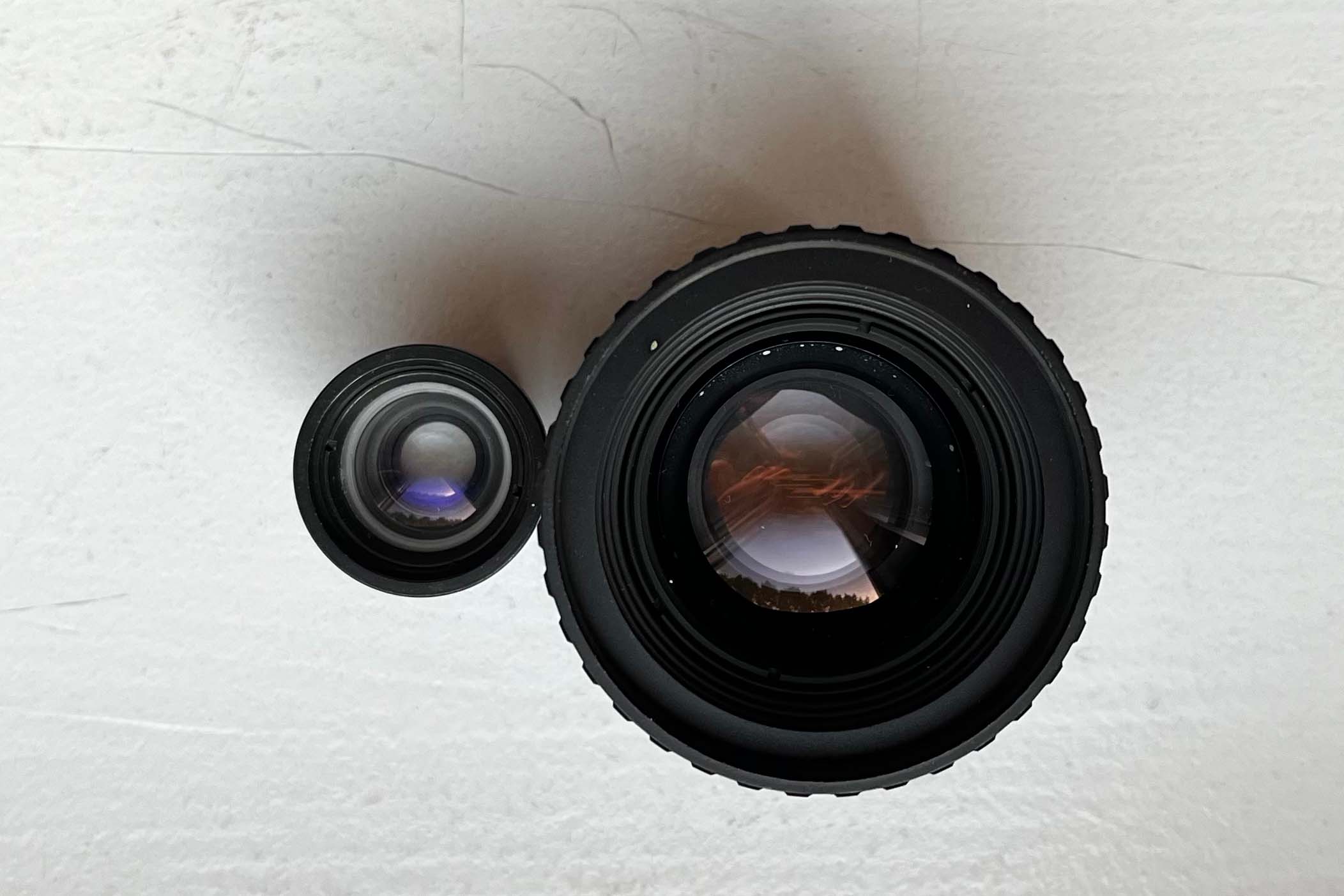

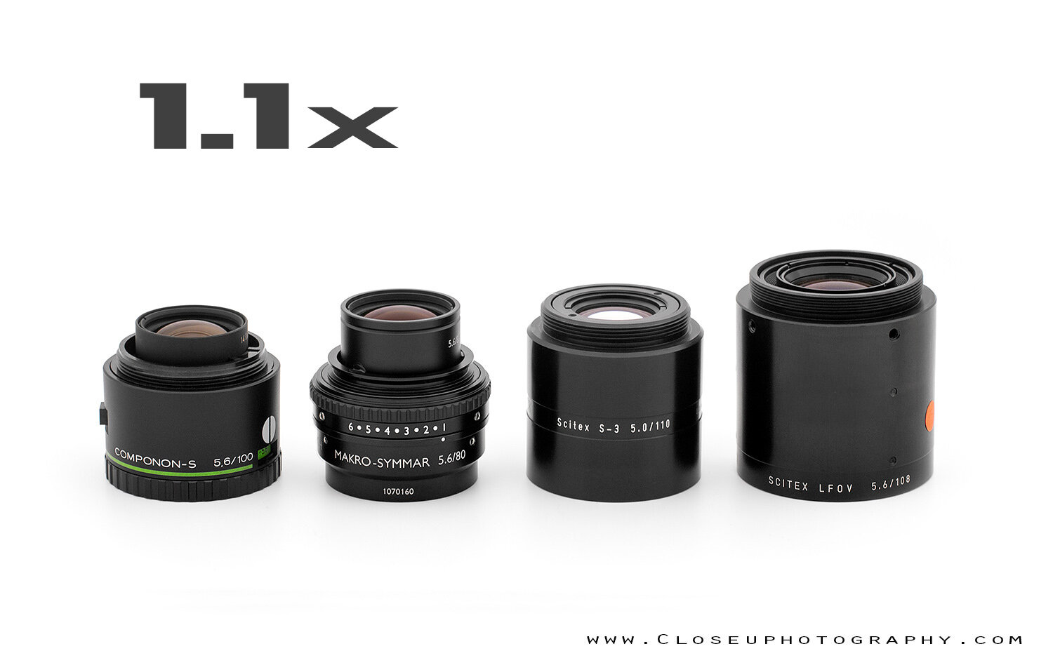

Epson has been using CCD sensors with 40.000*+ pixels (per channel) for two decades now. The sensors are not the problem. On the other hand, lenses inside Epson desktop scanners are a fraction of a size of those in pro desktop scanners made 30 years. And I'm talking about lenses in "xy-stitch" scanners where lens only needs to cover small part of the scanning bed!
This is your typical consumer scanner lens (left) that I took from Canoscan 9000f - Canons equivalent to Epson 4990 vs. Componon-S 100/5.6 enlarger lens (right):
Here the same Componon-S 100/5.6 (left) and lens from Scitex EverSmart pro desktop scanner (right):
Remember, this lens from Eversmart needs to cover only a fraction of the area, Canon lens needs to cover the entire width of the scanning bed. I think one can safely assume where the "softness" in consumer desktop scanners comes from even if we don't count or worry about all the individual pixels of the sensor. There are plenty of them, there is not much need for additional software interpolation (which is still used in some modes to match vertical vs. horizontal resolution).
You'd only need even better sensor in a scanner if you'd have much better lens. Which means bigger size, higher weight, better build, more expensive...

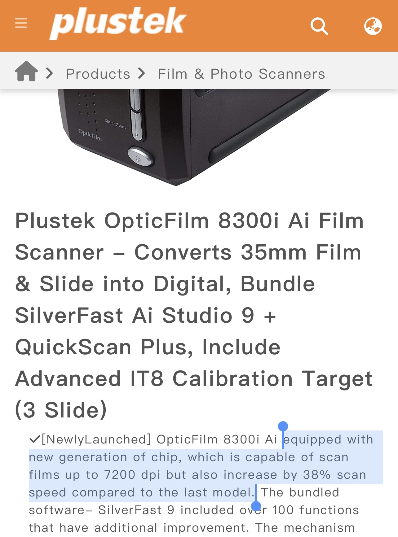

I have not seen any reviews of the PlusTek 8300i. filmscanner.info has a review of the 8200i, and states that there were no changes to the hardware between the 7600i and the 8200i, only newer versions of the Silverfast software. The 8200i has an actual resolution of 3250 when scanned at 7200. The resulting image file contains mostly interpolated data. Actual resolution of 7200 is what you get with a drum scanner on a good day.
The "chip" might as well refer to the ADC - and given the claimed speed increase, this is in fact rather likely. Same CCD strip, new ADC backend.
You might be right. But it does have a higher Dmax, which indicates a new CCD.
Again, I or Plustek at no point claimed ultimate quality. It’s as good or better than a single shot with a 24MP SLR. And it’s a whole hell of a lot more portable and easy to get going with.
