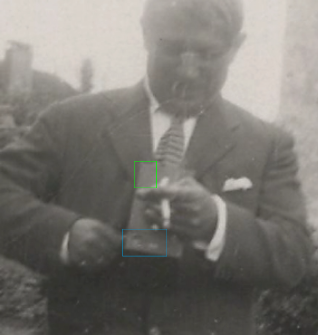

Would be interesting to do a bit of research on if there is a an opposite side? Paplo obviously is about to shoot or has just done so.

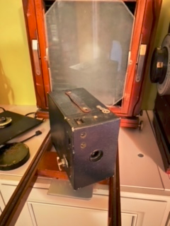

Rainbow Hawkeye 2a model b
The Rainbow Hawkeye 2a looks very nice. I note it has two circles upper left on the front. These cannot be seen on Picasso's camera [green rectangle]. Also, there are some details on Picasso's camera [cyan rectangle], possibly a nameplate, that I cannot see on the Hawkeye. Were there different versions of the Hawkeye?
The two circles are on the front of the camera - they are the viewing lenses. Your green rectangle is on the top of the camera and the cyan rectangle shows the viewing window, which you can see on the Rainbow Hawkeye. The cameras are a very close match, if not identical.
There were altogether too many versions of too many different box cameras. The camera I found is the closest match to what he has that I've looked at.

You are right! I had not noticed that. He is holding the strap and tilting the camera forwards. I think that is case closed; don't you?
Could you be persuaded to cadge a thick rolled up fag from someone and then replicate the photograph so you are holding your Hawkeye in the same way?

Even if Picasso's negatives were glass plates, this particular camera has a winding knob that he's turning while looking at the red window - that's what he is doing in the picture. So this camera does not use glass plates. He may have been more interested in controlling focus and exposure, which would imply he used an Avus or similar camera.

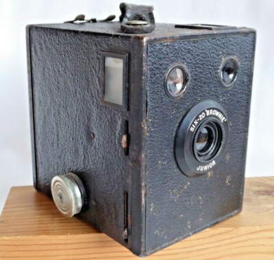

The Picasso Museum in Paris (the person in charge of documentary photographic collections) has suggested to me that the camera is a Kodak Six-20 Brownie Junior.
I am no expert, but I think the Kodak Six-20 Brownie and the Kodak Six-20 Brownie Junior were introduced after 1931 (maybe 1933 or later), and their viewing lens is in a different place.
As knowing you have the wrong answer is almost as useful as knowing the correct answer, I want to tell them. But I want to check with the experts first. Am I right to say the camera Picasso is holding in 1931 could not be a Kodak Six-20 Brownie Junior or otherwise.
I'd say that's not the camera.
Couldn't agree more. I just want to be able to say definitively that it could not be the camera because the Kodak Six-20 Brownie was not made until a few years after 1931.
Then, I will propose your suggestion.
The features on the six-20 brownie junior are incorrect. It opens from the back, the handle is diagonal, the top viewfinder is on the wrong side and it is too small.
2a Cartridge Hawkeye and Rainbow Hawkeye are basically the same, the Rainbow's came in a variety of colors. I believe they are closest to your example. They all had small differences over time, plus European Kodak's sometimes differed from US models.
