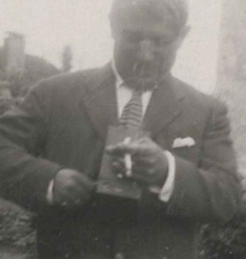

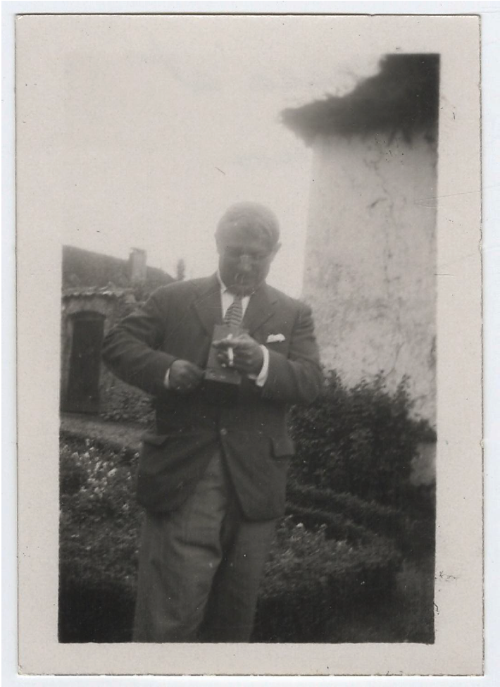

Can anyone (please) identify the camera seen here being used (poorly) by Picasso in 1930.

It looks like a Kodak Brownie - but one that takes a film size bigger than 120. Maybe a number 3?
Many companies made box cameras, it could also be a falling plate camera, or maybe a 9x12 camera. Try finding a copy of John Richardsons book "Picasso and the camera". It's actually unlikely to be a box camera as Picasso was an accomplished photographer.

You are probably right, but there is a chance the camera was a gift from Gertrude Stein. Stein took this photo of Picasso using the camera in 1930. She was American. It's all guesses, but not impossible.

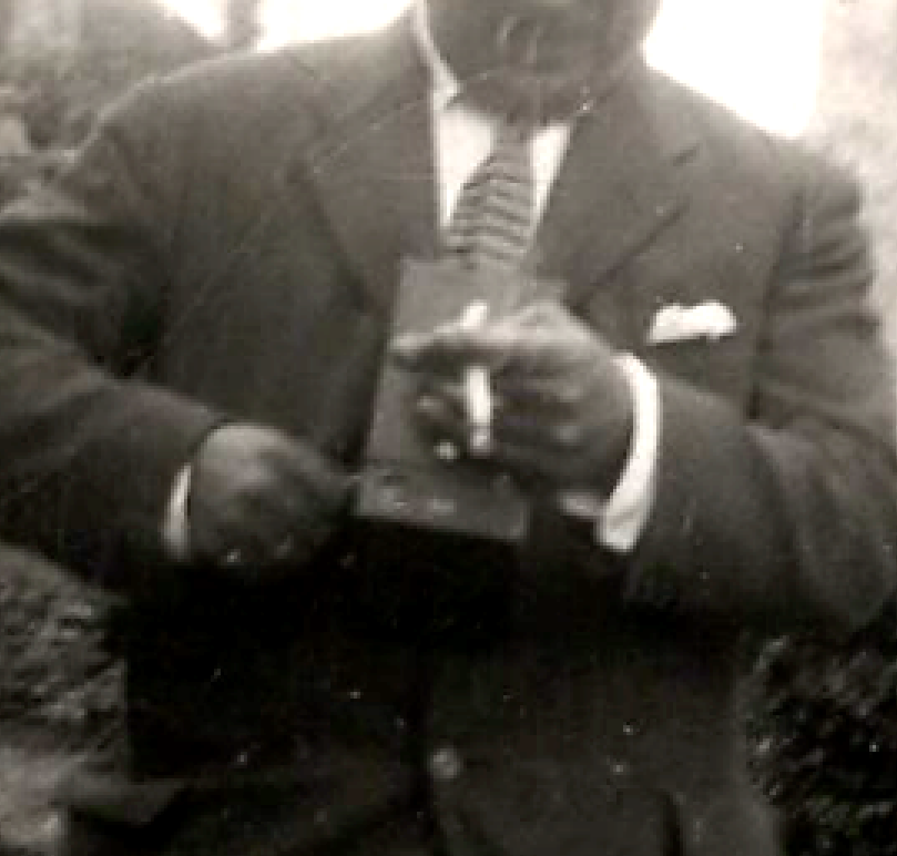

I believe it's a Kodak No. 2a Brownie that takes 116 film. There are several features that match.
The camera opens from the front, and you can see the top latch under his pinky finger.
You can see the shiny buttons holding the handle, the back one is under his cigarette. The handle is in line with the camera.
The viewfinder is rectangular and on the user's right and the aperture tab is in the center. The time exposure tab is not visible, but it is tiny.
The wind knob is at the bottom, note how close his right hand is to his body, versus his left hand at the top of the camera.
It is not a No. 2, as they all load from the back, and not a No. 2c or No. 3 Brownie, as they are much larger. I have a No. 2a and my hand on the top of the camera covers the same area, the pinky finger covering the top latch, and my thumb near the back of the camera.

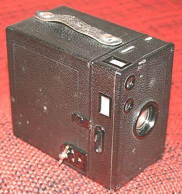

Goerz Box Tengor?
While they are similar to the Brownie, they have a single latch to open on the right side, the Brownies have chrome latches on both the right side and the top. I believe the spot just below his pinky finger is the top latch. Also, the aperture tab on the Goerz appears to be farther from the front of the camera. The Goerz has its aperture behind the lens, the Kodak has it in front of the lens. Of course, we can't tell from the photo, but the Goerz is made of metal, the Kodak is cardboard.

Goerz Tengor 6.5x11

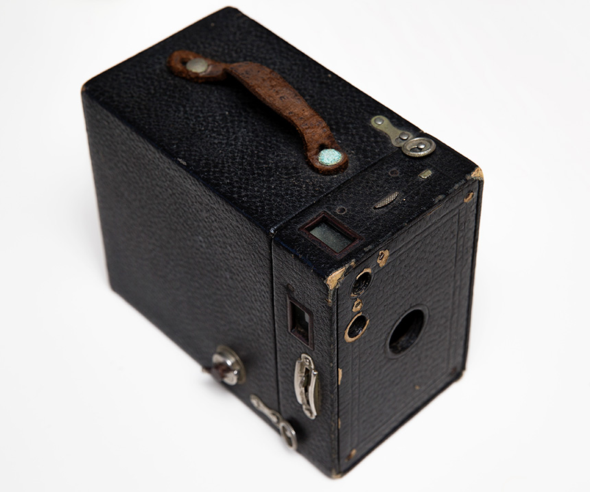

Brownie 2a

The viewing window in the Tengor is too close to the edge. The Brownie is a better match.

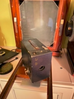

I have a Rainbow Hawkeye 2a model b that looks like it could be right. It takes 116 film. It still looks too small, but I guess Picasso was probably smaller than me.
