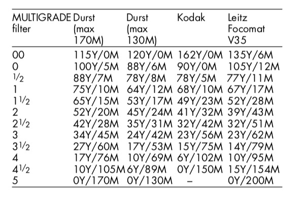

You could, by referencing Ilford's color filter equivalent chart: https://www.ilfordphoto.com/wp/wp-content/uploads/2017/03/Contrast-control-for-Ilford-Multigrade.pdf
Or you could make your life much easier and get a set of the proper filters. Or at least 00 and 5 and learn split-grade printing.
I don't see anything relating to physical filters. I read the whole document before posting to this thread, and all I see are comparisons to enlargers with color heads.
Third page, 2nd column.
There is also information about compensating for use with a cold light head on the last page.
Pieter12, thank you, but as I said, those are enlarger color-head settings.
Color-head setting are filter values, and those values should give you a starting point to use your filters.
The challenge may be to determine the equivalency between Cibachrome filters and CC filters (the Y and M value filters on the chart).
I don't know if the Cibachrome filters he has have the same designations on them.
My quick research shows Cyan, Magenta and Yellow filters, in .10 increments from .10 to .50, plus a .05 of each. I don't know if the individual filters are labelled, but by combining them they should work for some grades. Much simpler to get an Ilford set of MG filters and skip the headaches, especially for a beginner.
[QUOTE="Pieter12, post: 2344442, member: 85702" Much simpler to get an Ilford set of MG filters and skip the headaches, especially for a beginner.[/QUOTE]
Ok, now I get what you're saying - use a rough equivalent between the slider positions and the different densities of the filters. That makes a lot of sense.
I am thinking that a test like the one in post #19 would provide a good guide to what each filter will do. I'll probably cut a couple sheets into strips and expose them all to the same part of a reference print exposed with no filter. I'm even welcoming this particular headache for educational purposes.
