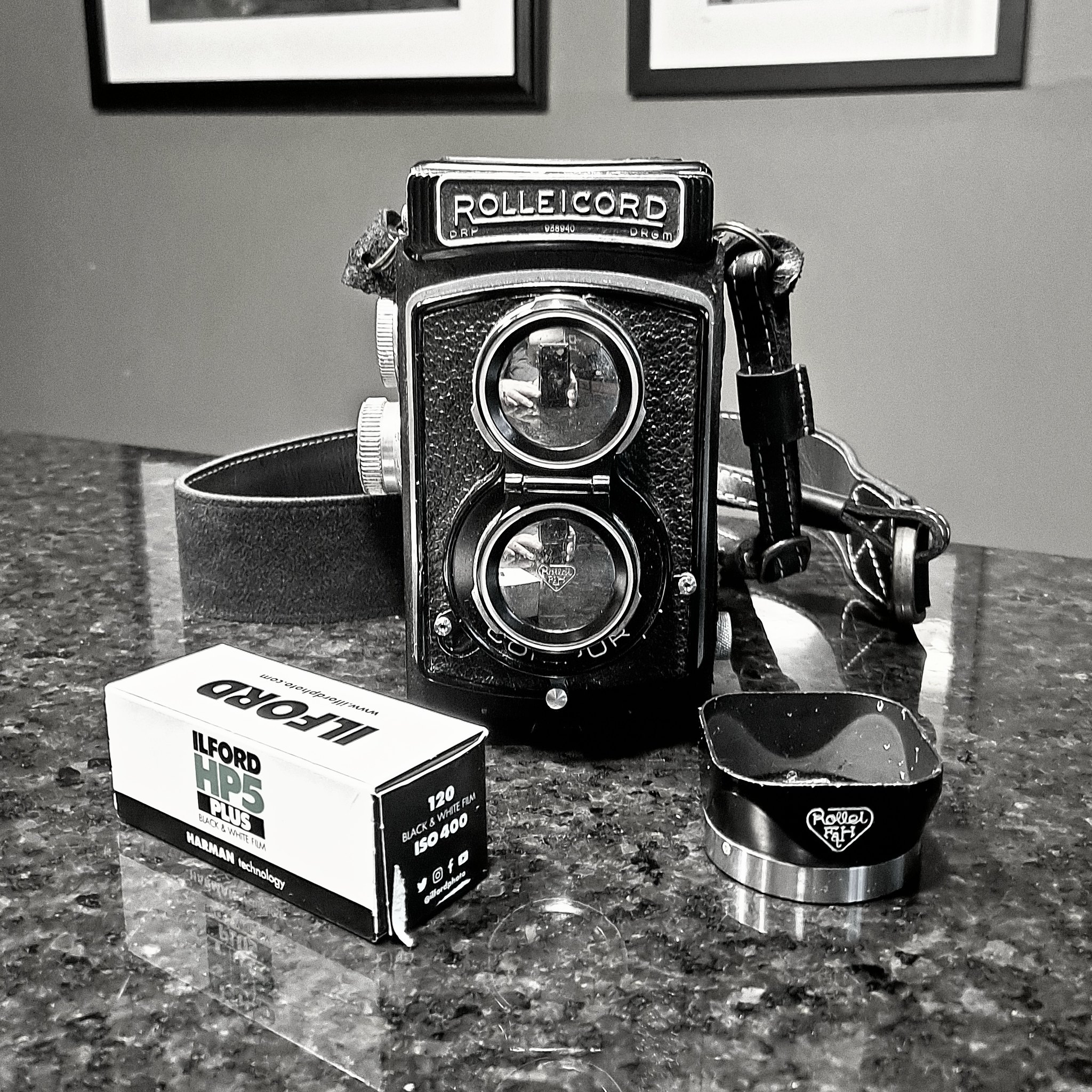

I also own several Rolleicords - Several I's and II's with the Zeiss Triotar "triplet" lenses in 3.5, 3.8, and 4.5 versions. I also have a Rolleicord III, a IV, and a V.
I find that compared to the Rolleiflexes, I tend to shoot my Rolleicords more. I'll grab the III, IV, or V if I am looking for something sharper and more clinical, especially when shooting close to wide open. If I want character and a vintage look, the early ones with the Triotar lenses are amazing.
Don't count out a Rolleicord as an option. There are a lot of them out there in great condition because they weren't "pro" cameras that were ridden hard and put away wet.
