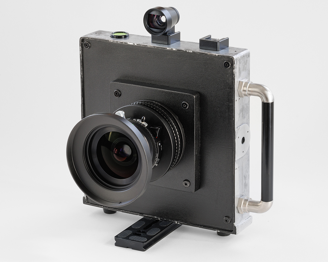

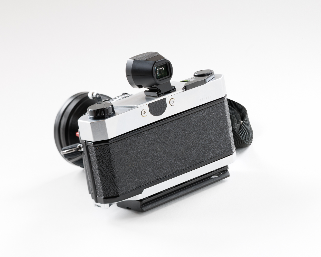

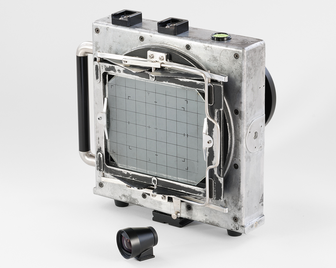

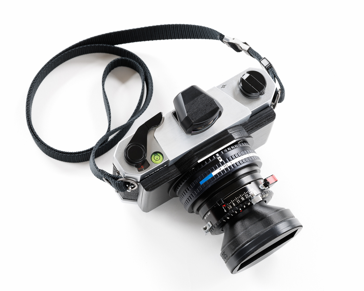

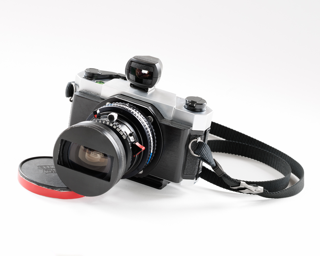

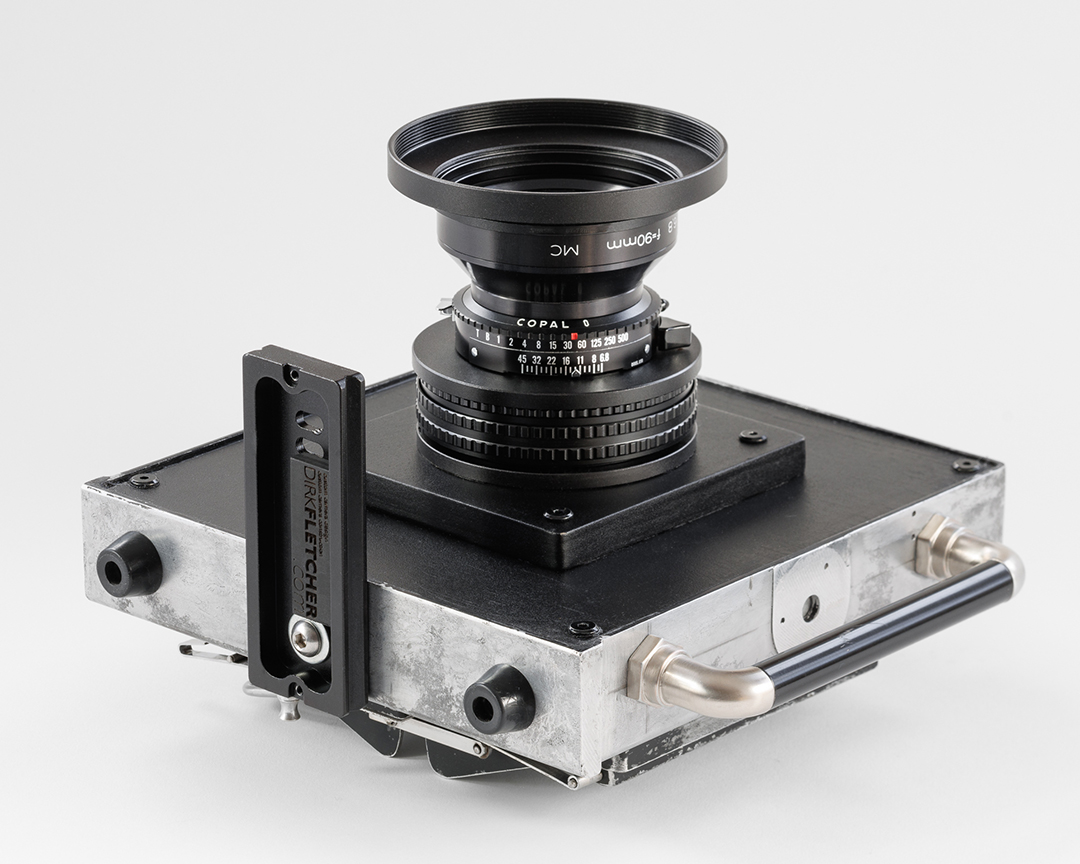

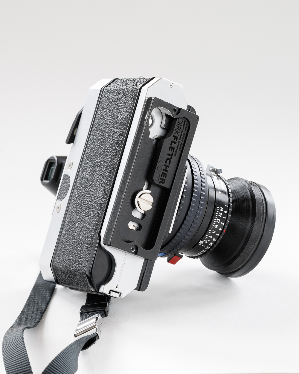

Finally finished a camera I started literally YEARS ago.The body is Konica Autoreflex A that is fitted with a helical mounted Zenzanon 40mm f/4 from the Bronica ETRs 645. This is the same lens that I used in the 'ZenzaBLAD', I sold off the Hasselblad SWC body that I had and kept the lens for this project. I'll post some test shots shortly.

Still 24x36 frame?

Might need a lens with more coverage if you make a wider one. BTW, how to you handle the film advance with nearly double frame size?

Was thinking maybe a 47mm SuperAngulon IF I did another. I feel like this one might be ample fun to shoot with though. It needs two advances per shot.
That makes sense. And the advance mechanism is either manually released or doesn't have a catch after 8 sprocket holes...
Thinking about things I could do with old M42 cameras with bad shutters. Don't know if they have room internally to expand the frame gate, though; I'd have to look when I'm home.

I’ll share some pics of the inside, I know there are some Nikons that also have a large presssure plate across the entire film back. Once you remove the shutter mechanism you can advance freely w/o any kind of safety or multiple exposure prevention.
Give me like a week or so and I’ll post the internal shots with a couple test shots.
View attachment 385364View attachment 385365View attachment 385362View attachment 385363
This looks really clean and well designed, and shows your usual high quality craftsmanship! And I look forward to the photos taken by this camera.

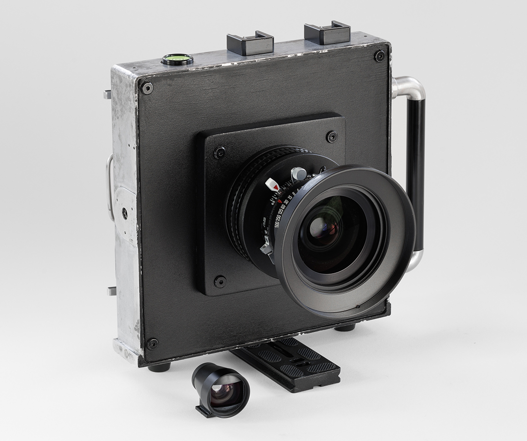

I started out thinking I was going to make 'Stormtrooper' 4x5 point and shoot with a blend of stark whites and blacks throughout mimicking the modern RED KOMODO 'Stormtrooper Edition' and years earlier, the chunky looking all white and black Mamiya 645 PRO TL. Once I started stripped away its 60 year old paint, it was obvious I was looking at finish much better than any kind of modern repaint I could dream up.
Very nice! What camera is the body from?

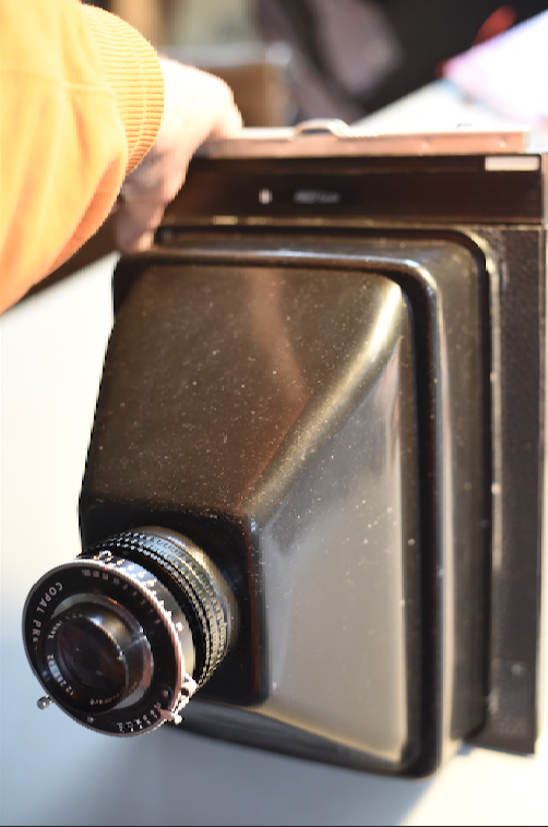

the start of a 8x10" lightweight.
build from a huge funnel, some plastic L frame
and for the moment a 150 in a helicoil, but it will be replaced for a 180mm asap.

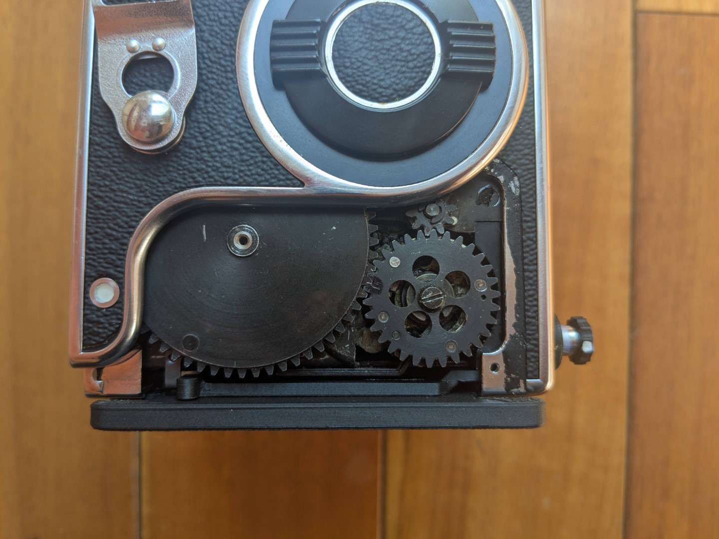

I revised my EL/M mod. The little pawl holding the winding gear kept breaking so I put the winding knob on a one-way bearing. I also added a proper shutter release button scavenged from a 35mm camera. It locks by a 1/4 turn.

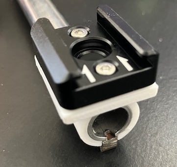

My latest little mod is a cold shoe mount for my little Galvin 2x3 monorail. The shoe is used to hold a bubble level to get the rail level. It will probably work for other things, but the level is the main thing. The rail is a tube with a rack attached for focus and preventing the rotation of the standards and tripod mount. This is a small 3D printed clip that friction fits the rail, and provides a platform for the cold shoe. The M 2.5mm screws go into heat-set sockets in the clip.
