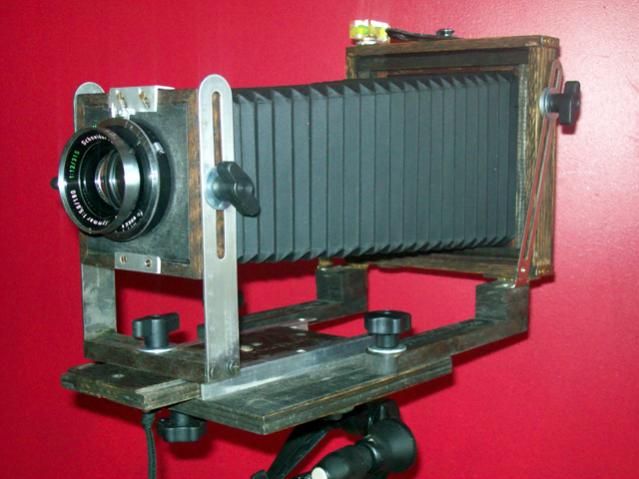

Here's a few pics of my first attempt at camera building. It actually came out ahead of my expectations:D It is made out of cherry and aluminum with a hacksaw, drill and router and a little powder coating done in my pottery kiln.
It has maximum extension of 33 inches. Back shift, base tilt, rise and swing and front base tilt, rise and axis tilt. Finished in danish oil. The dreaded "hacksaw" springs will be replaced if I get around to it. They seem to work fine for now. I paid for the bellows:smile:, I'm not there yet, but I will give bellow making a try on the next one. It fits easily in my f64 backpack. I am quite pleased all in all.
regards
Erik
Erik, that's incredible! Great work!
Jim, nice to see more pictures of yours. Love that walnut. I'm starting to get the camera-making fever again!:-D

Thanks Colin! This thread is what inspired me to give it a try. After seeing all the inventive people and their ideas, it was just a matter of "just do it" It is rather fun I think to use something home made, a little pride maybe and more connection to the act of shooting, at least in my case.

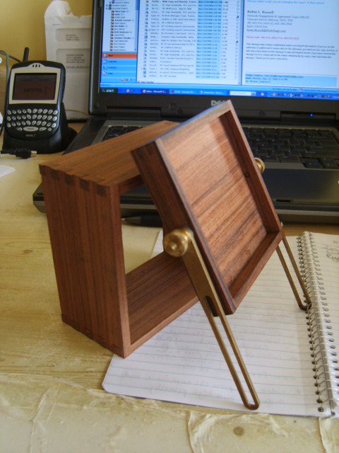

Here is my work in progress. It's eventually going to be a medium format view camera that can use either Mamiya RB or Graflex type 2x3 film backs. This is the front standard, and what will eventually become the rear standard. The box I made for the rear standard should have enough for maybe 2 or 3 cameras... I'm hoping anyway. I did the same with the front and have enough for a number of front standards. It's made from 1/4" thick 1/4 sawn bolivian rosewood that I realize is not a sustainable resource, but I have a very limited supply, and I will only be making 1 to 3 cameras. I also have some Gabon Ebony I am tinkering with as well as regular walnut. The rear standard has 1/4 inch box joints, and the front has 1/8 finger joints. I apologize for the poor quality of the digital capture, it's what I can usually expect from digital :smile:
I hope to post updates as things progress.

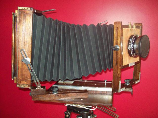

Here they are folks!! 5x4 and an 8x10
Thanks for all the ideas this thread has given me. I know they are rough and ready but I am really into getting out there and making photographs. This is the best way for me to try larger formats without braking the student bank..I am hooked. My next camera will be either a 8x10 Century Universal Lookalike or a 7x17 Tailboard camera probably both:D.
My first 8x10 made with G-Claron 210mm F32 1 sec ERA 100 ISO film HC110 Dil B the scanner could not handle highlights.
Keep up the good work all :D

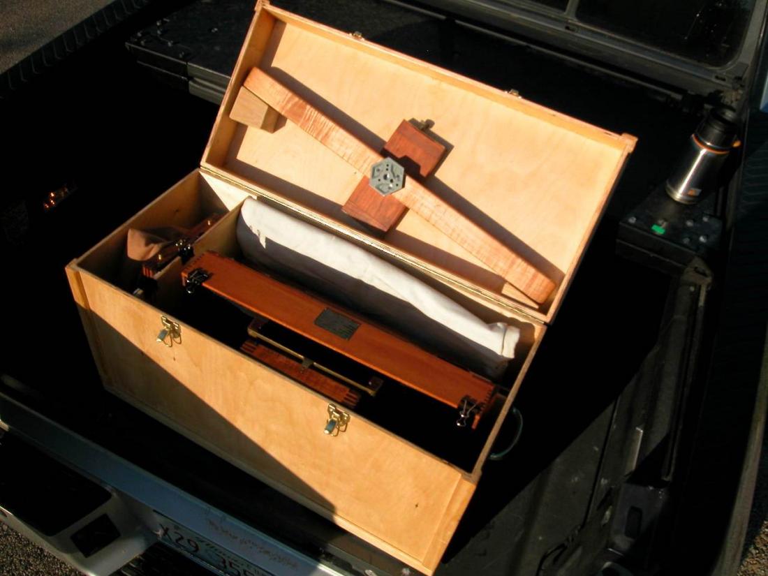

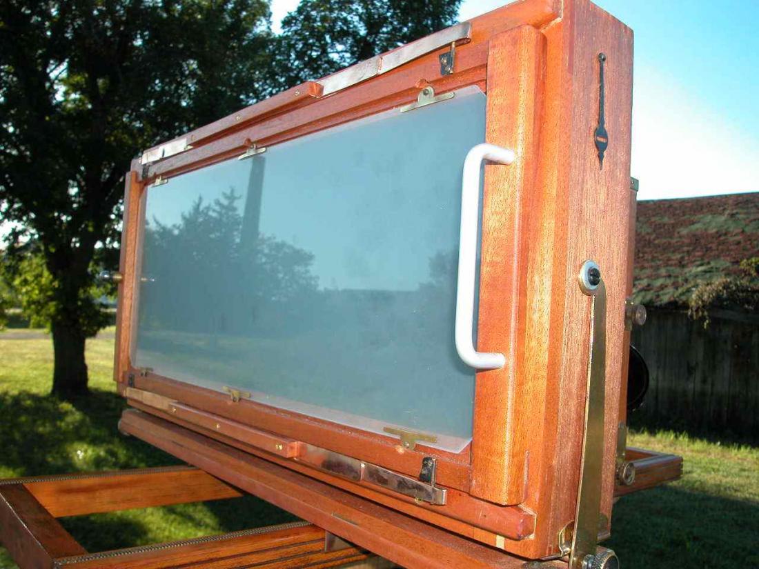

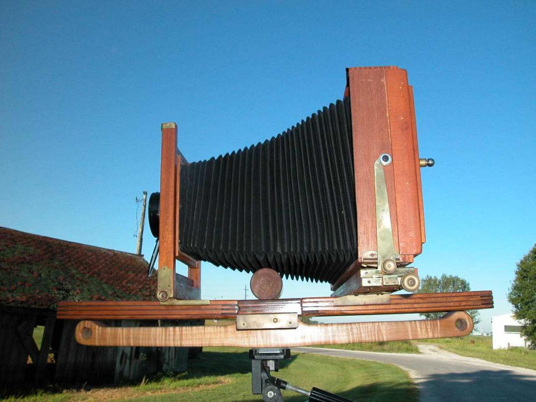

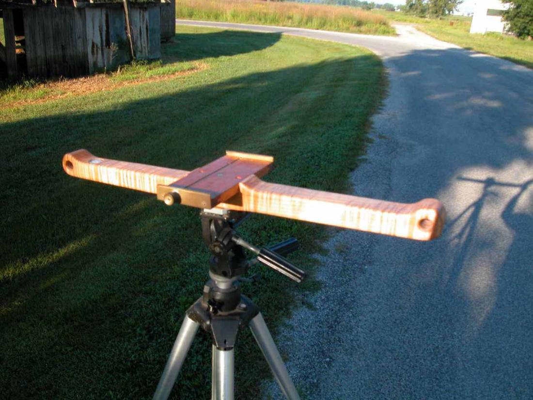

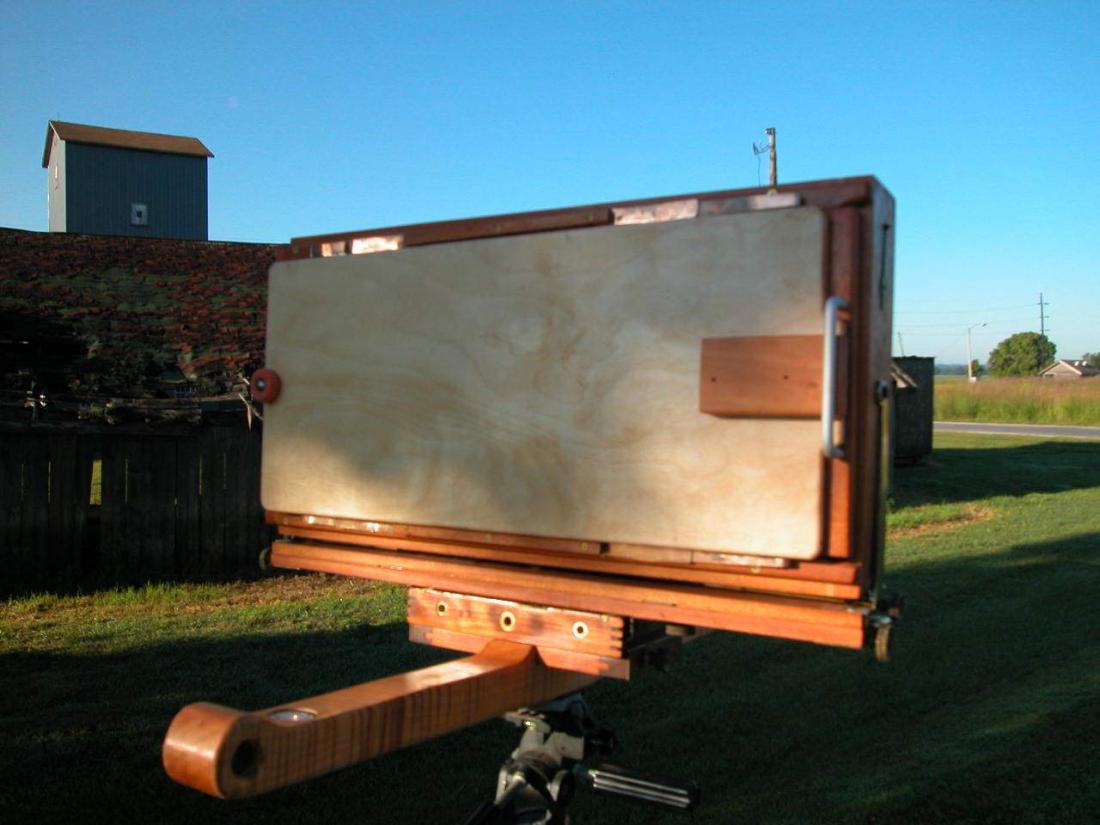

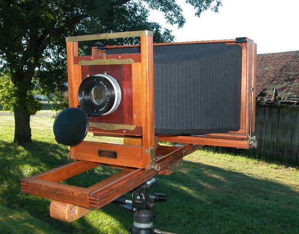

Here's my 8x20 made from (2) Kodak D2's. One was an incomplete basket case. The other was in need of serious restoration.
I made a crate to haul it around in as well. It can hold (3) filmholders, extension rail, camera, extra lens(es) and a darkcloth and meter.
I made a strut to be part of the original tripod adapter. The strut keeps the base and the extension rail and front rail in a plane. No sagging. Important to me as a I have a 600mm Apo Ronar waiting to be adapted to a shutter.
Here's also a side view showing the complete assemble. You can see my cylindrical bellows support. It rolls as you focus in/out.
The back is really all I made. It's from Cuban Mahogany finished with tung oil.
The GG protector attachment point were built into the back.
The underside shots show the construction. All the D2 movements are preserved.
This outing was a trial run. I didn't even have 8x20 film, so I butted together (2) 8x10 sheets in the holders.
John

John, I love the fact that you took a great camera set up and made an 8x20 out of it. Congratulations on figuring this out. The work looks very well done. I like what you did with the back of the camera. Isn't it fun to build the back? I know mine took quite a while. How long did it take you to build this beauty? I see that the back standard slides on the track instead of running on the gears. Did you build the bellows or have them made for you? Excellent work! Now get some 8x20 film and have fun!

John, very nice job! Great idea on making the camera secure at extension.Looks rock solid. It looks to me like the back will focus by friction instead of gears? Did you make your own bellows? It is great to see a couple of great cameras re-born as 8x20's.
This is interesting as I have some RB 67 backs. I would like to try this.
Do you have any plans you could share or is it a 'work it out as you build it' type of project?

No, front & back focus is all done thru the gear tracks. All adjustments and controls are identical in operation to a Kodak 2D. The bellows was bought from ebay. I've been collecting parts for about 2 years. Once I got the film holders (S&S - used) this summer I started the construction. Took about a month in my spare time.
John

Steve, it is a figure it out as I go type project unfortunately. I will send out plans afterwards, but at the rate this is going.... Won't be for a wh
This is interesting as I have some RB ile as I have made no prgress other than what you see in the photos. I do have a ground glass now and will figure on the design of the back as first order of duty as it is the most challenging aspect for me.

John, I guess what threw me off was seeing the gears on the back not meshing with anything. Did you put others on the back shaft? Regardless nice going. I'll bet it was hard to be patient. Nice to have it finished.
Jim

Since I had two sets of everything (controls), I simply used the 2nd set of shafts with the gears to extend the shaft out. I wasted the gear, but doing that expedited the job. There is another set of gears inboard that line up with the gear track in the extension.
John
