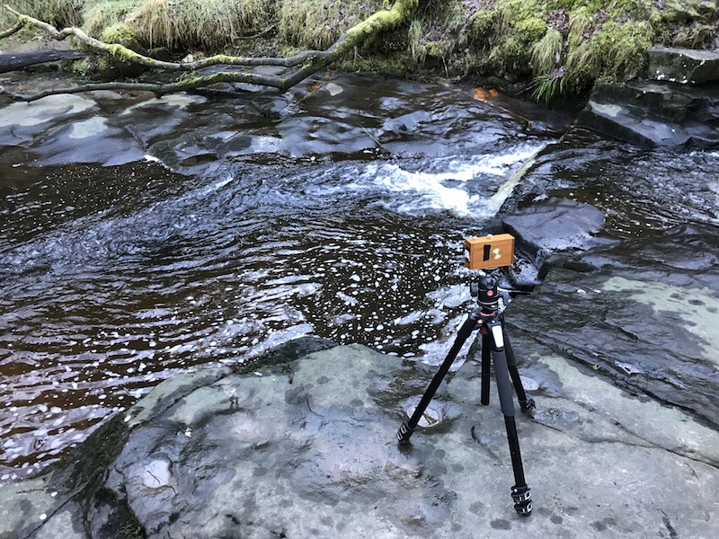

I totally forgot to take any photos of my setup yesterday but this is exactly the same set up that I used but from two years ago. Harman Titan 8x10 and a Berlebach tripod. The only difference this year is that I added a Sekonic L-208 Twinmate light meter which was mounted on the Titans cold shoe.

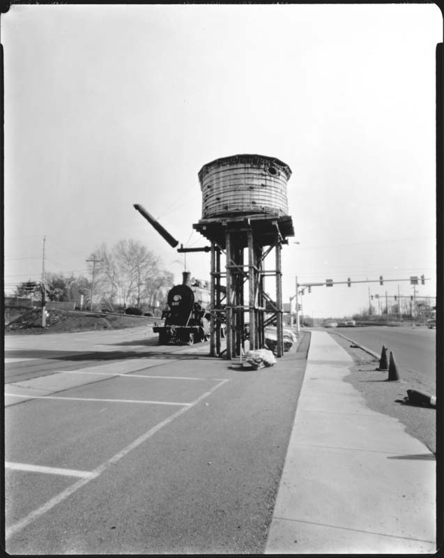

Thence a circuitous wandering brought me to Temple, and what used to be the Reading RR "Outer Station," now the southern terminal for some tourist line activity of the Reading, Blue Mountain & Northern, running over former Reading RR right-of-way.
One of four:

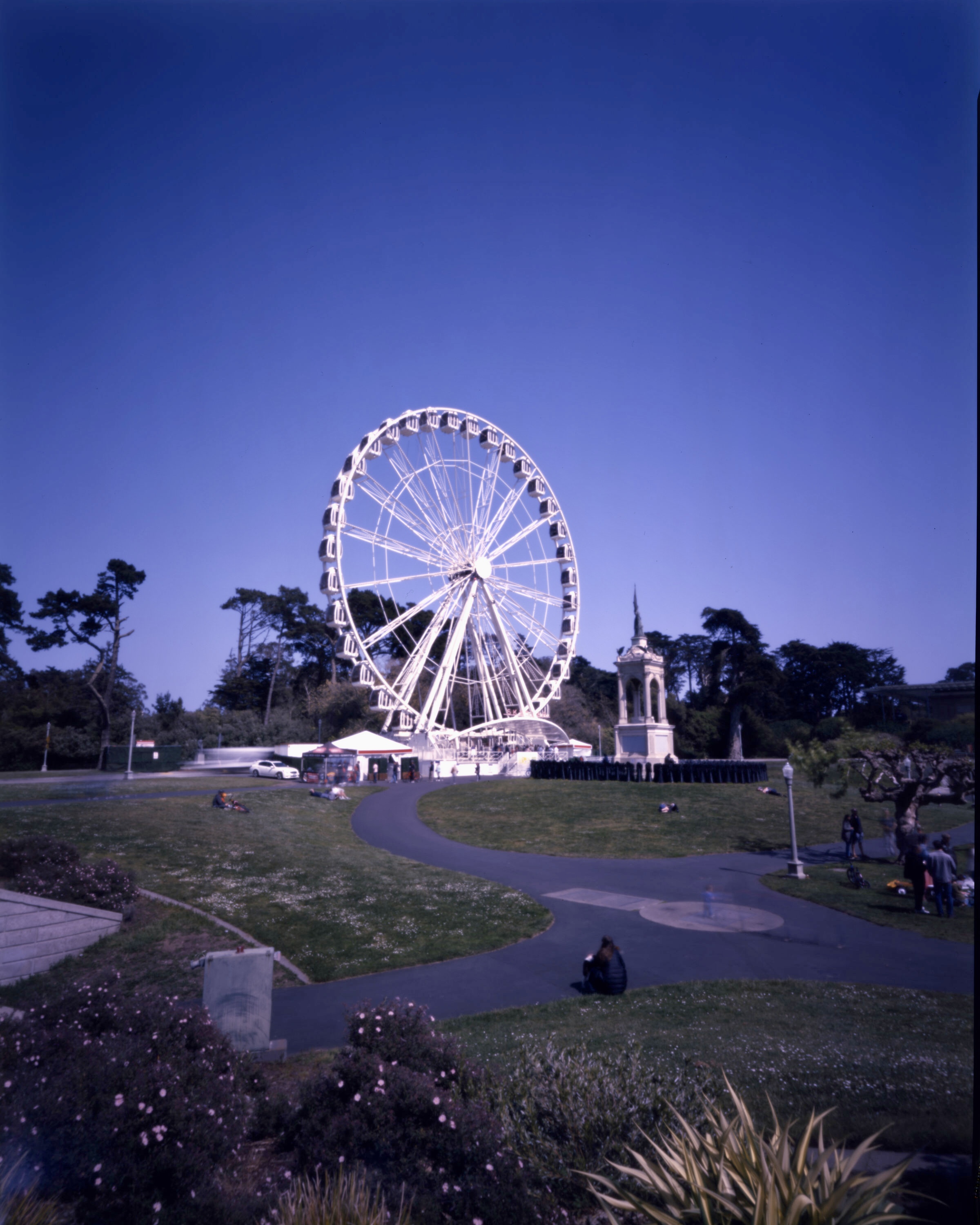

I managed to scan one of my images. This is from Golden Gate Park here in San Francisco. Harman Titan 8x10, Fuji Astia.

Observed an interesting phenomenon that I believe is related to the spectral sensitivity of the Fuji HR-T x-ray film I was using.
Here is another view of the locomotive in the shot above, with full sun on the tender ...
First in color via iPhone:
Then via image on HR-T:
(Besides being not aimed well ...) And it may have been somewhat over exposed and overdeveloped ... But the lettering and logo is just about invisible! My theory is the film sensitivity to green, and maybe blue-green, lightened the background relative to the weathered/faded yellow-ish printing. (That's my story and I'm sticking to it!) In any event, it's the first time in about 6 or 7 years of using the stuff that I believe I've seen an effect that obvious.

Ned, the Astia was a lucky score of Craigslist, unknown history and storage so it seemed perfect for pinhole. I had the film lab processed so 5 images only cost $50 :surprised:. It was kind of funny, when I picked up the film the lab commented that they we’re impressed at how nice they turned out, as they were thinking that since it was pinhole they would be crap. Totally made my day. The reality is that I got 2 nice exposures and 3 that are a little underexposed. I’ll try and get the rest scanned and posted in the next few days.
