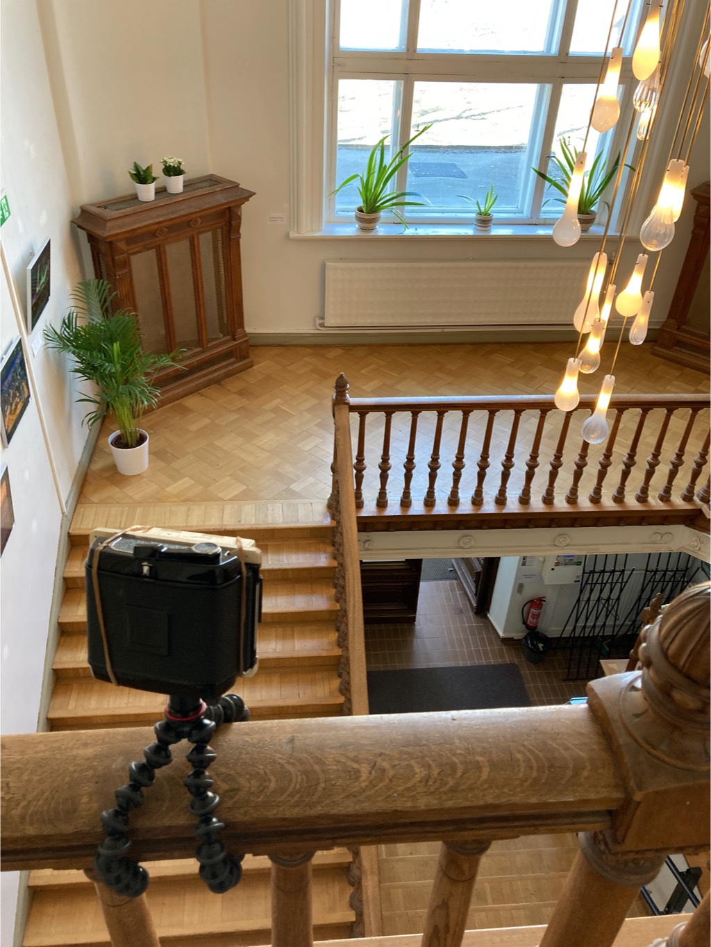

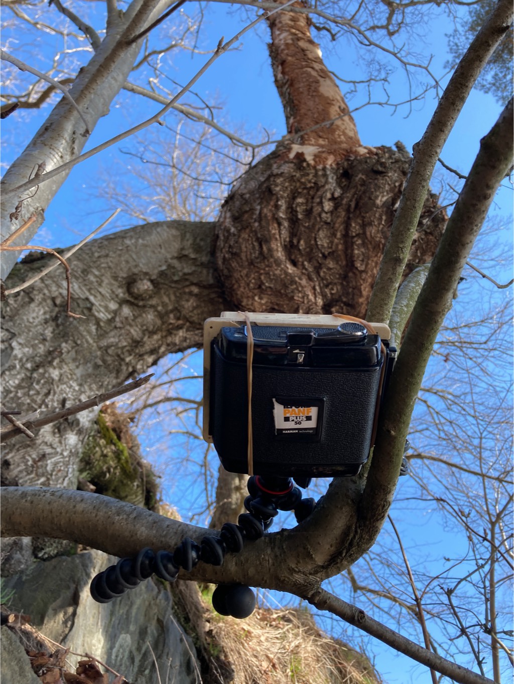

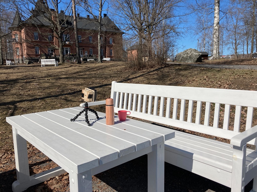

I'm using same camera I built for last years pinhole day (I think I started building 2 days before, maybe?) http://tulos.tuu.fi/?p=893
Beautiful pinhole day here. Enjoying spring, sunshine and some tea outside!
