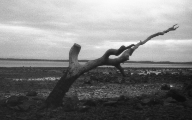

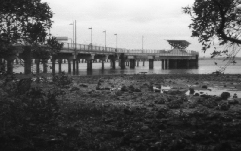

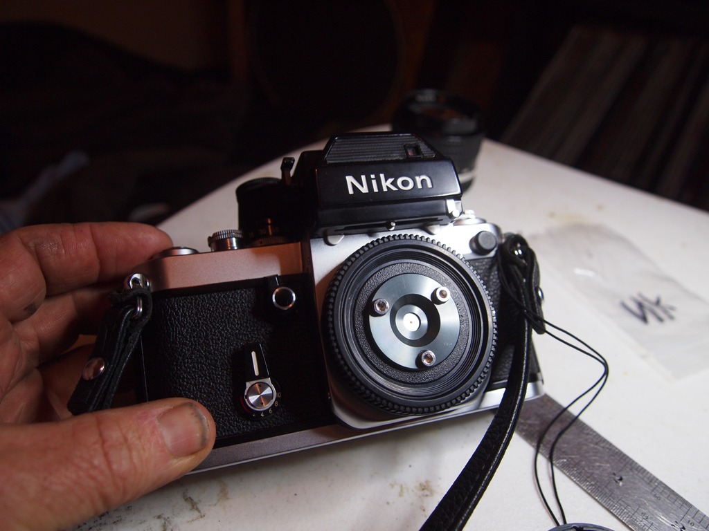

Hi picked up a pinhole body cap from ebay to have a play.
Its 0.3mm hole. Was suited for Nikon DSLR, so I packed it out a little to better suit 35mm. Focal length is around 50mm, which makes it around f170.
FP4 set at 80 ISO. D-76 develop, scan.
Anyhow it seems to work.

View attachment 164386 View attachment 164387 View attachment 164388 View attachment 164389 View attachment 164390 View attachment 164391
I use one of those myself.Mine has a 0.35mm hole made by a #15.
Yes the f2 is a great camera, needed something a little more compact and portable than my Mamiya z67.
I was surprised by the results.....that I didnt completely stuff it up.

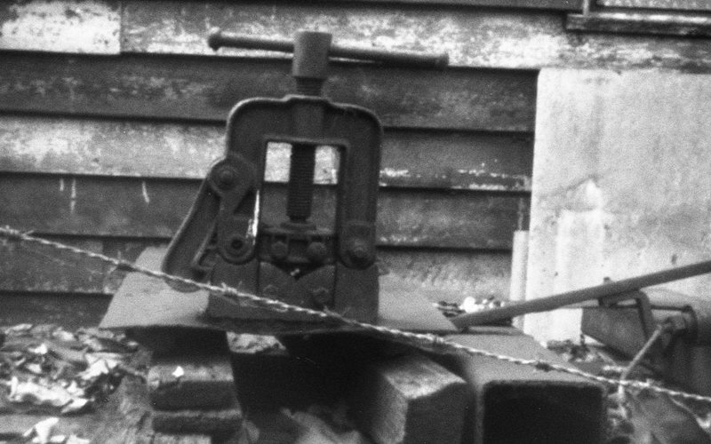

Was using a Sekonic light meter and a chart to get the shutter speed (flashmate only goes to 96). The vice was 8 mins, the 1st jetty was about 12 secs.....and a very sturdy tripod.
I have a similar pin hole body cap that I use on my Nikon N75 and F100. It works well.
An elegant job and some quite respectable results. I made a body cap pinhole for my Bronica SQ-A, but that had the added complexity of a shutter, since the SQ series has the shutter in the lenses. It works!
I like the tree, and the pipe clamp catches my eye for Olde Rust. :whistling:
I have one for my Nikon and one for my Mamiya RB 67. I should find them and give them away since I never use them anymore

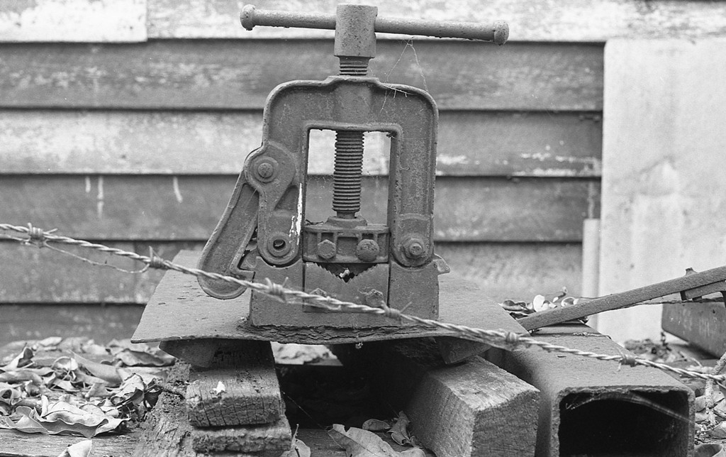

The pipe vise using 50mm nikkor lens at f16 for comparison.
The pin hole is slightly wider around 40mm I reckon.
Pinhole has its uses, just got to work out what.

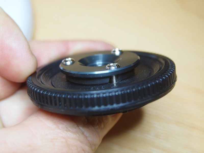

"so I packed it out a little to better suit 35mm" May I ask, what did you do exactly ? thanks.
The nikon camera is 46mm from the mounting face to the film. Going by the calculator it should be around 50mm for that sized hole. So I just used a rubber washer I had to get it closer. Havent experimented, but seems to work. Not sure if there is any difference.

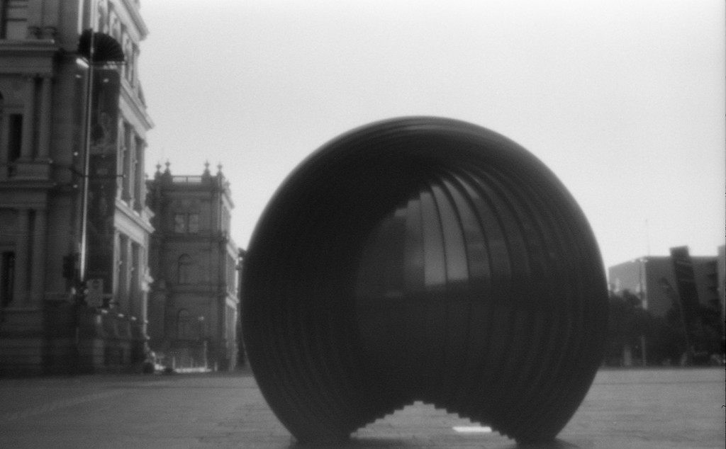

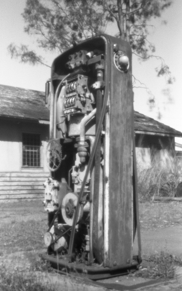

I moved the pinhole to inside the body cap, missing the mirror, to round 40mm focal length to give a wider image.
A long exposure is one way of removing people from a shot.
