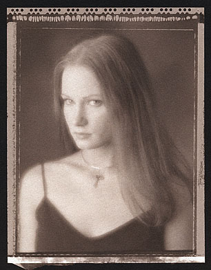

I am looking for a lens for portrait (head and shoulder) that could fit my 5x7 canham camera.
I love the woman portrait style that you could see in the Dead Link Removed (see attachment), unfortunately this lens are too expensive, too rare and without shutter…
Maybe someone of you could propose me a lens that could produce the "same" estethic style for close portrait, knowing that it should be adaptable for my camera ?

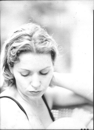

Can you post some pics taken with your Veritar? Here's one from the Verito:
And a few from the 10" Veritar I owned:
hi joe
here are a few from the veritar ...
the last one is the 10"
and the other 2
are from a 14"
they were hand processed
and printed on paper before i scanned them

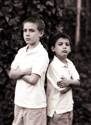

Below is one done with the front of a Gundlach projector lens. Original lens was 6 inch. Front element alone was about 9" focus. This was done on 4X5. Still not as soft as the example shown I suppose.

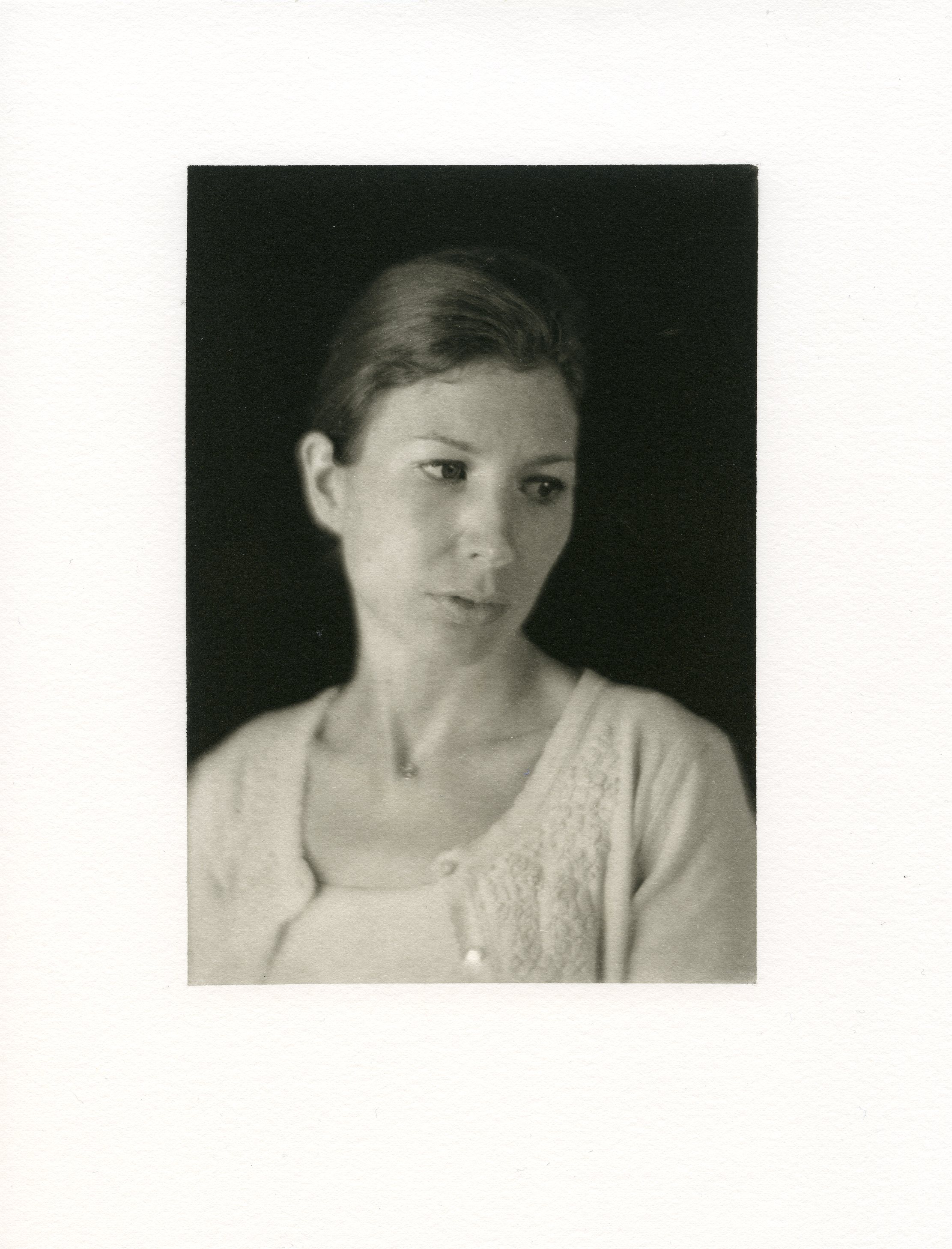

Hello Everybody (one year later),
My kodak 305 portrait lens fit my canham 5x7. Impossible n'est pas français.
Here a scan of a portrait done with my canham (palladium & platinum process ; Arches paper)
