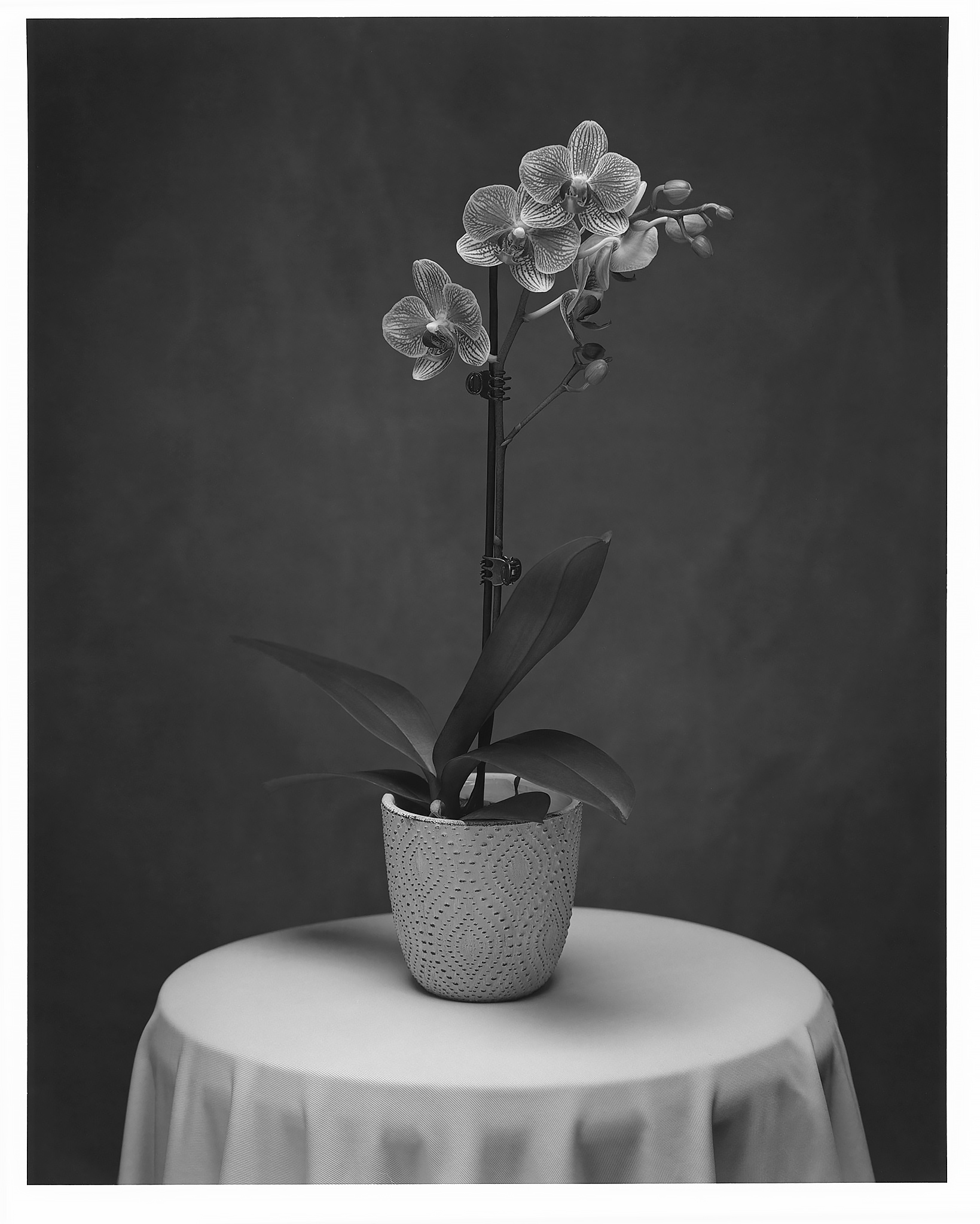

@Timberwolf , It's good to have a regimen, but if it becomes too clinical, a person can become just a scientist, in a lab coat, in a dark room. You are not writing procedural code, photography is not an exact science. I'm guessing you just got into photography just as this plan-demic was in full lockdown mode. That's ok too. Through ways the hypnosis thingy and roll up your sleeves and just have fun. I crafted a shot just today with my 5x4. I started at 1pm and just finished up at about 10pm tonight. Made a total of 5 prints on MGRC, MGFB warn tone and MGFB semi matt. And they came out better than I expected. This is a scanned print.
