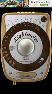

How do I use it? Look at the picture I attached, it was done in my room, and after I inserted the numbers on my dslr to see what it's gonna look like, I just see a black screen as I already predicted it's gonna be like that. How does the app work? Thanks
Did it on my dslr first so that I won't mess up the whole roll
The way I look at it:
250 = shutter speed
ISO 100 (of course)
EV = exposure value = F stop

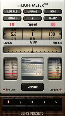

I love MyLightMeterPro. Has everything I need and has never given a bad reading. Well, if I had to nitpick I'd love if it had more exposure compensation built in so I wouldn't have to use a separate app for my 10-stop filter. This is for iPhone so I'm not sure about Android.

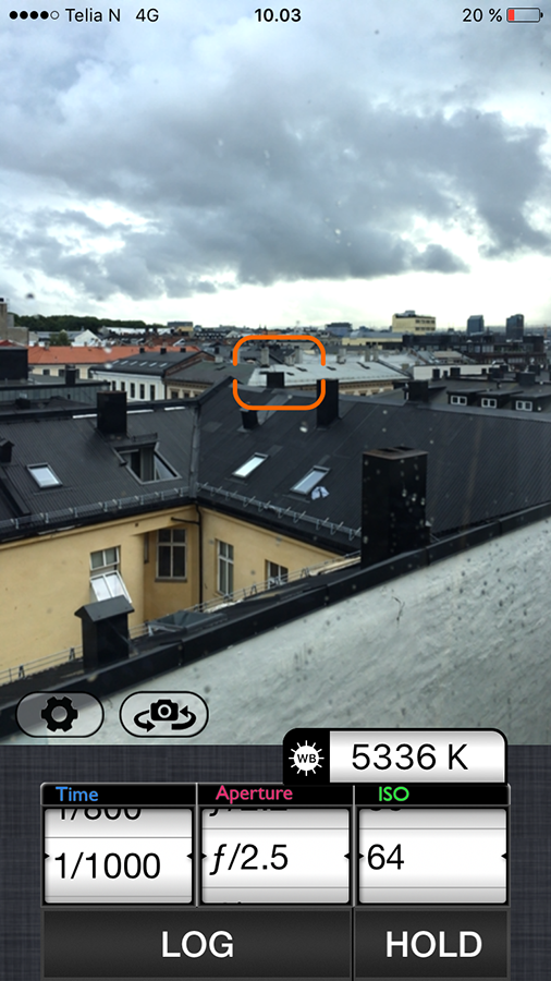

Easy as pie.View attachment 161332
That meter reading seems off by about at least two stops if you are going by the captured live image. There is no way the buildings are going to look like that at 1/1000 f 2.5 ISO 64 in that lighting.
It's a screenshot from the iPhone, but may be a bad example, as you can see from the shutter-speed, it hasn't settled yet, i may have shifted the metering from the sky to the houses while I was taking the screendump (it involves pressing two buttons at once).
But, instead of complaining about rather mundane things, why don't you download the app (it's free) and take it for a spin, comparing it to your own meters/cameras?
Akshully I posted the example of unreliable exposure metering using this app with screen shot on the previous page, and you just verified the same. The metering did not shift when you took the screen shot, it updates continuously. I know, I use(d) it. It works most of the time, but most of the time is not good enough for me.
Thank you for confirming my findings.
