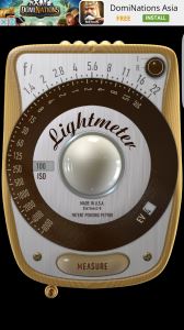

How do I use it? Look at the picture I attached, it was done in my room, and after I inserted the numbers on my dslr to see what it's gonna look like, I just see a black screen as I already predicted it's gonna be like that. How does the app work? Thanks
Did it on my dslr first so that I won't mess up the whole roll
The way I look at it:
250 = shutter speed
ISO 100 (of course)
EV = exposure value = F stop
Just downloaded the same app. Set the ISO. Tap the little red button at the top right. What you are pointing your phone at will appear in the white dome in the middle of the meter. You can zoom in and out with the little slider sticking out at the bottom. Zoom in on the area you want to measure and press the measure button. It'll make a shutter clicking sound, the dial will move a bit giving you you shutter/aperture combos. Simple.
Ahh so you have to take a pic no wonder. Thanks :smile:

Also, the red button at the top right corner switches from incident (I) to reflected (R) light reading. The reflected light measure is done through the phone camera, but the incident light measure is done through the sensor that adjusts the screen intensity, so the smart phone must have that functionality.
Yep I know!

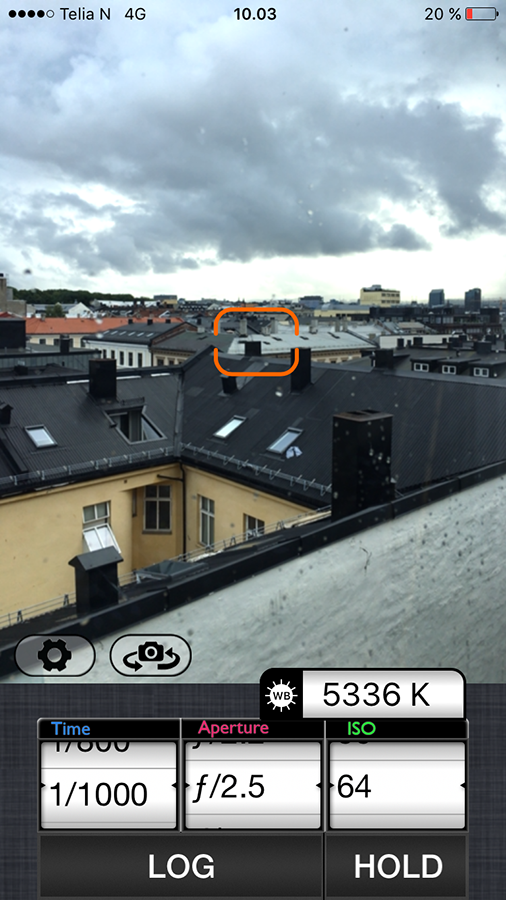

I have found the Pocket Light meter to be very unreliable so I have stopped using it.
Here, the correct exposure is 1/60 at f4 at ISO 50. The app shows 1/1500 at f4. Missed by over 4 stops!... This is in open shade.
That is weird, you are aware that the pocket-lightmeter operates as a reflective reading and not incident metering?
Also you foot seems to be fairly close to the metering area, I think it's more center-weighted than sharply cut, as indicated by the borders of the metering area.
I've googled around a lot to see, and I have yet to find any discrepancies that are more than +-1 EV with this app. (on an iPhone)
What phone are you using, maybe it's related to that?

1/ Yes, I am aware as to how it works
2/ If it read off my foot, the reading would still be over 4 stops off.
3/ Iphone 4s
Anyway, if others are happy with it, good for them. I've seen it give lousy readings occasionally which means I cannot trust it. So I don't use it.
I notice your illustration is showing 6176 Kelvin. I am under the impression that most daylight color films are balanced for 5000 kelvin. Could that be the difference you are finding? My version doesn't show white balance or kelvin reading. It may be an older version and my tests against my spot meters and ultra pro are as others have reported are very close.
http://www.jeffreyglasser.com/
The app uses the AWB of the camera phone so it will naturally warm up the image if used in the shade. As in this instance. You can turn it off in the settings.
Daylight colour film used in the shade will have cool tones etc etc etc
