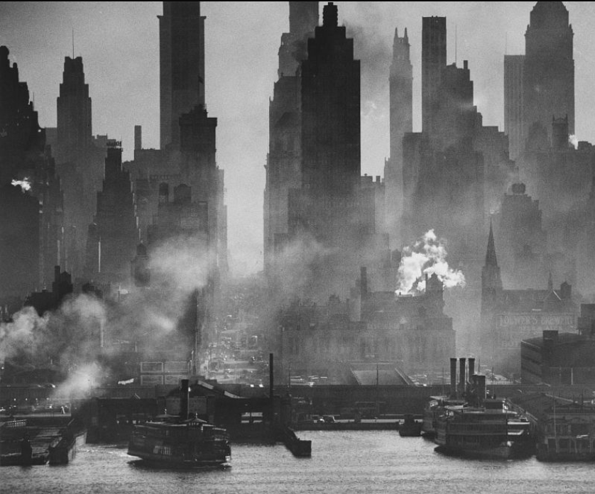

I think there's a bit of confusion about "perspective". Most people will take that word to mean the point-of-view one has upon a scene. That won't change with a change of lens. If you don't change your position, a longer lens will pretty much just crop the view and not change the apparent relation of things to each other.
Andreas Feininger used a very long lens from a great distance to get this shot of the Hudson River:
specifically to preserve what he thought was the correct relation between the size of the ships and the buildings looming in the background. If he wanted to get a photo of those ships with a shorter lens, from a closer distance, he would have lost that looming background and established an apparent greater distance between the foreground and background. The point here is that this isn't really a change in perspective as much as it's a compression of the scene.
In the examples offered above by @wiltw, the scene looks more or less identical in terms of compression when the wide angle image is cropped to match the photo using the longer lens. That amount of compression would not match if the camera was moved such that the main subject (that central tree) took up the same amount of space in the resulting image. The longer lens would show more compression of the background.
