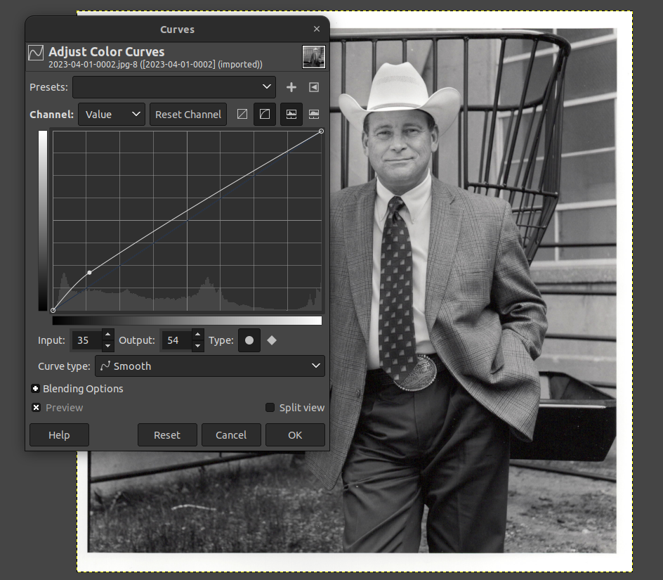

This comment really intrigued me. My digital editing skills are very basic, so please forgive me if I am asking the wrong question, but is that what you mean by adding more toe?
Less highlight contrast, which will as a side effect lighten the highlights - the curve control point would be in the upper right. On the negative that part of the curve would be the shoulder - the denser part of the negative. That lost contrast has to be moved somewhere so the midtone or shadow contrast would increase unless you unpegged the black or white point. I try to stay away from tone control in B&W Photoshop. I find it easier in the darkroom, somehow, as there is less control and thus less to drive me batty.
Thinking more about it, one way to get the same effect would be by controlling the lighting when the photo was taken by bouncing light to the subject's face and shirt. Photoflex (?) make little collapsible light reflectors - the same job can be done by those sunscreens for use behind a car's windshield. Also dodging the face shadow and shirt would work. A dodging mask gives fine control in Photoshop.
Making a print that is 0.2 stops or so lighter might make get the silver print close to the scanned result all on its own.
Whatever technique your scanning firm used they did a very good job of it.
I'm not a Photoshop maven, far from it, so don't put too much weight in my words.
