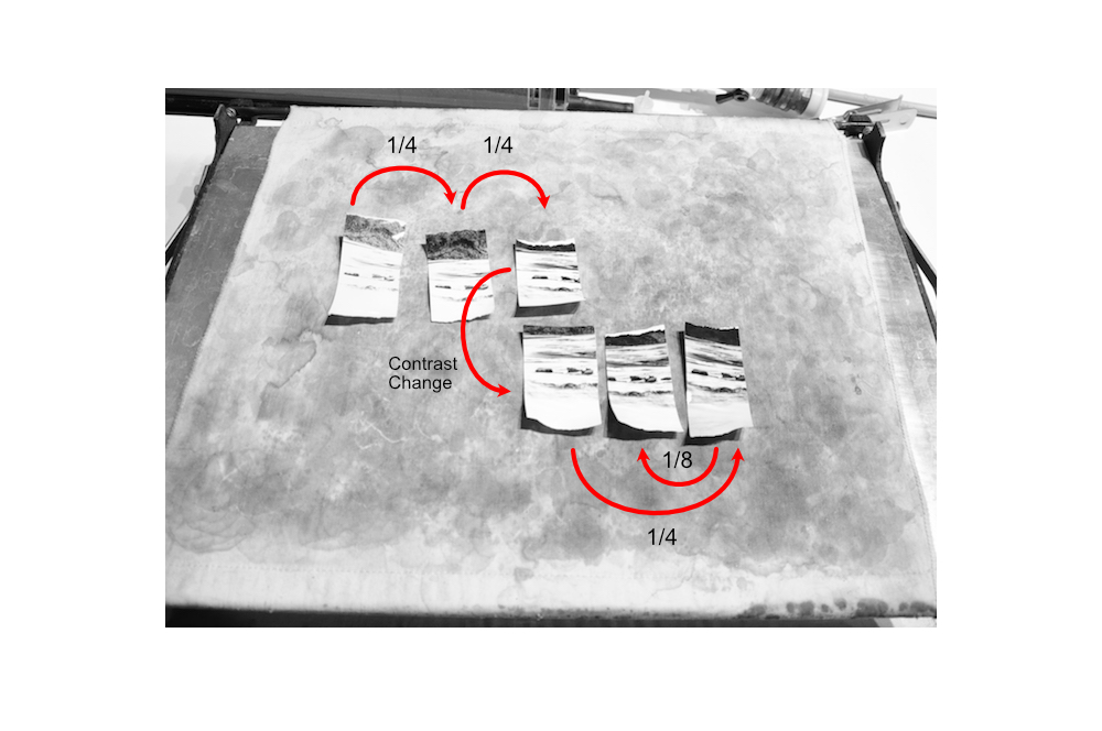

Some things that I do:
1) Evaluate the negatives on a light table with a good loupe (don't waste time making proof sheets when you could be making fine prints)
2) Based on that, pick ones that look good for printing. For example in the stacks shown there are only a few.
3) Work up each image systematically with little test prints before using a full sheet.
4) Print small.
4) Be prepared to dodge or burn a little on each print.

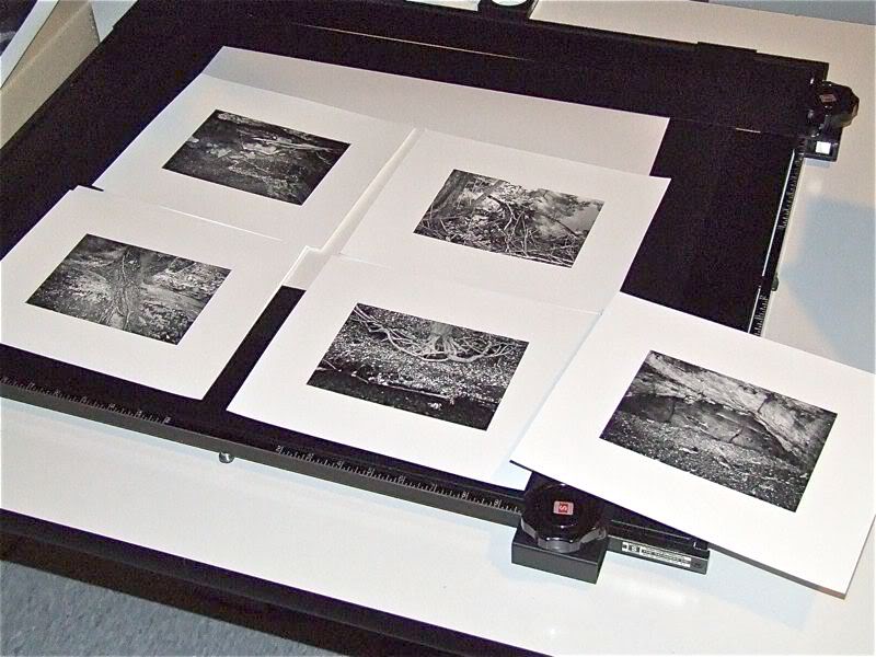

This is an example of an easy to print case. This image just stood out on the negative sheet. It already was darker in the corners from the lens light fall off. There was nothing to dodge or burn, the image was in focus and properly exposed. After making a few tiny test prints, this print was the first and only one needed of this negative.
