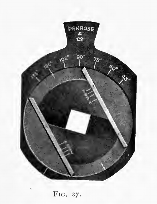

The Penrose system allows to rotate the square to provide an squared blur in the desired direction, to match the rulling of the screen, without having to rotate the lens. This "iris" has two blades... In that way a squared blur can be generated. The effect is that a screen made of dots (geometrically arranged ) provides a nicer feel in the result.

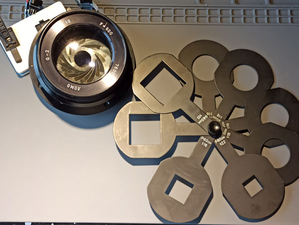

This is my LOMO O-2 600, it has a very circular iris, and also a set of different square apertures and a set of equal circular apertures. Perhaps this is also intended to glue on them gelatin filters (or other kind) to cancel CA or to make separations, if not going to place filters on the circular apertures then the repeated circular apertures would not make sense, while also having an iris, a very circular one with a lot of blades.
(Under the LOMO an ATMEL ICE is seen, this is for example to debug the Marlin firmware controlling 3D printers. The ICE survived :smile:)

The various other aperture shapes supplied as Waterhouse stops with the lenses intended for halftone/ halftone separation work have nothing to do with fall-off correction. Instead they are there to produce specific dot shapes demanded by various printing processes. The slot in the lens has screen angles marked so you can shoot the correct angles for making CMYK separations using traditional halftone ('AM screening') - as opposed to stochastic ('FM screening') screens. See pg. 12 in this Getty document for a clear illustration.
The narrow angle of view of many of the traditional dialyte 'Apo' lenses is not just demarcating their field of apochromatic correction, but also their area of flattest possible field and zero (or near zero) fall-off and distortion. Any distortion, field curvature or fall-off are very bad news when you are trying to make an absolutely even halftone dot from edge to edge on your film - and in the bigger picture of pre-press, absolute sharpness mattered less than freedom from those aberrations.
