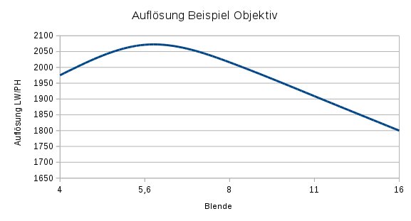

Ähmm sorry to ASK again - just in short : Sweetspot more in direction of f4 than near 5.6?
with regards
PS : Sweetspot isn't much correct but you know what I mean! Or do you just mixed it?
(400lp/5,6....250lp/4.0). at f 11 I would not wonder about 250lp [ I just found the right Diagramm - to avoid missunderstanding from grammar....:cry::cry: so this has changed due to correction ASPH/APO?:
with regards
It depends on the (35mm) lens: Some excellent lenses - especially some of the modern lenses with max. apertures of 1.2 or 1.4 - have their "sweet spot" = best performance already at f4.
But most prime lenses (and high quality zooms with max. aperture of f2.8) have their "sweet spot" at f5.6.
Most excellent primes have decreasing performance from f8 onwards (including f8) because of diffraction.
Amateur zooms with max. aperture of 3.5 / 4.5 often have their sweet spot at f8 (but on a lower level compared to primes).
All the medium format lenses with max. aperture of 2.8 I've tested so far have their sweet spot also at f5.6. One (Mamiya Sekor C 2.8/55) has equal performance at f5.6 and f8.
Best regards,
Henning
