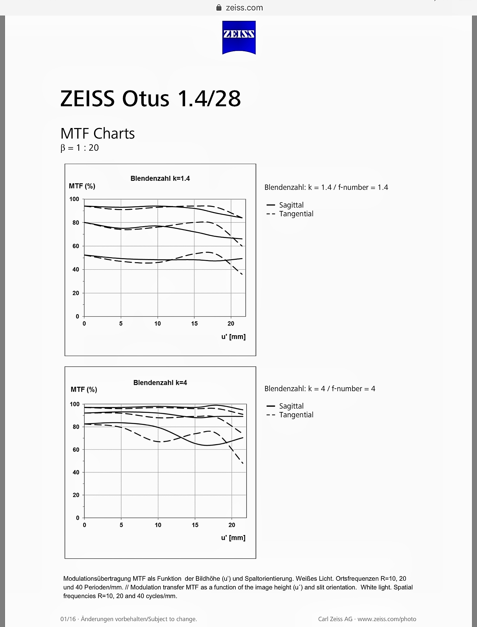

Hello everybody,
The MTF of Leica APO Summicron 50mm Asph(range finder camera lens), was the best MTF I’ve ever seen. Reviews confirmed its supremacy.
No wonder, through the whole history of lens making, the range finder lenses are usually outperform their counterparts from reflex cameras.
This lens is designed APO & Asph corrected.
Until recently when I came across the MTF of the Zeiss Otus 28mm/1.4 ZF.2, a retrofocus(for SLRs) lens that outperform any and all range finder lenses at least theoretically(MTF) at much lower price than the Leicas specially if you have already a decent SLR and no need to pay even much for a Leica M camera.
The MTF of Leica-M 28mm Summicron and Summilux(true wide angle, not retrofocus, from one of the best manufacturers) are not as good as the APO Summicron 50mm Asph, leave alone the retrofocus Zeiss Otus 1.4/28mm.
Appreciate any input about how the Otus(or any Otus) perform on real film and print.
Thanks.
MTF of all Zeiss Otus lenses and best performers from Milvus, has been added in post#19. Added on 3 April 2019.

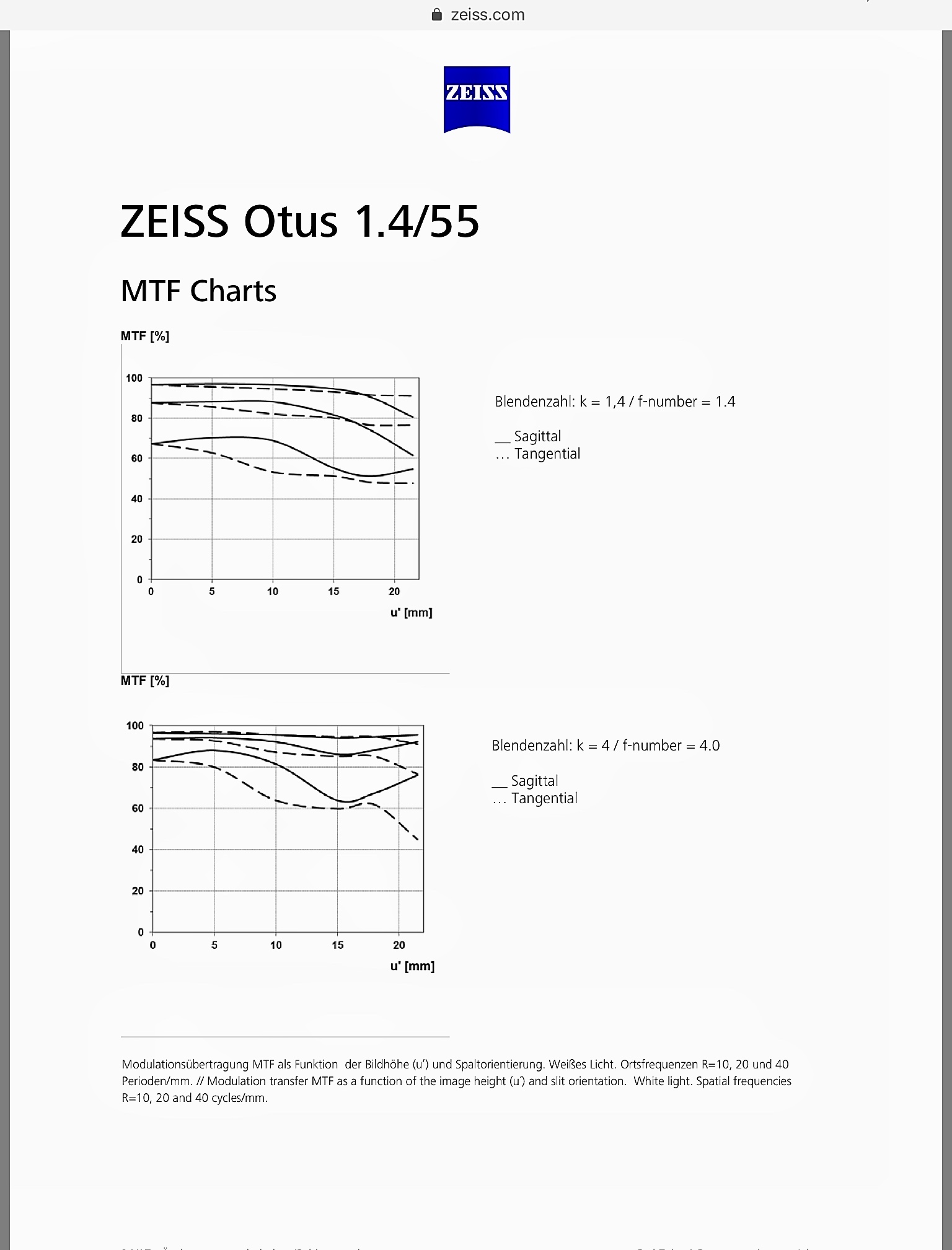

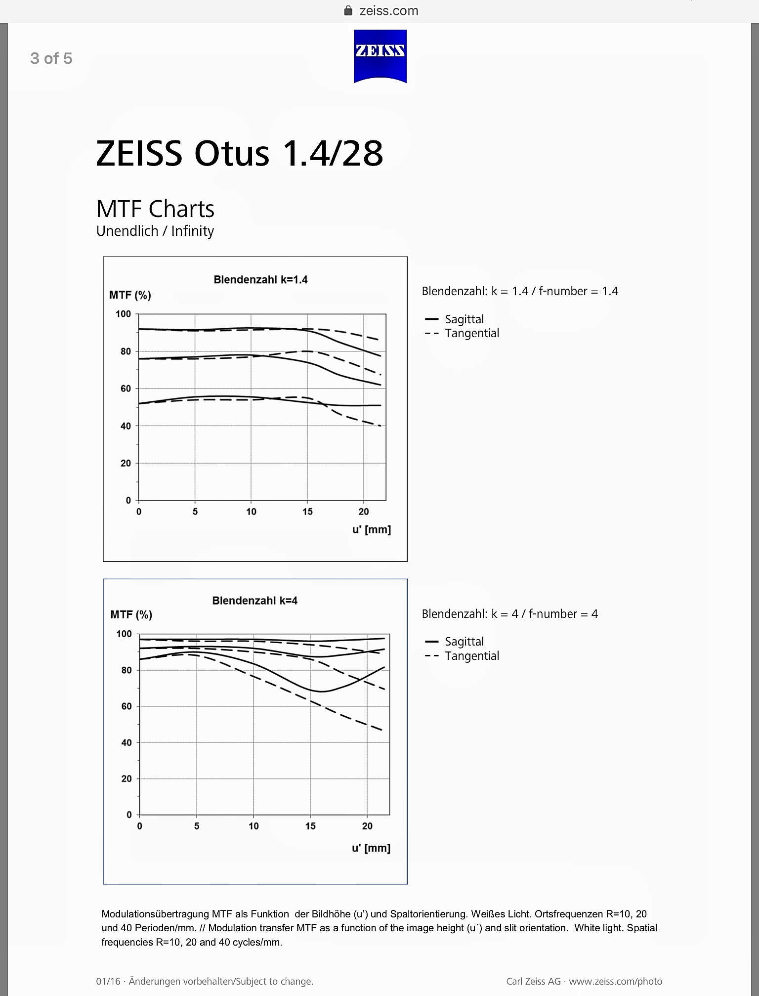

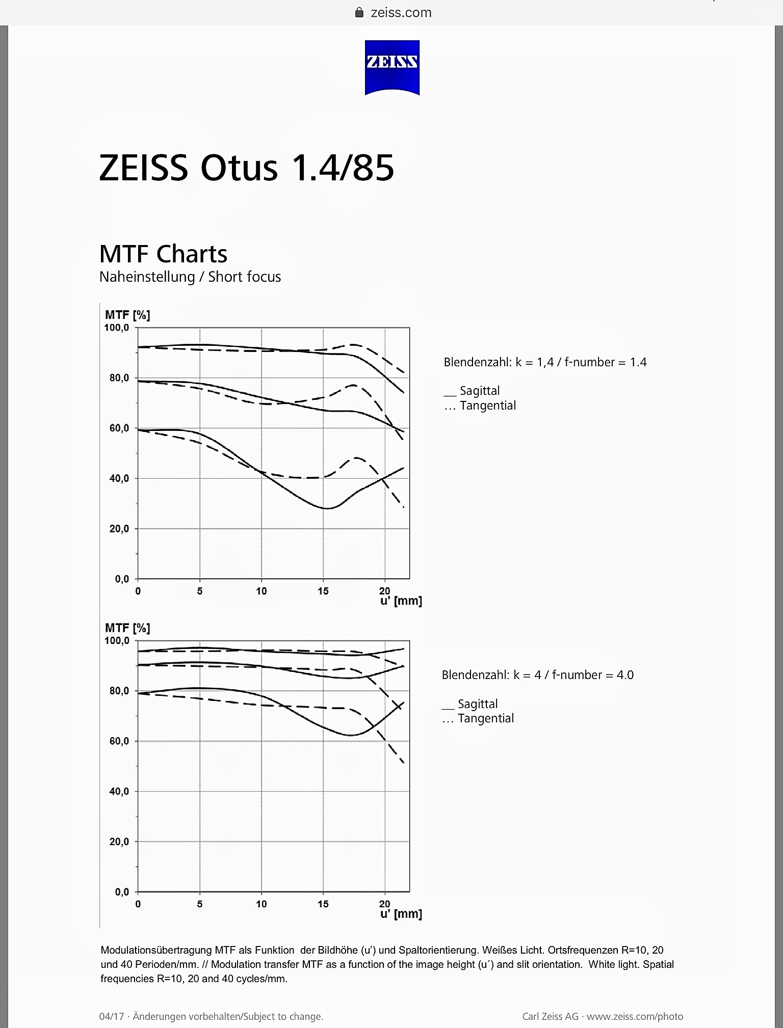

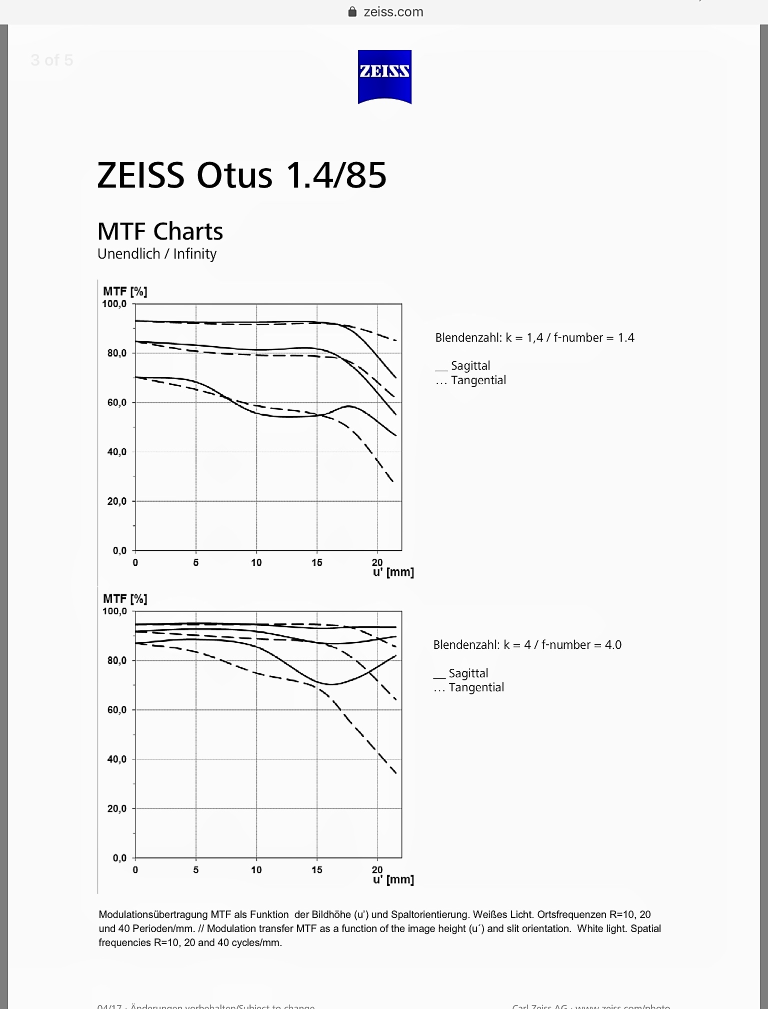

Zeiss Otus lenses(all MTF):

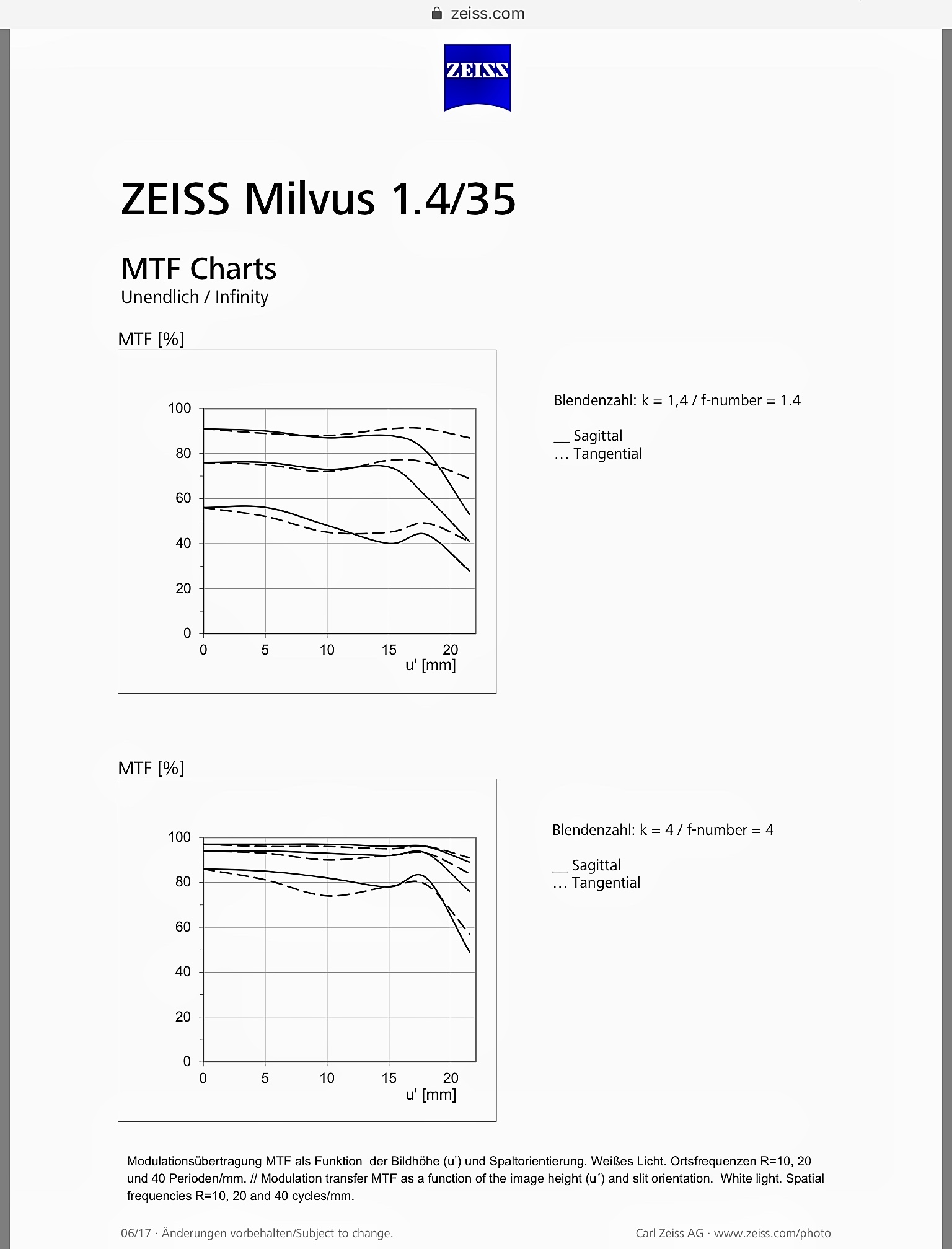

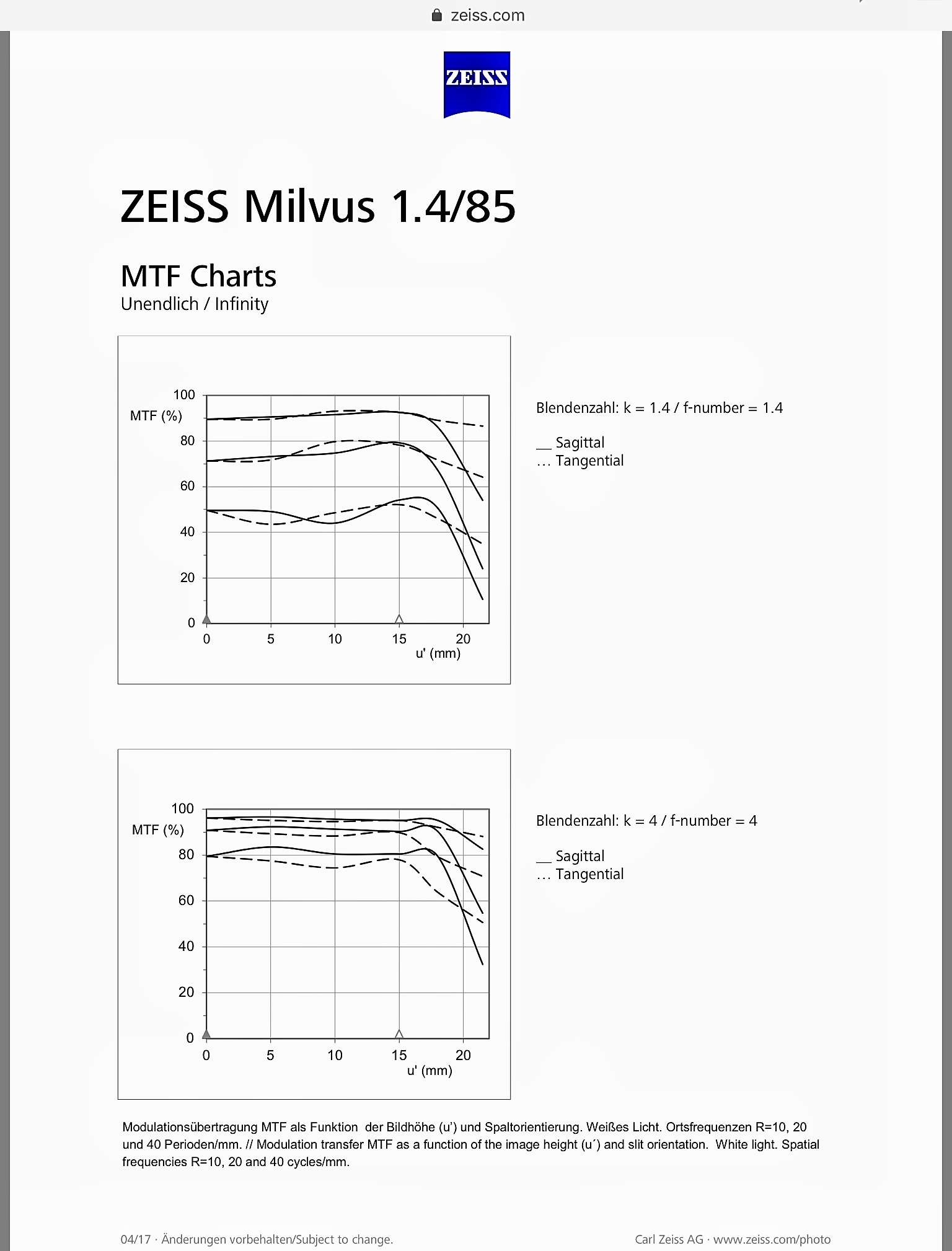

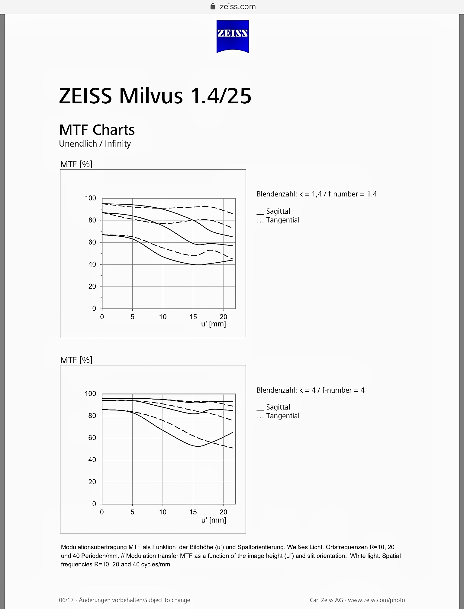

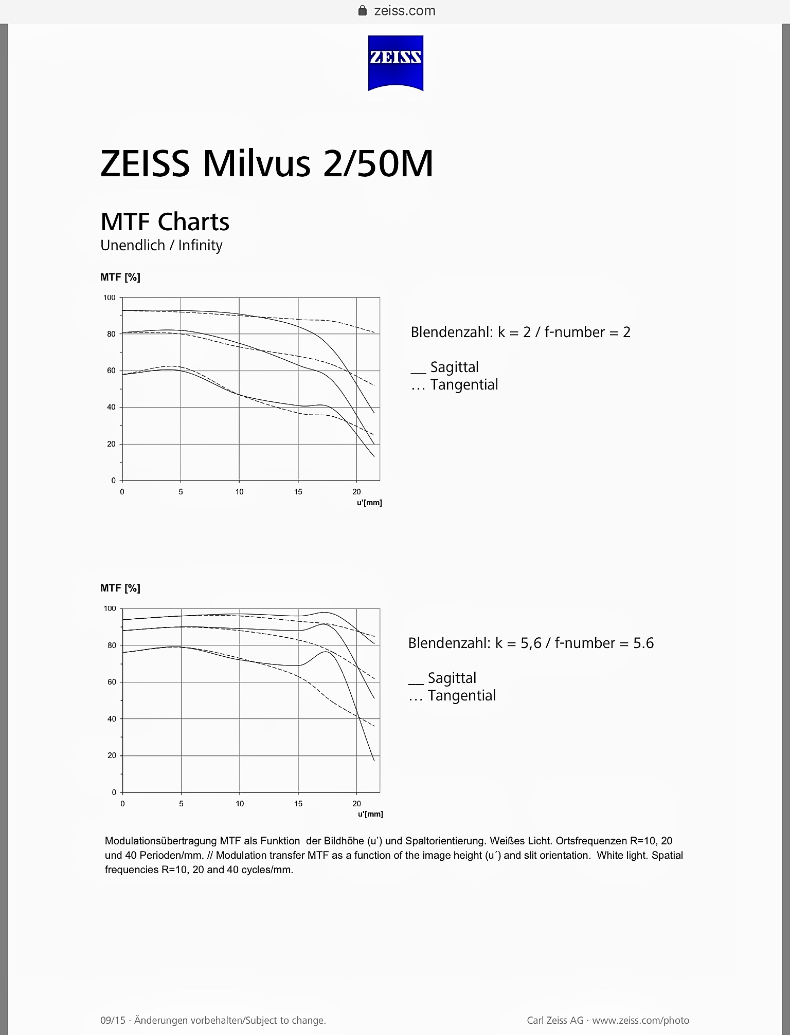

Zeiss Milvus lenses(some MTF best performers):
