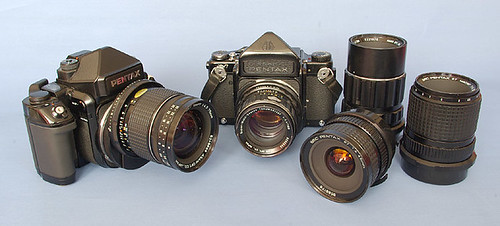

I bought a 6x7 'Mirror-up' outfit in 1981 -- I still have the receipt -- I got a 75mm f4.5 'Shift' lens very cheap as someone in the stockroom made a mistake so I got it for the price of the 'ordinary' 75mm f4.5 lens -- I did a lot of slide work with it for a company that wanted Architectural photos of commercial properties for an auction brochure -- then suddenly they went broke and I lost all that work. Many years later in about 2003 I got the opportunity to get a mint 6x7Mk II with 135mm f4 Macro-Takumar, Billingham bag, lots of huge filters all for £500-00 so I splashed out !! I got £35-00 back on the deal as I sold the Billingham bag at my Camera Club annual auction !
Pentax 6x7 by Peter Elgar, on Flickr
