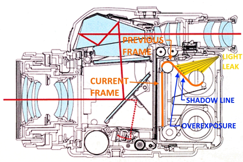

This problem came back with my 645N. I've figured it out now.
It’s not the shutter, it's a light leak where the back meets the body.
Light gets thru the gap and shines on the most recently shot frame, which is partially rolled up onto the top reel. The line is a shadow cast by the reel. See this diagram.
SOLUTION: New seals, or a new back, or black electrical tape to seal up your leaky gaps.
Awesome! I thought it must be from something like that.
Did you get new seals for it? Not sure how to go about doing that. Would hate to have to tape it up every time I change a roll.
I got another back, but you can buy pentax 645 light seals on ebay. They're foam strips that sit inside a slot.
