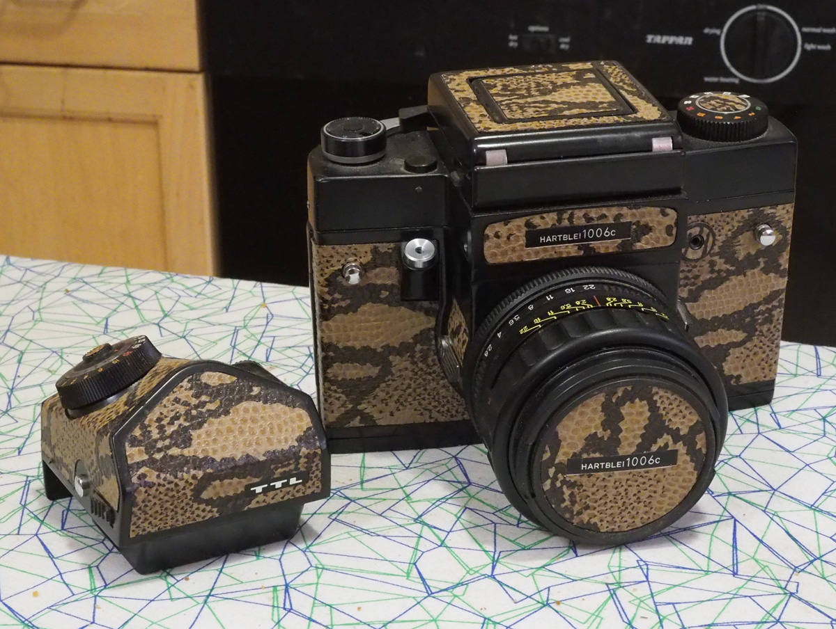

That's the coolest thing since the Leica R3 Safari.
Bad news for the snake, though.
Yes Stephe but I had a Kiev 60 covered with black and white cobra skin....... Cameraleather did that for me.

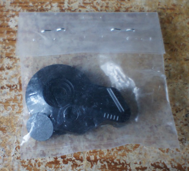

FS EX66 Advance Lever by Nokton48, on Flickr
EX66 Film Advance Lever, can be made to fit the P6. I got these from the Pentacon factory, they as a rule never sold any parts, only repairs at the time. They had one Gentlemen repairing/upgrading the P6's/EX66's, sadly he has passed. Now I understand Herr Peter Ohlbrich is picking up their repair work, he has done many good things for me in the past.
