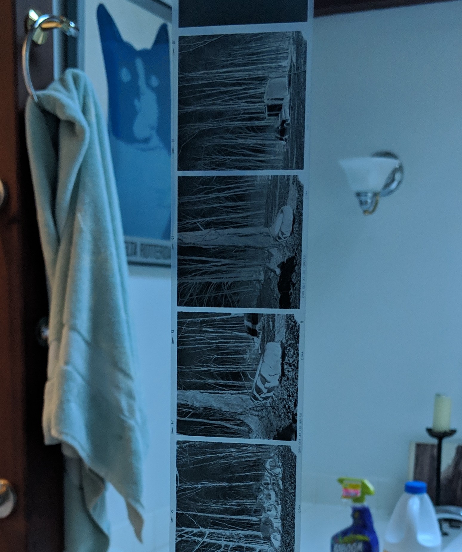

Well I'm happy to report that the Baier method of winding works!!!!
