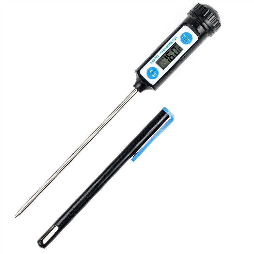

I started using electronic thermometers around 40 years ago when using industrial film processing equipment. They were so much easier and quicker and supposedly more accurate; but the cost was prohibitive.
In 1991 I bought a new manufacturing process for my business, which required very accurate temperature monitoring. To that end I picked up a $1,000 USD (or thereabouts) electronic thermometer with supposedly fantastic accuracy. It was certainly good enough for the job and by changing to a different probe, I also started using it for my photography. I was hooked on electronic thermometers.
Today I have a very cheap, reliable splash proof electronic thermometer for my photography. It is simple and is now what I use exclusively for photography, cost was around $20 AUD when I purchased it around 5-6 years ago.
This is very similar, if not identical to what I have.
