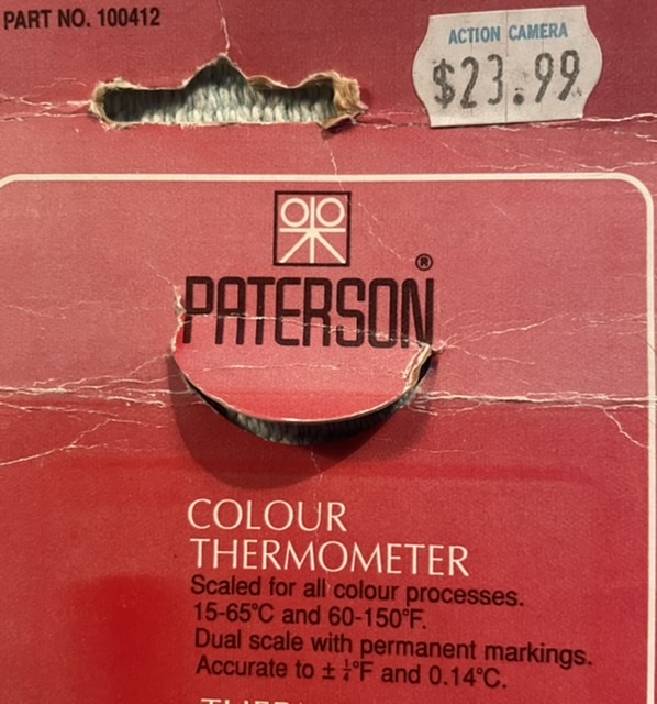

I have two of the Patterson Color Thermometers which are - according to the marketing copy - accurate to .12C. Sounds great, right? I put them both in the same solution at the same time and allow them to acclimate to the solution's temp and I get two readings that are off by .5C. Which one am I supposed to trust?
Are there any current offerings in the way of thermometers that can be trusted fully?

One cardinal rule of precision measurement is to never use two different instruments to measure the same thing. Using a third instrument doesn’t guarantee anything either. It just increases the odds of being closer to absolutely correct.
In this case, if one of them is at the high end of the stated accuracy and the other is at the low end they will differ by .48C which rounds to .5C so they could both be within spec. and be perfectly trustworthy.
I’m not sure there is a whole lot you can do unless you spend relatively big money on a calibrated/certified thermometer. I did that years ago because I needed (wanted is probably more accurate :smile:) one for non-photographic purposes, and I use that as a reference for the cheaper thermometers I actually use for photo stuff (several Patersons). They are all +/- a few 10ths of a degree C and that is plenty good for black and white photography. Color processing is more sensitive but I don’t know what level of accuracy is needed.
Correct me if I'm wrong but if they are supposed to be accurate to +/- .12C, then the max difference between the two thermometers should be .24C, no?
