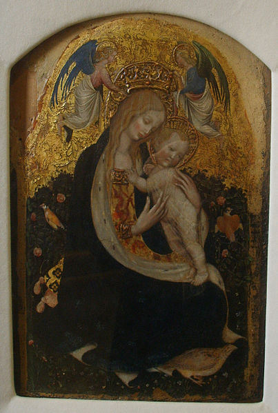

Madonna of the Quail by Pisanello
With the decline of the gold-ground style it became rarer within paintings, as opposed to frames, but was sometimes used for highlights, or a particular purpose. A famous portrait by Sandro Botticelli, who trained as a goldsmith, Portrait of a Man with a Medal of Cosimo the Elder (Uffizi, c. 1474), has the medal the subject is holding executed in gilded pastiglia, which apparently is an impression moulded from the original matrix for the metal medals, some of which survive.
