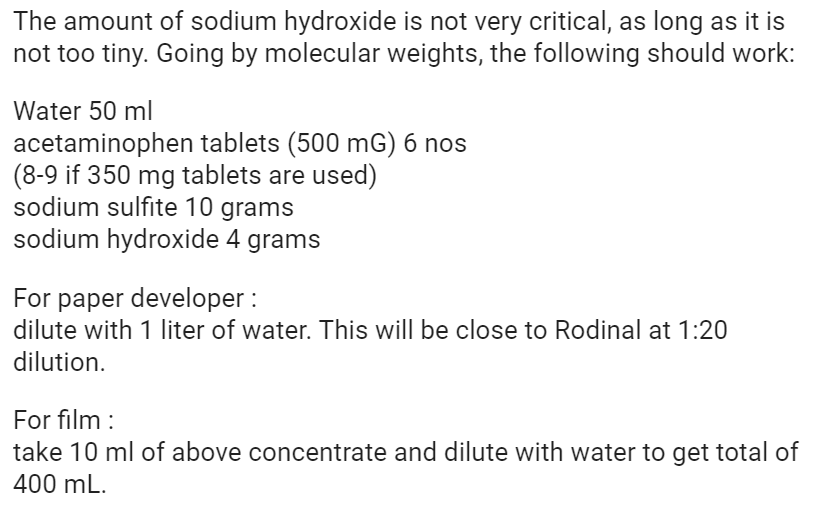

Would this depend on whether or not there is an excess of Sodium (or Potassium) Hydroxide in the concentrate? Rodinal clones like EZ-Rodinal use just enough Hydroxide needed to form Phenolates of p-aminophenol. PaRodinal, however, needs Hydroxide not only for Phenolate formation but also for deacetylation of Acetaminophen. Sreenath's original formulation suggested a specific amount of Hydroxide informed by molecular weights but didn't claim that it was optimal:

The Parodinal formula I used to use has the same proportions as the above cited "minimum" sodium hydroxide -- 15:50:20 acetaminophen, sulfite, and hydroxide.

The problem with all these Tylenol based developers is that they cannot be made accurately. Traditionally Rodinal is made by "titrating" the paaraminophenol by adding 50% potassium hydroxide solution to a slurry of paraminophenol and potassium bisulfite. As hydroxide is added the solid begins to dissolve. To prevent any excess of hydroxide you stop adding hydroxide just before all the pap dissolves. With all the insoluble tablet binder present you cannot do this. So all there various preparations have an excess of hydroxide which effects their stability and activity.

I think what Gerald Koch was getting at was that with an excess of hydroxide the pH will be higher and the solution more ionized so that if there is any air admitted it will react faster. That being so, PaRodinal would not last as long as Rodinal.
