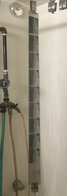

I made a 1+50 solution and developed a roll of “Fomapan 400″ , for 11 minutes at 20ºC. This is the standard time for Rodinal diluted in the same manner. No extension or compensation of any sort for any perceived weakening of the developer due to aging was made. The film was developed as if the concentrate was new.
This are what I got:
Dead Link Removed
Dead Link Removed
It is apparent that paRodinal also shares Rodinal's longevity. Only time will tell if paRodinal can still work after 40 years.

I tested a batch recently that was a couple of years old, and it worked perfectly.

Haven’t been shooting a lot of film these past 6 months, but ran a test roll of Adox CHS 100 ART (last roll from the freezer—exp. 2008) yesterday to check some recent camera repairs, and my paRodinal from December 2019 is holding up just fine, even with air in the plastic bottle where I keep it and the consistently warm Hawai’i weather.
