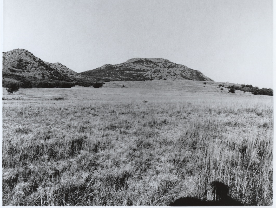

Negative: 8x10 Anthony & Scovill Champion Variation No. 3 - RD Gray Periscope No. 6 - f/90 Waterhouse stop - 2x Yellow filter for contrast control - 8 to 16 second exposure - Arista.Edu Ultra VC Glossy Paper
Print: 8x10 contact - Enlarger as light source - Arista.Edu Ultra VC Glossy Paper - Polycontrast filter (probably 3-3.5)
