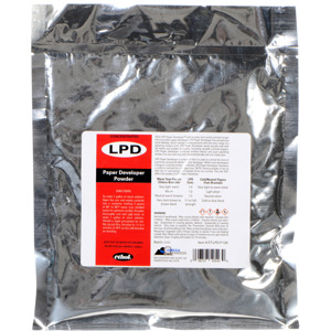

I am a long time user of Ethol LPD and the thing I like best about it is its versatility, making useful for both cold-tone and warm-tone papers. I mix the stock solution 1+3 and sometimes 1+4 for warm-tone. The stock solution last a very long time.
I hope they keep making it; Ethol's parent company has ceased production of a vast array of chemistry. I do have enough to keep me going a couple of years.
I have been looking to buy the powder version for nearly two years. It has been out of stock at all the online sources throughout that time. Even if it were in stock, B&H won't ship it.
Both Freestyle and Adorama currently have powder Ethol LPD in stock and are willing to ship. Freestyle is much more expensive:

Sal, I’m sure I’m not as meticulous as analyzing tones of these prints as you. I just shoot for tones that look good in many different lighting situations. I mainly try to get rid of any “green” tones as that is unpleasant to me. If it pushes slightly toward purple that’s not great either. I prefer developers that will push it toward blue black if anything in selenium. The previous MGIV FB went blue black with LPD as did the RC version as well. It seems the newer generation papers MGRC, Classic and Cooltone all want to run towards purple. I’ve had to change my selenium dilution to 1:19 for less time and I feel now I’m not getting protection. I quit using LPD as the last two packs I got from freestyle both mixed up quite brown and never had that issue in the past. And now at $24 a bag it’s too expensive to take a chance. I’m planning to start mixing my own PQ developer, the ID-62 formula and start messing around with adding PMT and trying to get longer selenium times with a shift toward blue black if anything. I can achieve it on classic with SE6, but that stuff is super expensive!
