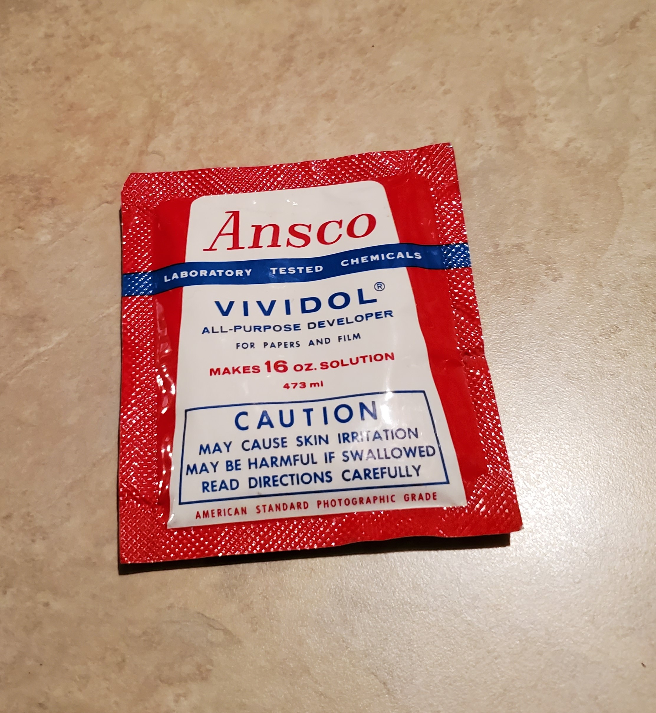

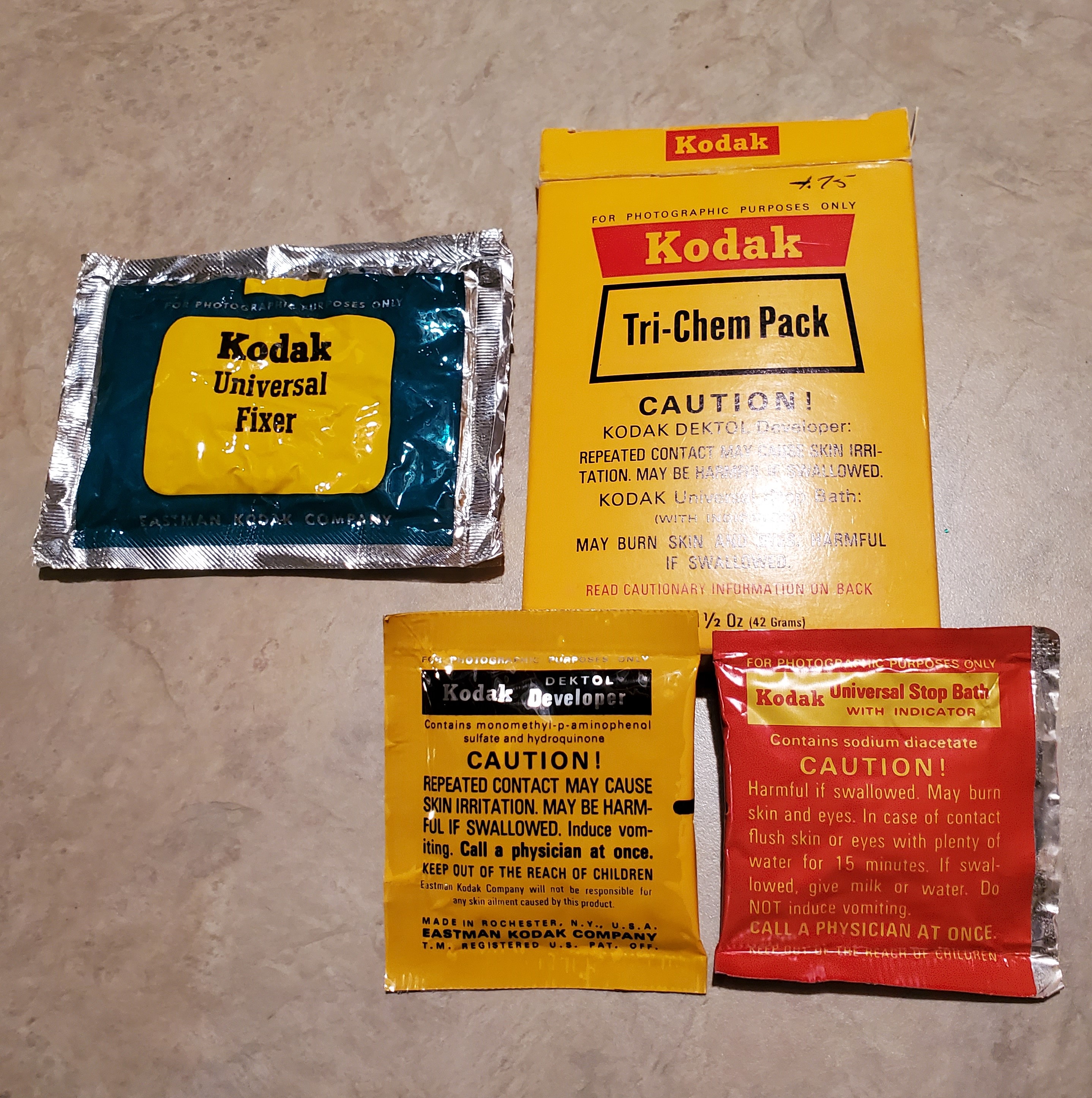

I started with an Ansco Developing Kit complete with tank, trays, contact printer and chemicals. Ansco supplied their Vividol developer with the kit but the local camera store had mostly Kodak chemical.
